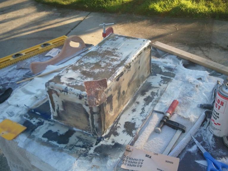

Working on fairing the outside now. Knocked down the putty I spread over the outside and just went over it with some thickened resin.
Being able to make my own custom parts is going to be addictive. I already have a list of projects I want to do.

I have been working on fairing the outside for the last two days.

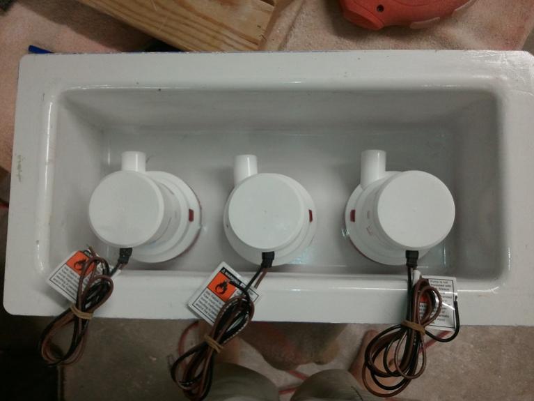

Got done trimming up the flange and put a radius on the corners. Also snapped a picture with the pumps just sitting in the box.
The wires will exit the rear and be sealed by blue sea cable grommets.
I am going to try the method Dave mentioned for fastening the pumps to the floor of the box.
After doing some reading on west system's website I was thinking of using thickened epoxy to seal everything up. Thought this might bond everything together well but would also be paintable so I could fillet the amount that squeezed out and make it look like there was no joint.

You might want to bed that in something more pliable and less permanent than cabosil thickened resin. Its going to be a prototype. You never know if you might need to make some changes, and thickened resin is brittle and will crack over time if there is any flexing.
Part looks good. Nothing more rewarding than an idea go from your mind to your hands.
