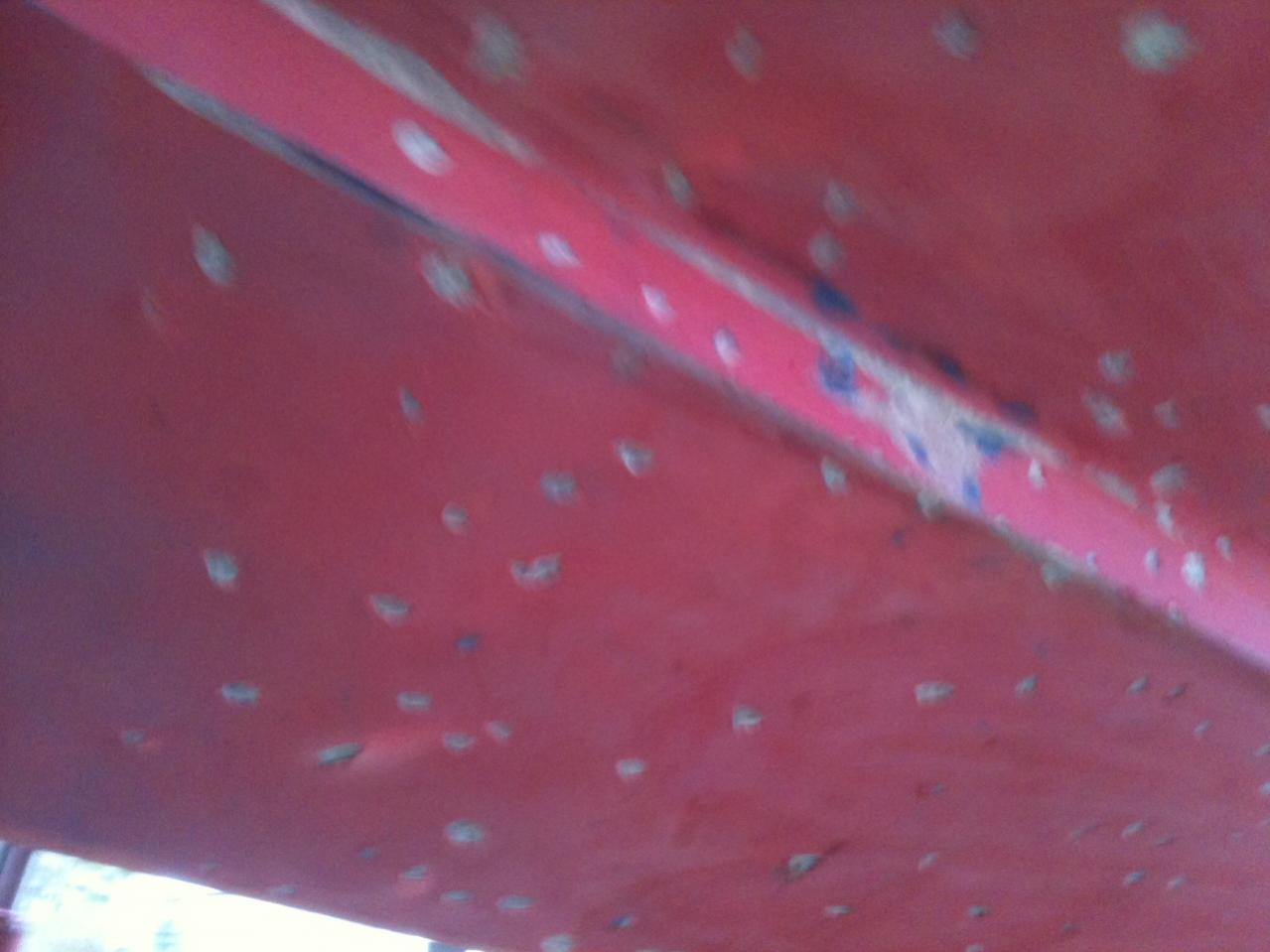

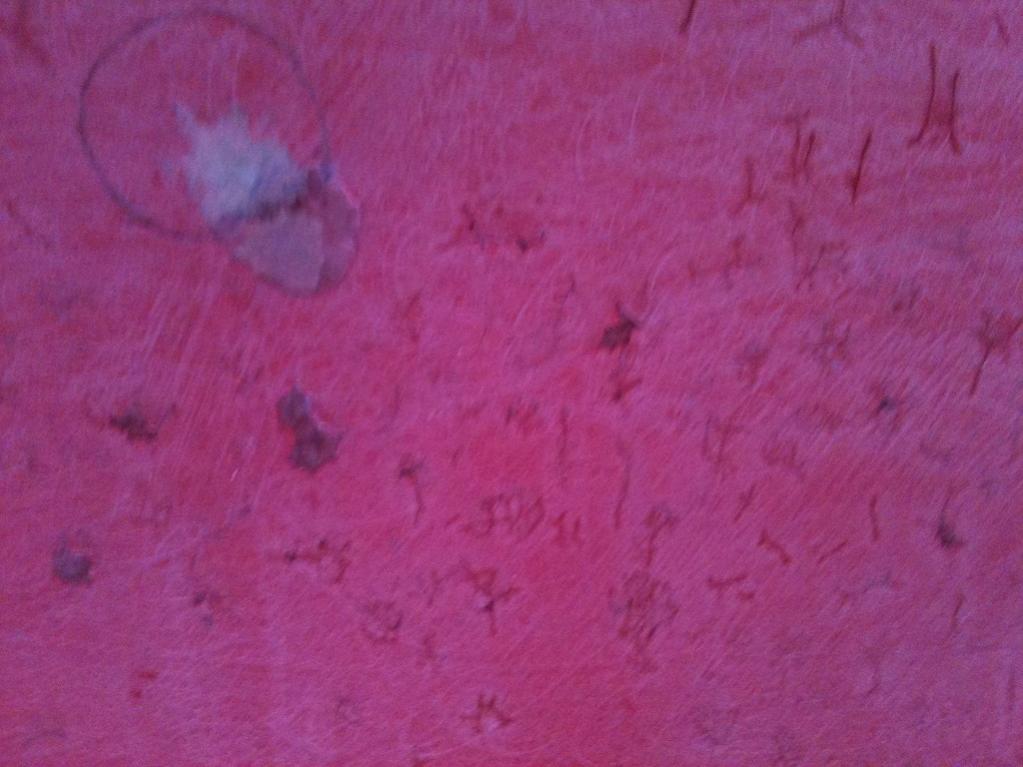

I picked up a 1972 23 cc last august. best cc i've ever owned, no need for my 23 contender anymore. Because i want this to be my last cc for a very long time i decided to barrier coat the bottom as my first project. I just about have the bottom stripped 95% done. What i've encountered is hundreds of blisters in various shapes and sizes. Can someone offer advice as to, do all blisters have to be ground out, some of them are small and seem to be more of a crack. i've got some pictures for viewing pleasure,grinding the bottom was NO pleasure. Any help would be greatly appreciated .Also what tools work the best for grinding out the blisters, when i used my grinder i found i was taking more bottom then blister. Thanks again

I had the jell coat peeled off the bottom then sanded smooth then I applied about 10 - 15 coats of vinyl ester resin enough to bring the hull back to full thickness then primed and bottom painted. That has lasted 10 years and no blisters hope this helps

Thanks fredetzel for your advice. I had so many, that i wanted to make sure this didn't happen again. I spent a couple hours with a dremel opening the holes and removing cracked and fragile gel coat. I felt more like a dentist drilling out cavities . I'll most likely have to apply two filling due to some being pretty deep. Anyone have advice on the best filler. Going to let the hull dry out for at least a week. Heading to costa rica tomorrow for a little R&R . When i get back it's fill and barrier coat and move on to phase 2 Pilot house

skin the bottom layer like fred said , that is the only way to do it, i have heard of people using a tool like a planer.

Check out page 3 of my rebuild post about 1/3 of the way down. It explains what I did.
I would use an epoxy fairing compound like systems 3, then I would put a barrier coat over the entire bottom hull...like Petit Protect.
If the area around all the holes are solid I do not think you need to peel your entire hull.
