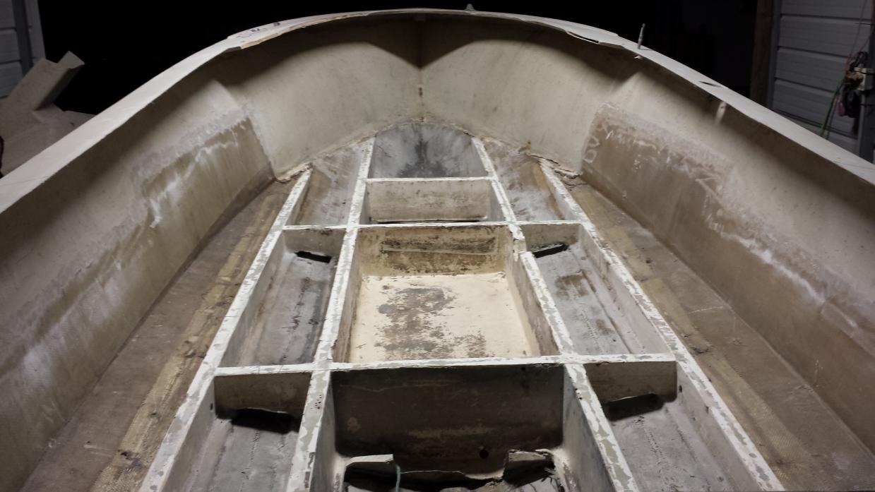

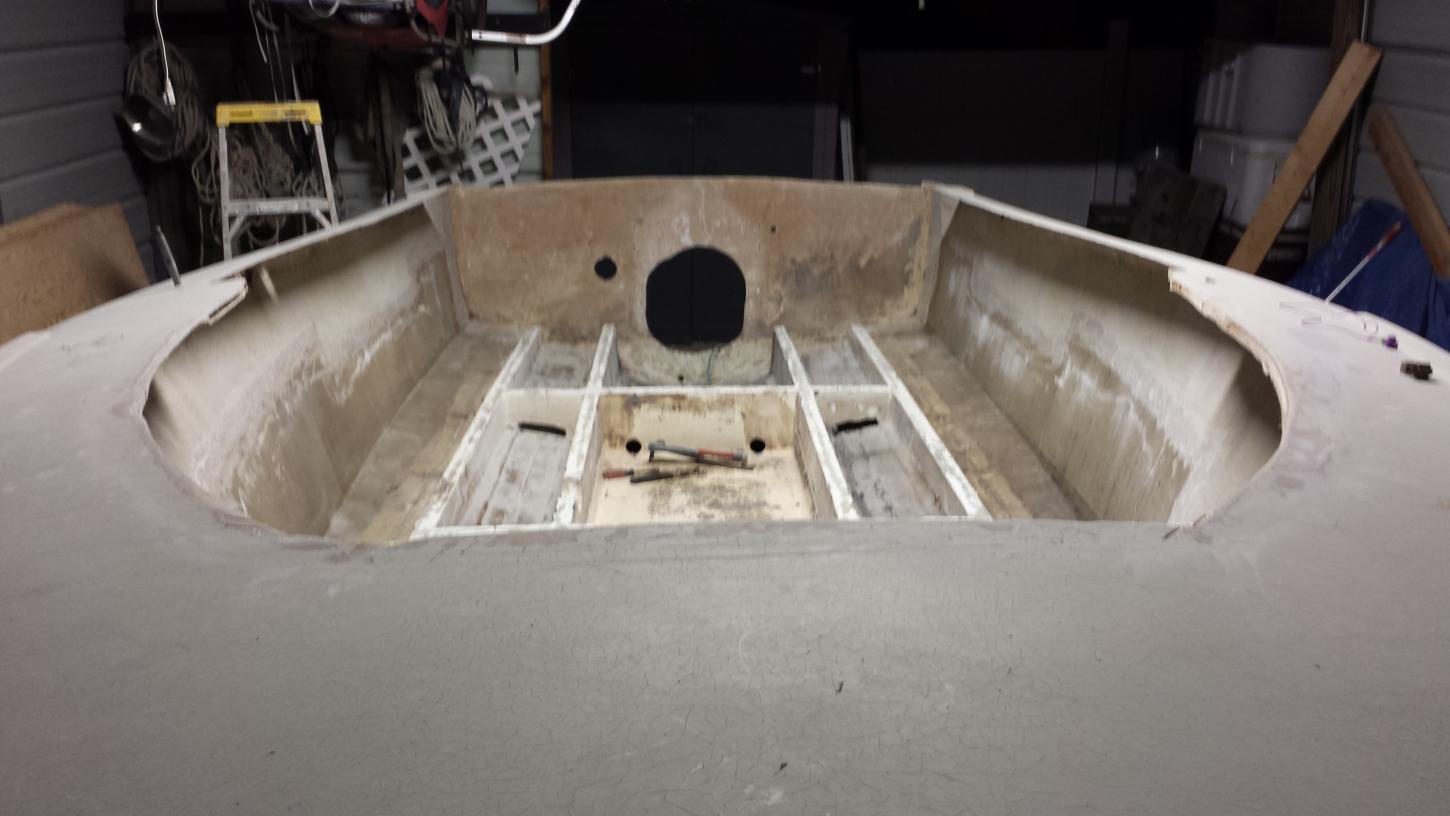

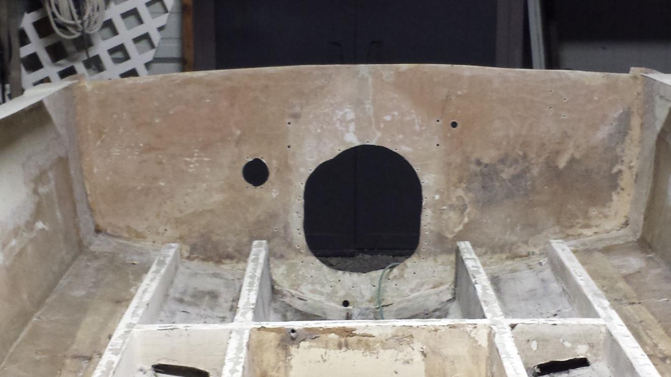

All I know is the putty they used back then was tough as nails. Used the grinder to sand down the sides where the liner was attached and the top of the stringers. Got the transom all sanded down and is ready for the wood to be glassed in hopefully sometime this week.
After glassing transom gonna take boat and blast the whole inside of it to save me a bunch of sanding. Then bring it home flip it over and start working on the bottom.

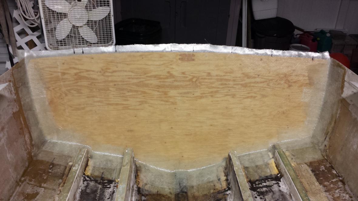

Transom glassed in

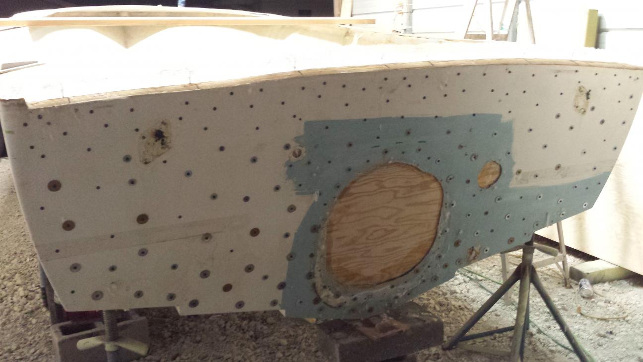

Hey, someone did a heck of a job getting that old transom out!
