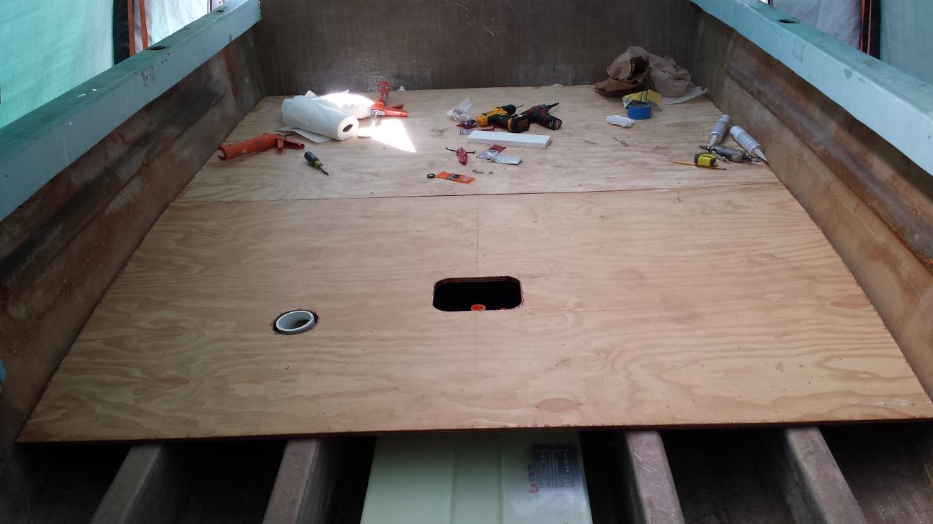

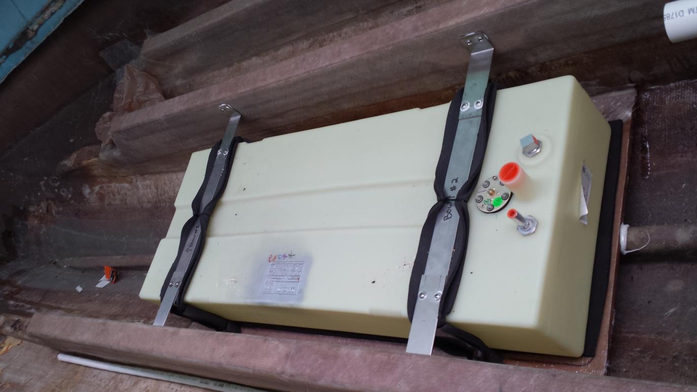

It's been a while so I figured Id post some updates. I did go with a plastic tank and did NOT foam it in, per Moeller's instructions. They said that foaming it in would not allow for expansion and would void the warranty. This tank had 8 screw bosses in the top that I used to secure the tank with in addition to some stainless straps that I had made by a friend. I left a .5" gap all around and used neoprene foam in between the straps and tank and also a .5" pad underneath it. It's quite secure.
I'm a little farther along than I have pictures of. When I put it to bed for winter I had glassed in all of the deck. I used 2 layers of some 24oz cloth I got for cheap. It looks just like 1708 but MUCH thicker. All vinyl ester resin. The underside of the deck has one layer of this cloth on it.
To secure the deck to the stringers I used a billion tubes of 5200 and stainless deck screws. Once the deck was secure I hole sawed some small holes and poured foam into the two outer stringer bays and portions of the inner ones. The outer bays will be SEALED with no protrusions (screws, etc) so there should be no chance of water intrusion to the foam. In the inner bays, since water intrusion is possible, I covered a piece of 3/4" pex tube in mold release before I poured in the foam and pulled it out after to leave a channel at the lowest point so hopefully gravity will help me out if water does seep in.
By pouring the foam in after the deck is in, it is able to completely fill the cavity and also gives extra adhesion of the whole assembly. Anyone who has tried to pull foamed parts apart will understand. I did this on my other boat and it worked great. You just have to be sure not to do too much at once or there is a real risk of popping the deck from the pressure.
Once the foam was in I then did my two layers of glass over the entire thing, sealing the foam holes and all the screws. I feel bad for whoever tries to get this deck off some day.
