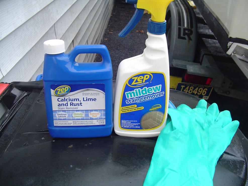

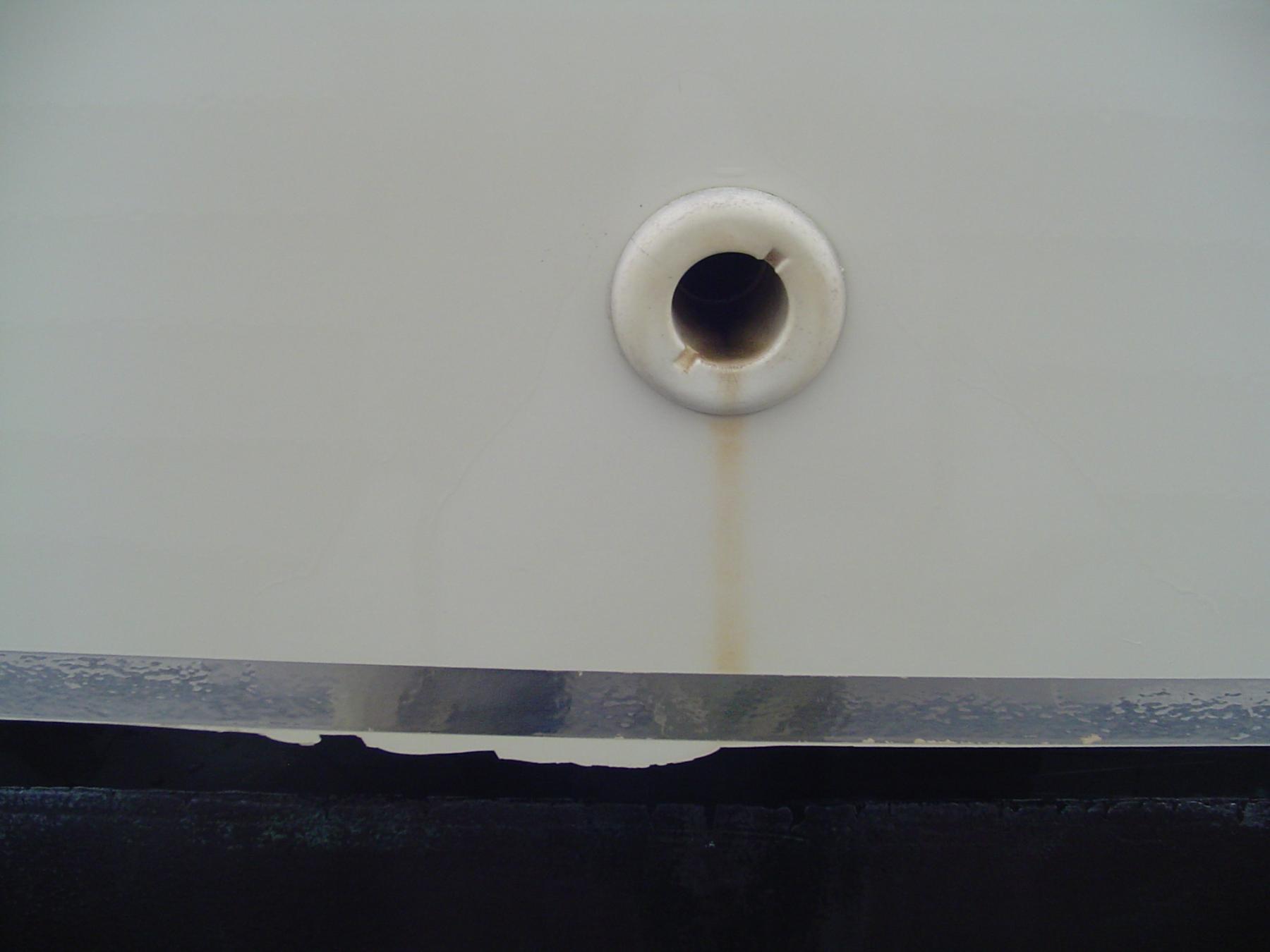

I have 5 stains that I have tried the 2 cleaners on, with scrub pad & stiff brush. One stain lifted well, the other 5 are a PIMA! Anyone know how I can remove them before I apply the floor sealer to get her shine back?

FSR by Davis will work well on stains like that. It's basically oxalic acid in gel form. Brush it on, leave it for a few minutes, remove with water and a sponge or brush.

Some stains can get so deep in the gelcoat that you have to sand them out, and sometimes that may not even work..

If you believe it is an iron based stain (rust stain), go with Iron-Out. Get it in your grocery store or Home Depot.
Also, You might try white vinegar first, rinsed and then go at it with baking soda.
