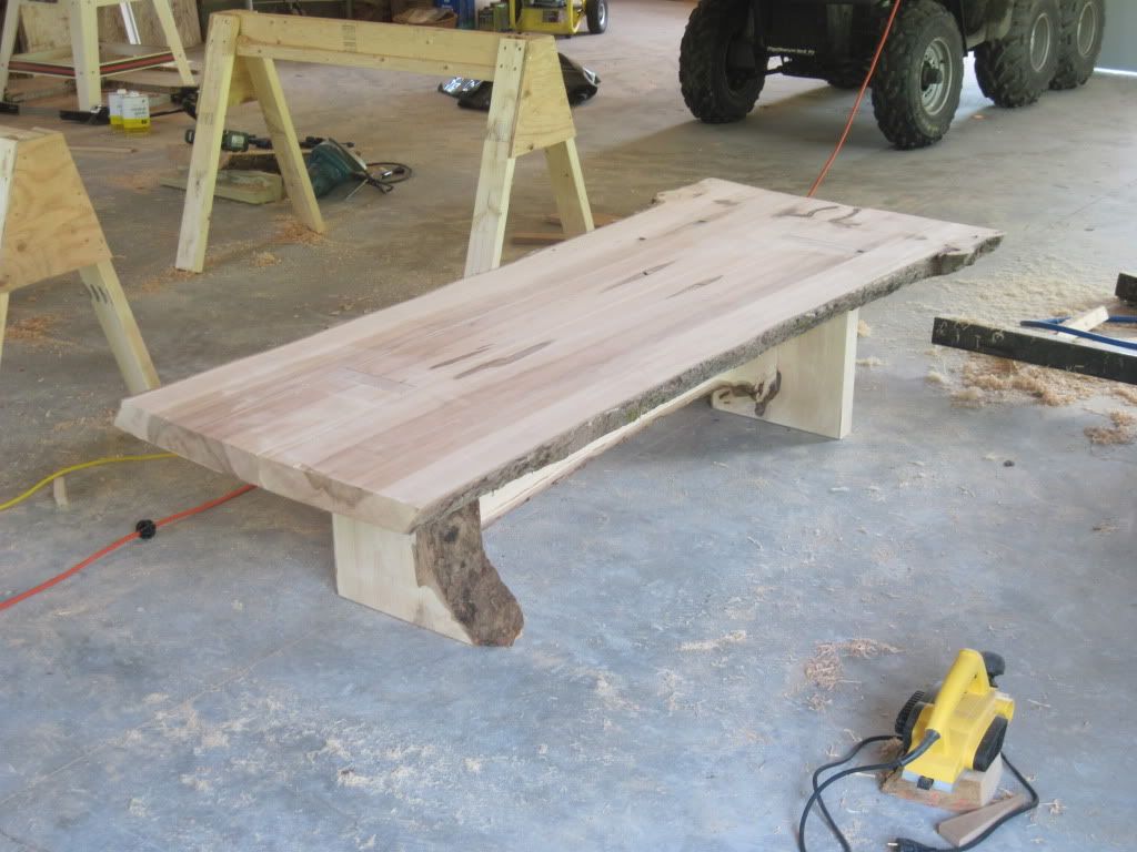

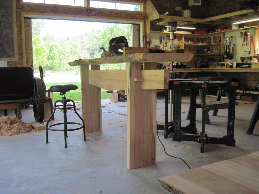

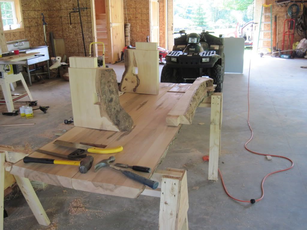

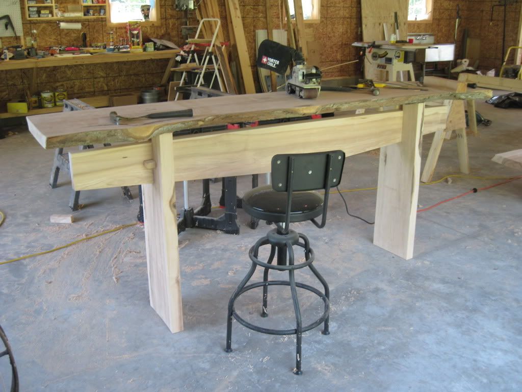

We spent some time running around on their four wheelers, and to make sure we didn't get bored, my sister put my brother George and I to work making her some furniture. They had taken a maple tree that came down last year and had it sawed into slabs 2 1/2" thick. She wanted George (he's the cabinet maker in the family) to make her a bar top with one of the slabs. I started out to help him with the bar, but there were a couple other slabs that were just begging to become a coffee table. Both pieces are constructed with mortise and tenon joinery.
George's Bar:
My coffee table.
The pieces:
And assembled:
