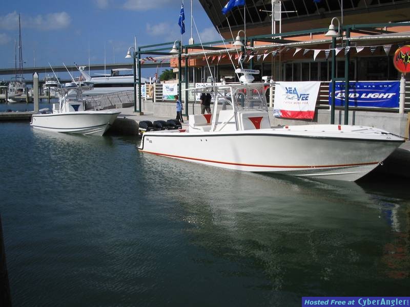

Ya you got it right your 25‘ boat is a intergraded transom design also called a unibracket which is all a part of the hull fiberglass lay up process. There as been some discussions and interest in incorporating this process as a Add On design change when re doing a transom. I personally like the idea but see that it could be a lot of work to get it right.
Here are some pictures of my favorite intergraded transom boat the 31 SeeVee
http://www.cyberangler.com/photos/wa...ee-6-15_03.jpg
http://www.cyberangler.com/photos/wa...ee-6-22_01.jpg
http://www.cyberangler.com/photos/wa...ee-6-23_01.jpg
http://www.cyberangler.com/photos/wa...2004-06-23.jpg
FellowShip [img]/images/graemlins/grin.gif[/img]

Thanks fellowship, that was the kind of info/pictures I was looking for.
