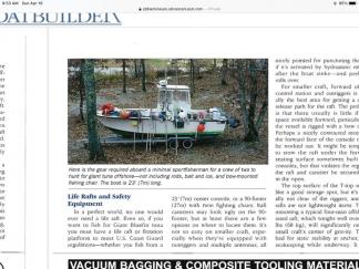

The hull came with a binder full of women I mean old receipts. All kinds of offshore stuff (Lee's holders, Penn 30W's, Jamestown Distritbutors from when they were actaully on Jamestown Island), so I did some googling and discovered that the former owner has written some pretty good small boat articles, I decided to get in touch.
Turns out he's a great guy! Has a Seacraft20, lots of other Seacrafts over the years. And he used to tunafish 'Chaser', even featured her in an article on how to layout sportfishing boats: https://pbbackissues.advanced-pub.com
- "78 - Aug-Sep 2002" page 56. (Chaser is on page 78, screen shot below)
I haven't finished anything yet, so no photos of the build but hopefully soon.

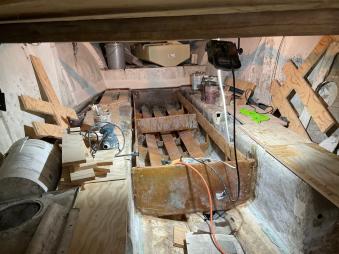

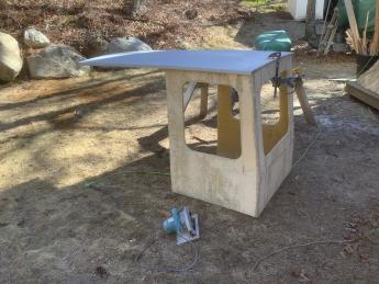

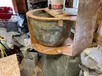

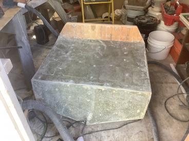

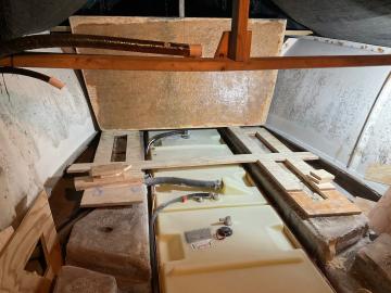

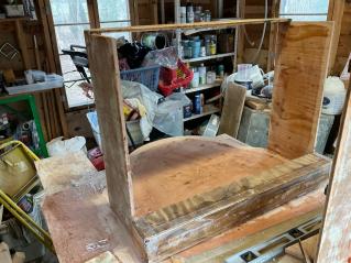

Progress! Bracket is out of the mold, console components I got from CMP (almost 10 years ago!) seem to fit my vision of a doghouse, both tanks ins, molded a livewell, and stuck the livewell into the leaning post. Now need to finish the transom, decks, and mount everything. What I have learned:
- Vinylester is better than poly, but stinks to high hell.
- Vinegar actually works pretty well for epoxy/VE clean up.
- I should not be allowed to mold and lay up things: I used a pile of tires for livewell mold, then spent 5 weeks engineering a way to keep this 700 lb 'water cannonball' from rolling around the deck...
So of course I bought an 8 ft crowder 130 UL to go with my brand new tuna harpoon I bought last summer, as well as a GO12 with Halo20+... because projects needs porn I mean motivation. I am not looking forward to sanding/faring that much surface area, it's like mowing an airport.
