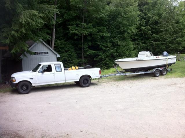

I have to say that with a older tow vehicle- a mid 90's F250 diesel, the long wheelbase makes for GREAT highway towing. It can be a problem backing into tight spots with a 21 foot truck and a boat and trailer that is ~25 feet. But the performance under tow is great. It just goes straight down the road. One down-side to a long wheelbase 2WD is that you need to have some weight over the rear axle for good boat ramp performance. But 500-1000lb of concrete works nicely. I found that people will "donate" bags of quickcrete that got damp and turned into a 50 or 80lb pig weight. Then they are easy to unload and work great for getting traction.
