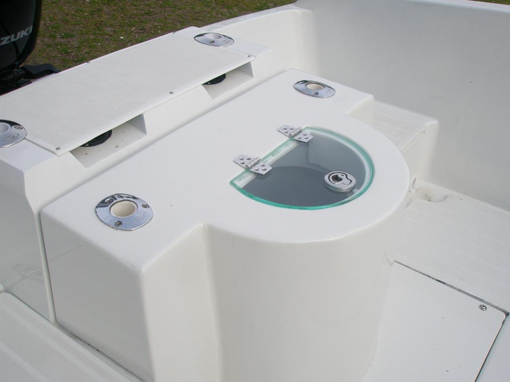

What will you be doing with the lip around the deck for the old engine hatch? Cutting it out and filling it in? I left the vents in place and was still able to get two rod holders on each side. In your case you could put one in the middle as well and then you would have three back there. With the ventilation my bilge stays clean and dry. There will be mildew unless you provide some sort of ventilation....and it spreads fast. If you are going to put some pop up cleats back there now is the time to do the cut outs for them while you have the back tore off. I had a hard time getting my arm up under there installing mine. What kind of paint are you going with? Dark colors look great but are a pain to apply and make look good. Looking great so far and your moving right along.

Far as the lip I am undecided on whether or not to cut it out or to just enclose the top of it and use it as a mounting platform for a reverse fishing chair. I got one piece of foam left large enough to core a blank for the top of it. Far as the vents goes, to late on that one. If I read this first I might of left them in there but now that thier gone I might add them back on the sides of the same section. I was planning on adding 4-5 rod holders like you have on yours but plan on running them all the way across the top. I was going to make this area in to a storage box but then I am adding weight back there again so I scratched that Idea and decided to do the rod holders instead. Thanks for the heads up on the cleats! I will do that, It should save me the trouble mounting them after the fact. Far as the paint I have been using all inturlux products so far and plan on using the 2 part polyurethane perfection line for my final coat. Color? I was fighting lady yellow then seafoam green then light blue but after I saw the pictures of the one you posted the other day I think I am back to the Yellow but want a bright sporty yellow like the one in your pic. Not really sure but need to decide soon. Thanks for the intell, you and your post have been a big help!!!
