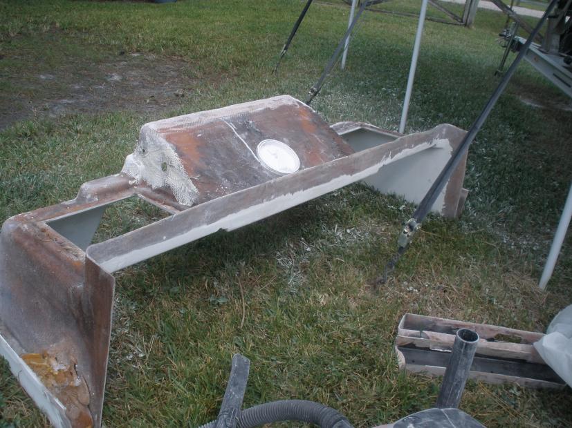

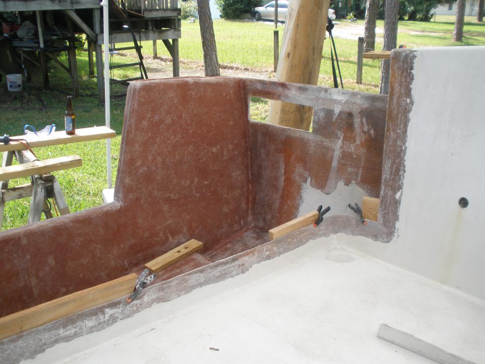

Been out of commission for a few weeks, and I'm getting back around to finishing this repair. I added more tabbing to the stringers, and laid a final full sheet of 1708 to finish off the inner laminate. Now I've ground back the butt joints about 3" on each side of the joint, preparing to butt join the cap back on. The picture shows where I plan to place butt blocks. After taking the picture I decided I would use a long 68" x 6" wide block along the bottom, 21"x6" along each side, and the two a block under each rail at the top. I plan to resin coat the wood, and add a layer of matt to seal it in the bilge area. Anyone see flaws in this plan, or got advice on the best way to get the cap back on?
Old 11-02-2013, 08:46 PM
Looking good. I didn't grind my edges back far enough the first time around. Members up here corrected me on that. 3 inches both side is what I was told. That would be enough but nothing less. I clamped mine in place with wood blocks then glassed what I could then moved the blocks then did the rest under it. I would think the blocks of wood would work for lining it up but once I got the front glassed I would remove them then glass the back side. I defiantly would not leave the wood blocks in the boat. It will be hard and messy to do the back side but that is where I built up most of my thickness. I got the liner twice as thick on the back side. I will try to post some up dates on my sceptre rebuild thread.

FF- Thanks for the quick reply. Great idea to build up on the back side. It'll be a pain initially, but it will be strong, and no fairing!
