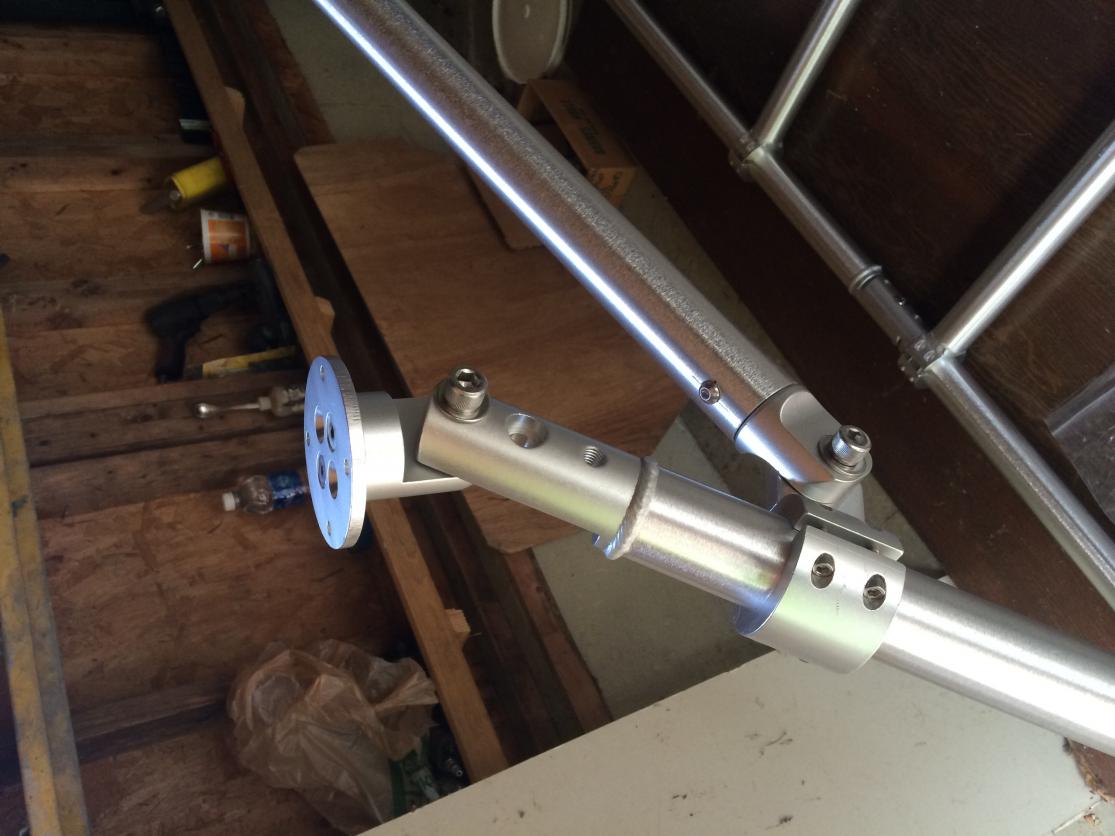

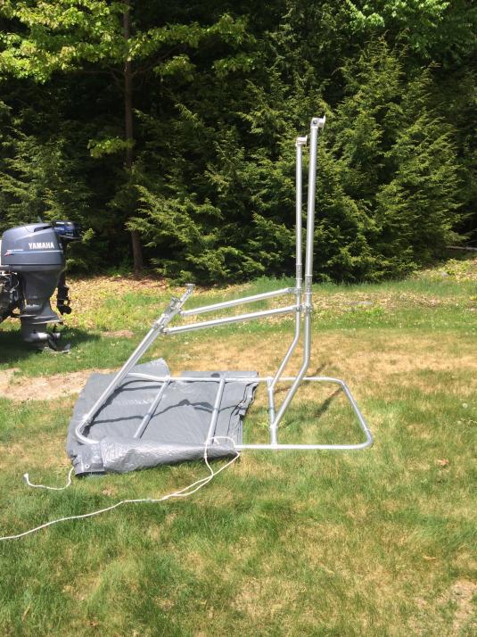

I have mostly assembled it. The fit isn't perfect but not bad. I will modify it pretty heavily to fit a 38" wide console in a master angler.

Getting there. I am a ways off script. I cut the forward legs and used them for the side bars. I need to trim the mid leg pivot so it more closely fits the forward mount. A basic hack saw job.
Old 05-22-2015, 01:00 PM
Location: Greater Boston
Posts: 1,117
Another pic. Can't seem to add two at once from the phone.
Old 05-23-2015, 05:50 PM
Posts: 1,117
I reversed the uprights for less of a phone booth look. Still needs adjustment but getting closer.

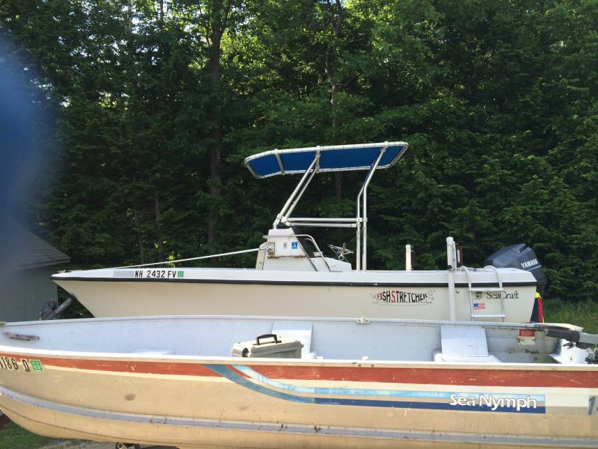

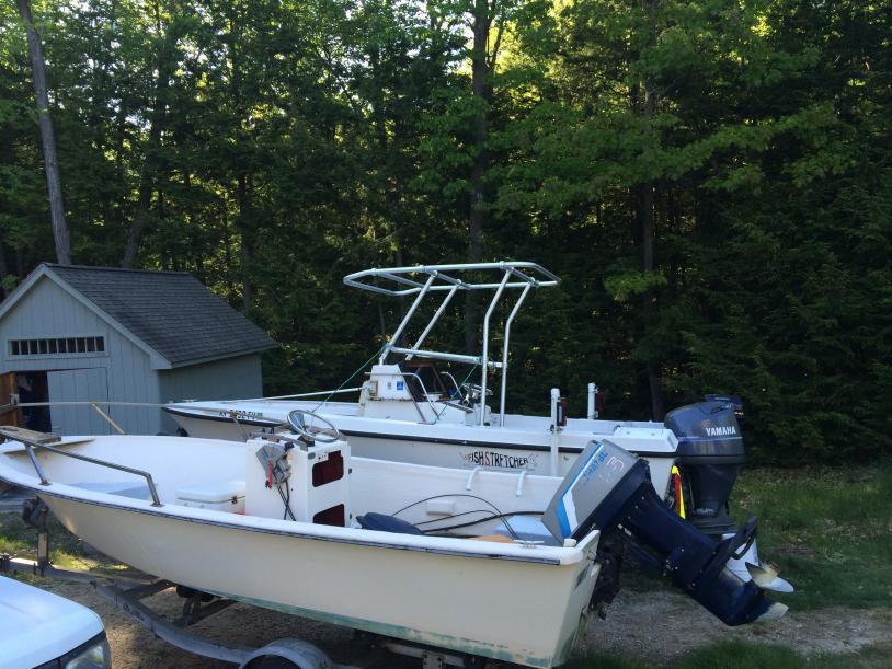

Old 06-13-2015, 05:49 PM
Posts: 1,117
It is attached. Still a few standoffs to mount, but I laced the t top today.
Old 07-08-2015, 10:19 PM
Posts: 1,117
So I have been using it for a few days. I suspect it isn't as awesome as a custom welded unit that braces against the side of the console, but everyone remarks on how rugged it looks, and it doesn't feel bad. The top itself is a bit small for a console this effin' huge, and I hit my head on it when I step into the boat over the master angler cap, but I am about 6'1". I should learn soon.
But honestly, I LOVE having a T-Top. Best improvement ever, It doubles my endurance on the water. I am so much more comfortable this way. I might slide the top sternward 4-6". And using rod holders up high means you need to be tall and/ or use a stool. But it's great. Plus I got 10 tries to get it fit just how I like. Which is a plus or a minus depending on how OCD you are. Probably a plus for me...
If a local guy can weld and anodize one for $1200, I say go for it. Otherwise, these aren't bad on a 20MA, and probably a lot better on a smaller console 20.
Edit2:
This took a knot off the cruise, and 1.5 kts off top speed. And the additional mass means I really need to think about a lighter splashwell gate and recoring th fuel tank hatch, if not redoing the transom.
