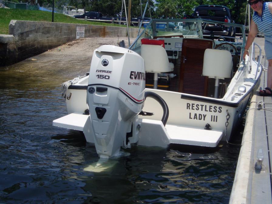

Regarding shallow ramps, the NPB Village Ramp pictured below which is close to me and the one I use most, has two different slopes. If tide is very high, trailer will be on shallow part of ramp but I've never had a problem launching there with the roller trailer at high tide, although the boat won't just roll off trailer when I release winch brake like it usually does . . . have to pull out winch cable by hand and push boat back a couple feet until CG gets to aft cross member with the big racks of 16 rollers. At that point, the rear cross member then rotates, and I have to use winch brake to keep it from coming off trailer too fast!
I had a bunk trailer with my first boat, and at extremely high tide at that ramp, I could not get it deep enough to float the boat off, even with wheels of the car in water!
