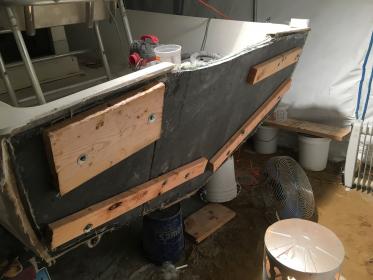

The local fiberglass supply had Penske so I went with the Penske board 2 at 3/4. I cut the lip out completely as I already had to wrap around anyway and went with existing inner skin laminated to 1.5 oz, 1708, 1708, 1.5 0z, 3/4 Penske, 1.5oz, 3/4 penske. I have decent access to the inside of the transom right now through the fish boxes, I may tab in some 1708 on the inside as well or even get rid of the boxes all together to work more on the inside still haven’t decided yet.
This weekend I’m going to fair the outside up the hull sides and was thinking of this laminate schedule for the outer skin and looking for thoughts
Outside layer of Penske board —>1.5oz, 1708,1708,1708,1708,6oz cloth wrapped to the hull sides.
I already started fairing the bottom of the hull to accept new glass, what a PITA I don’t recommend going this route haha!
The enclosure I built is small so backing up to take pictures to see the whole thing at this point is impossible
