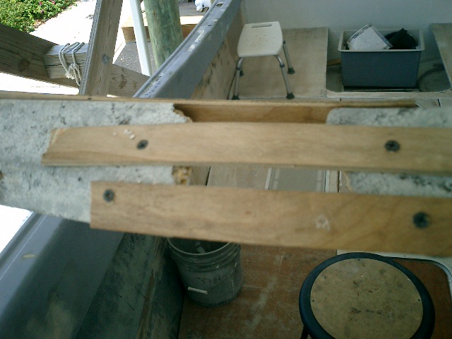

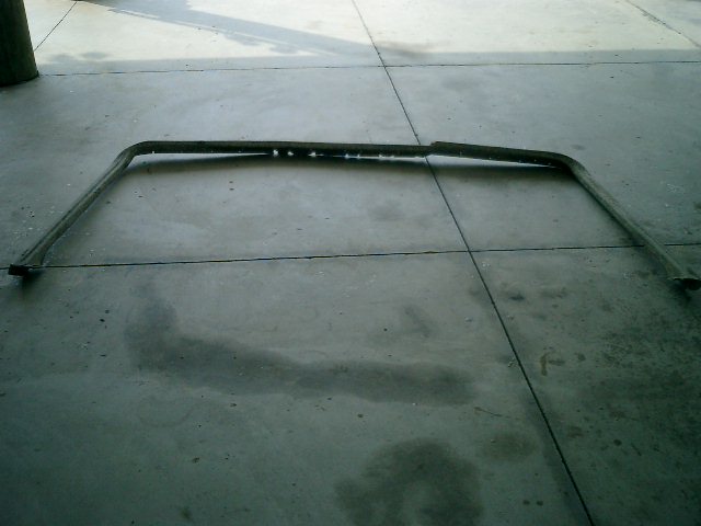

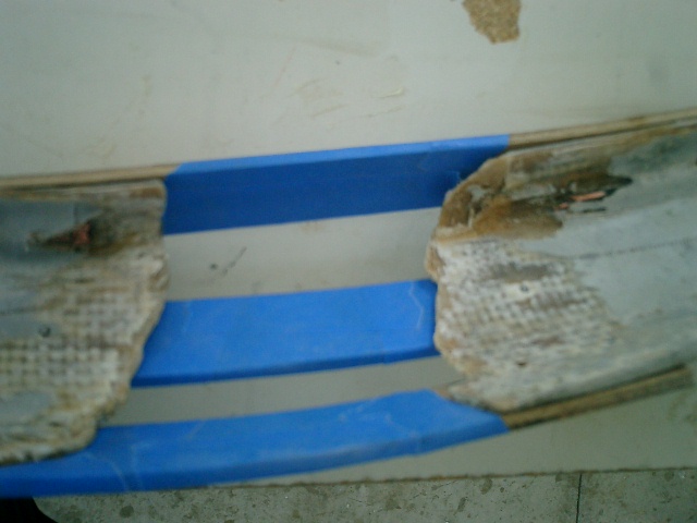

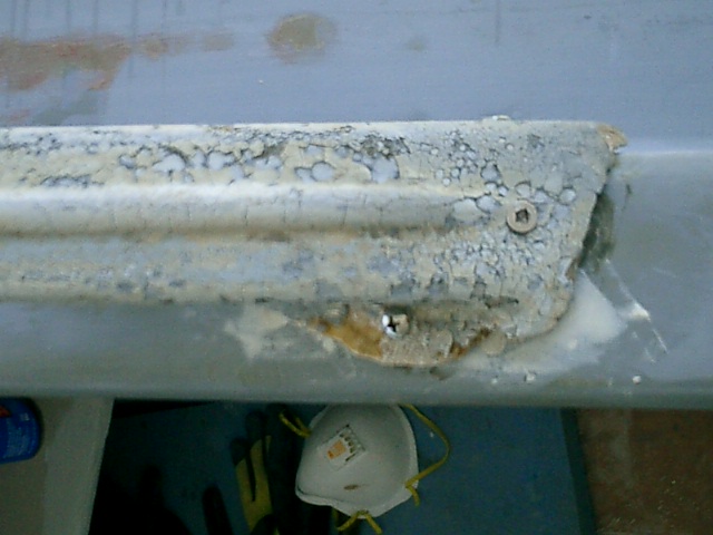

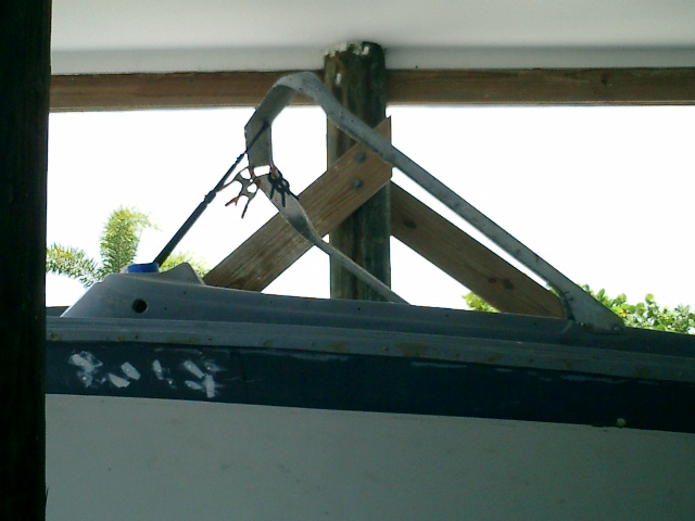

However let me share with you HOW TO REBUILD A FRAME
Two long years ago 3rdday rescued a derelict 21 Moesly in the Keys. I gave Brian a call an asked if there was a windshield frame on the boat and could I use it, to make a mold. Brian said yes but it was real ROUGH and just keep it.
Below is the before and after. The sad thing is I did this last year when I had time during the doldrums and now a year later I am thinking this is not going to work for me on the boat.
Oh well another learning experience.
Pictures of it in rough shape...

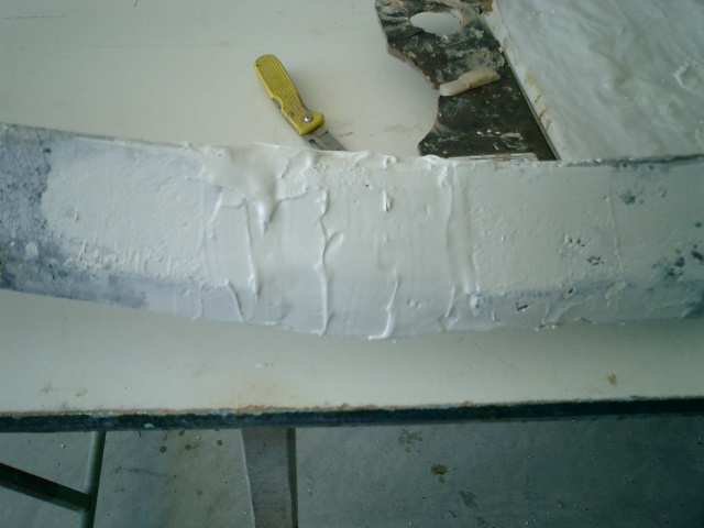

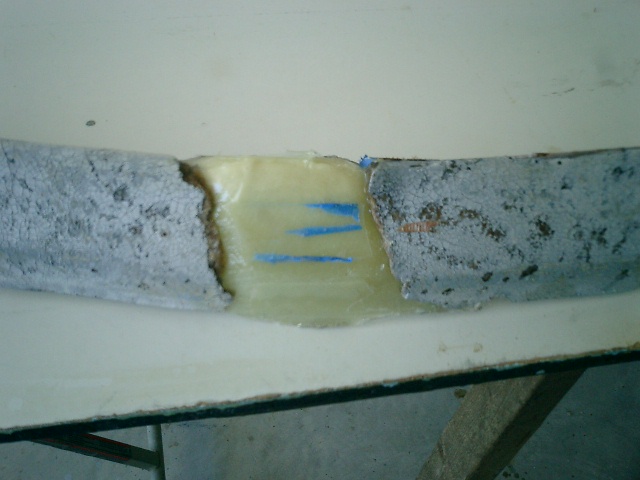

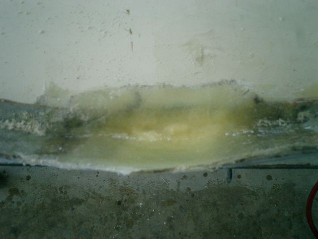

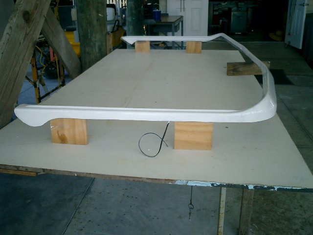

Not sure why but have to check why you can only upload 5 pictures at a time.
Rehab with epoxy and fairing compound.

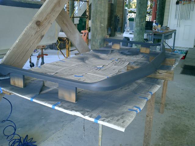

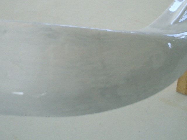

Default Part 3
Already to make a female mold..Sprayed with duratech. A lot of prep time but hey it was a learning experience.
