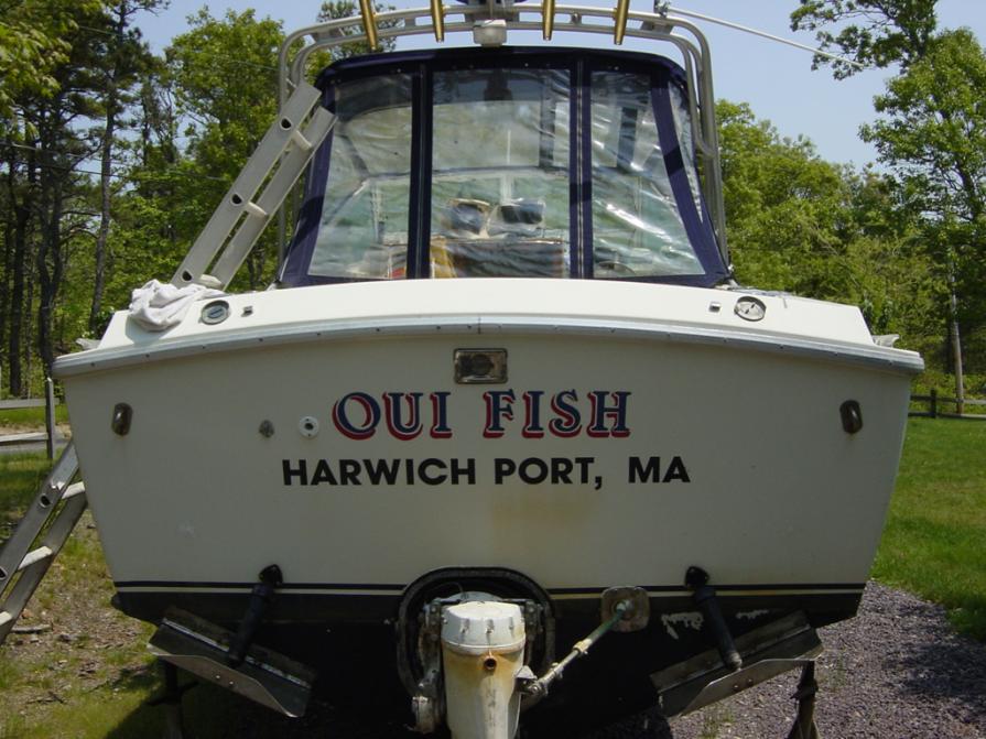

I bet my exhaust risers are not much above the deck, judging by the pics. the scum line on the boat is perhaps 4-5" below the scuppers, so fully loaded, I can see the waterline being close to the scuppers.

Location: Greater Boston
Posts: 1,117
Pictures of the (scum) waterline before the repower. Blue Heron passed these along.
