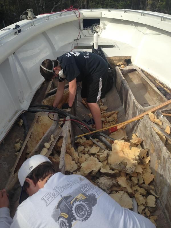

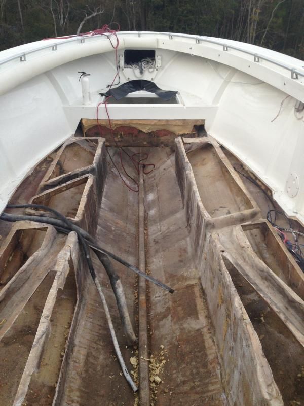

Holy crap! I never would have guessed that removing the foam from the stringers would be such a PITA. At least we are one step closer to being able to put this thing back together.
