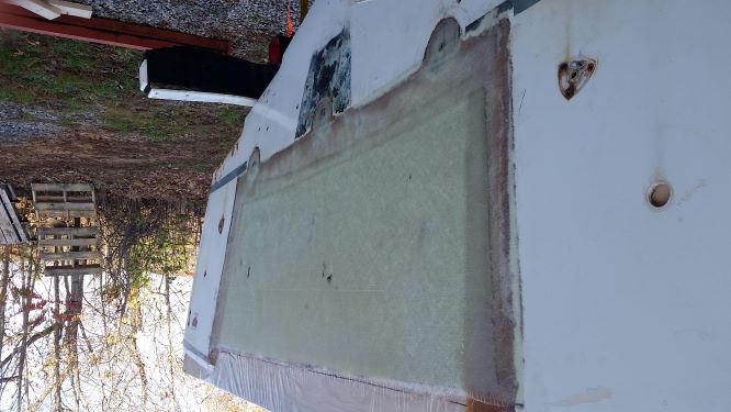

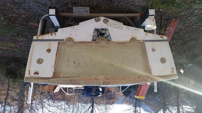

I will post some pictures in the next couple of days. So far I ground a 4" wide bevel on the outside of the motor notch and filled it in with 4 layers of 1708. I also added a layer of 1208 and 3 layers of 1700 along with 8" and 12" 1708 tabbing on the inside of the transom. I have the core cut and will be laminating it tomorrow.
So a couple of questions, I fought much to hard trying to get bubbles out where the 12" 1708 tape passes/drops off, the 8" 1708 tape. I have various bubble rollers including one that is football shaped, seemed that nothing that I did would get rid of the separation right where the tapes cross. if I work it to much then the tape would pull away from the corner where I laid a pretty sizable 3/4" to 1" cove filet. Anyone got a trick? Would love to learn something before I tab in the core.
On another subject, the boat is now water tight, in that the transom drain has been glassed over. My intention is to use Capt Chuck as a role model and put a garboard drain, with an extended handle straight down thru the bottom. Before I drill the hole, would love opinions on how the keel stringer is handled when adding a bracket? I was thinking of not running it back to the transom, but instead creating 2 taller stringers/knees on either side of the centerline, about 10"-12" apart. If I did that, then it would seem that the drain could go dead center about 10" in front of the transom. Sure would be nice to hose all the fiberglass dust off of the interior every once in a while. Thoughts/Suggestions?
Thanks,
Michael

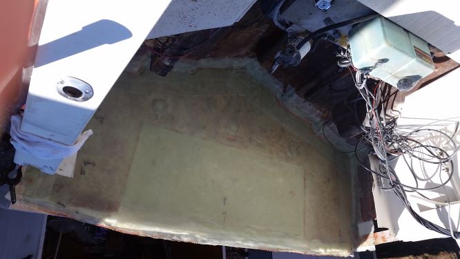

All right time for a photo update.
Transom is in
Added (1) 1208 and (3) 1700 to inside skin along with 8 & 12" 1708 tabbing.

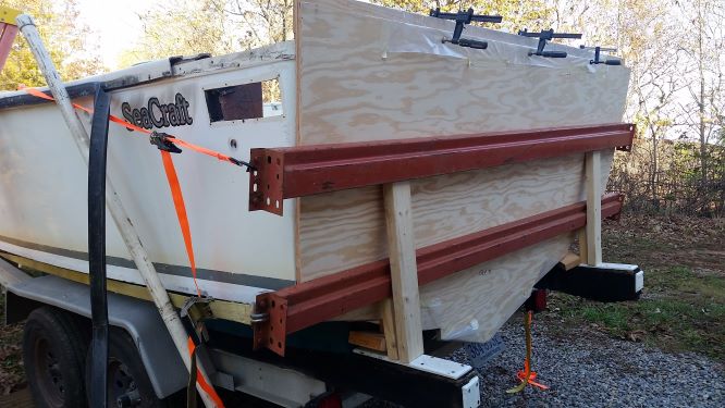

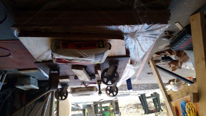

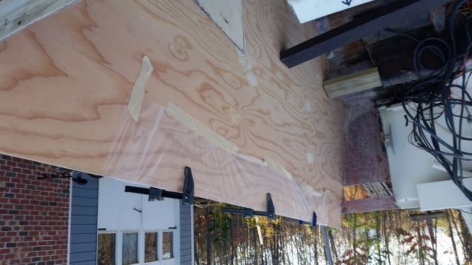

Laminated 2 pieces of 3/4" marine ply and one 1/2" marine ply. Let it cure after applying neat epoxy to all inside faces and troweling on a cabisol, cotton flocking mixture with a 1/4" notch trowel. Squeezed it together with a 300 lb steel plate and screws and a coupe bags of concrete mix. When I cut the top curve the laminate looked solid with no gaps. I then a coated the back and sides of the core with neat epoxy and troweled on the cabosiol mix on the inside skin and back of the core. Pulled it all together with some long 24 and 30" clamps that I welded up along with a handful of 2x6x18" blocks inside and out, thru bolted with 1/2" rod.
Pulled fillets on the inside and added 8 &12" 1708 tabbing. Then laminated it with (1) 1208 and (4) 1700; wrapping 3 layers over the top and down the back staggered to 5".
