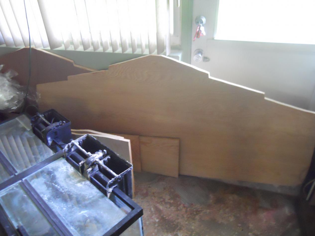

been sick last two weeks and havent done much, had enough energy today i went outside and made my template and cut my two core peices out. then ran out of steam. hope i get over this crap soon....

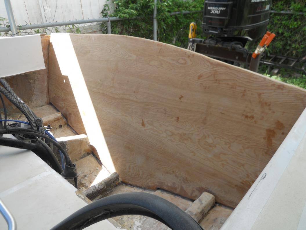

well a bit more grinding today and test fitting the wood core peices. have my glass cut out and my resin is in the fridge cooling out, tommorow after work god willing i will assemble the core and get a step closer to being back in the water.

Posts: 261
one more step... wet out the wood and added 2 peices of 1.5 oz mat then wet them out and sandwiched and screwed together...... just not enough time after work to feel like i got much done...... maybe i can get it cleaned up tommorow and set in place to cure so i can glass this weekend. should i use mat or roven between the core and outer skin or just thicked resin to set it in like a putty?

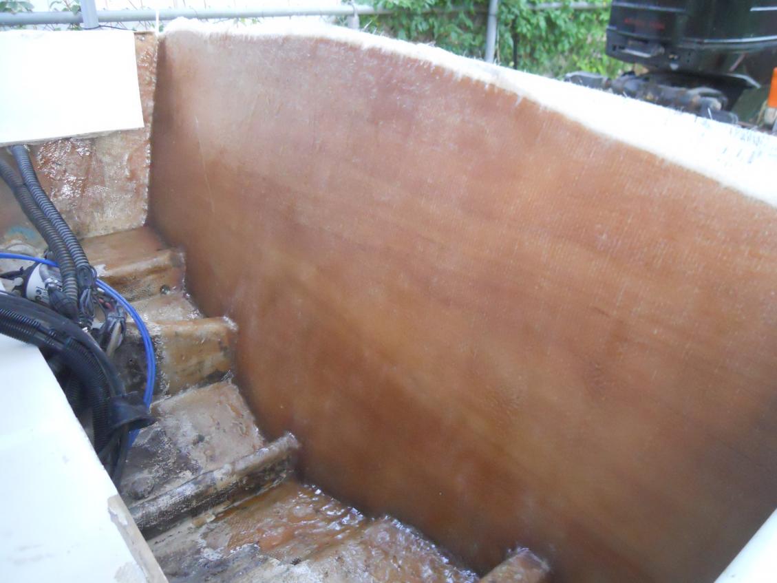

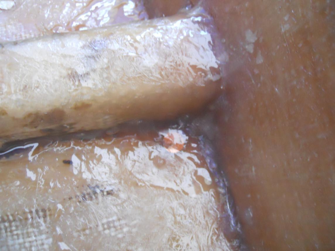

Default back at it again...
well finaly was able to get the core set and filled in the sides and bottom. today i was able to get my wifes help and we glassed in the front side of the transom. two layes of medium mat with one layer heavy roven in the middle extending forward about 6 inches, lots of patches first over the fillets. and as my girls put it a penny (heads up for luck!). hope it dosent cause some reaction and mess me up! feeling good about the progress. more glass on the back to do then build the rear cap and floor. install the bracket and hang power! sounds easy enough
