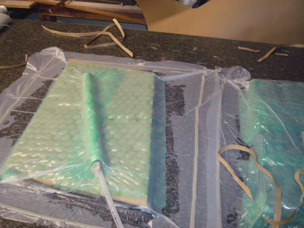

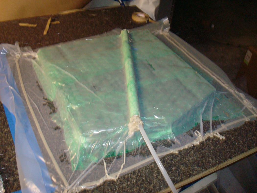

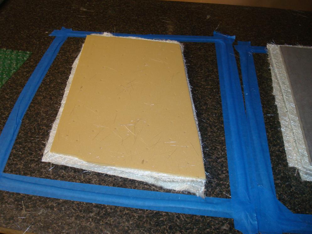

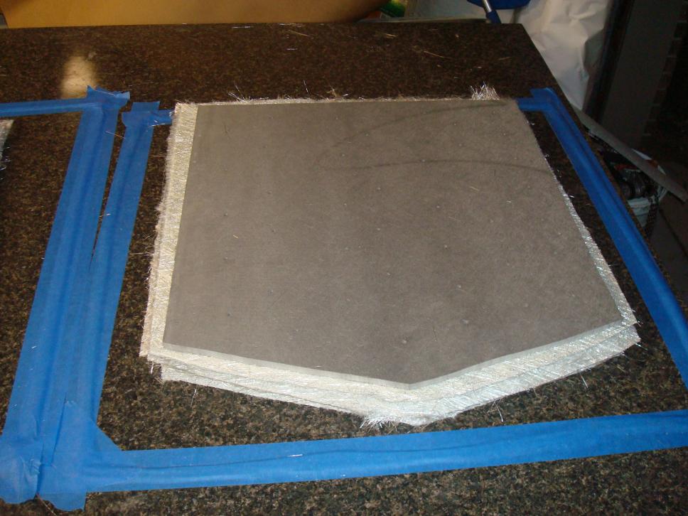

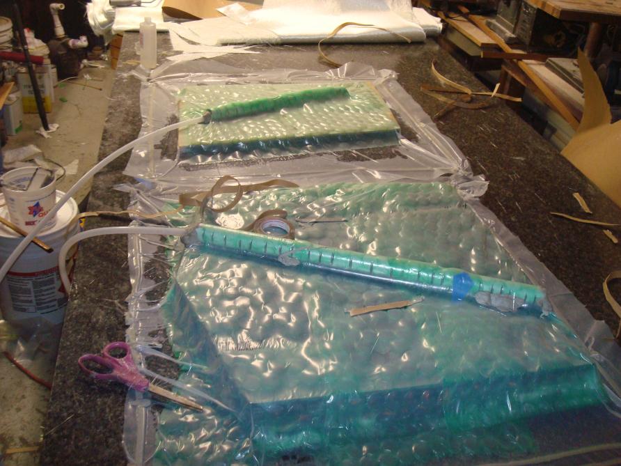

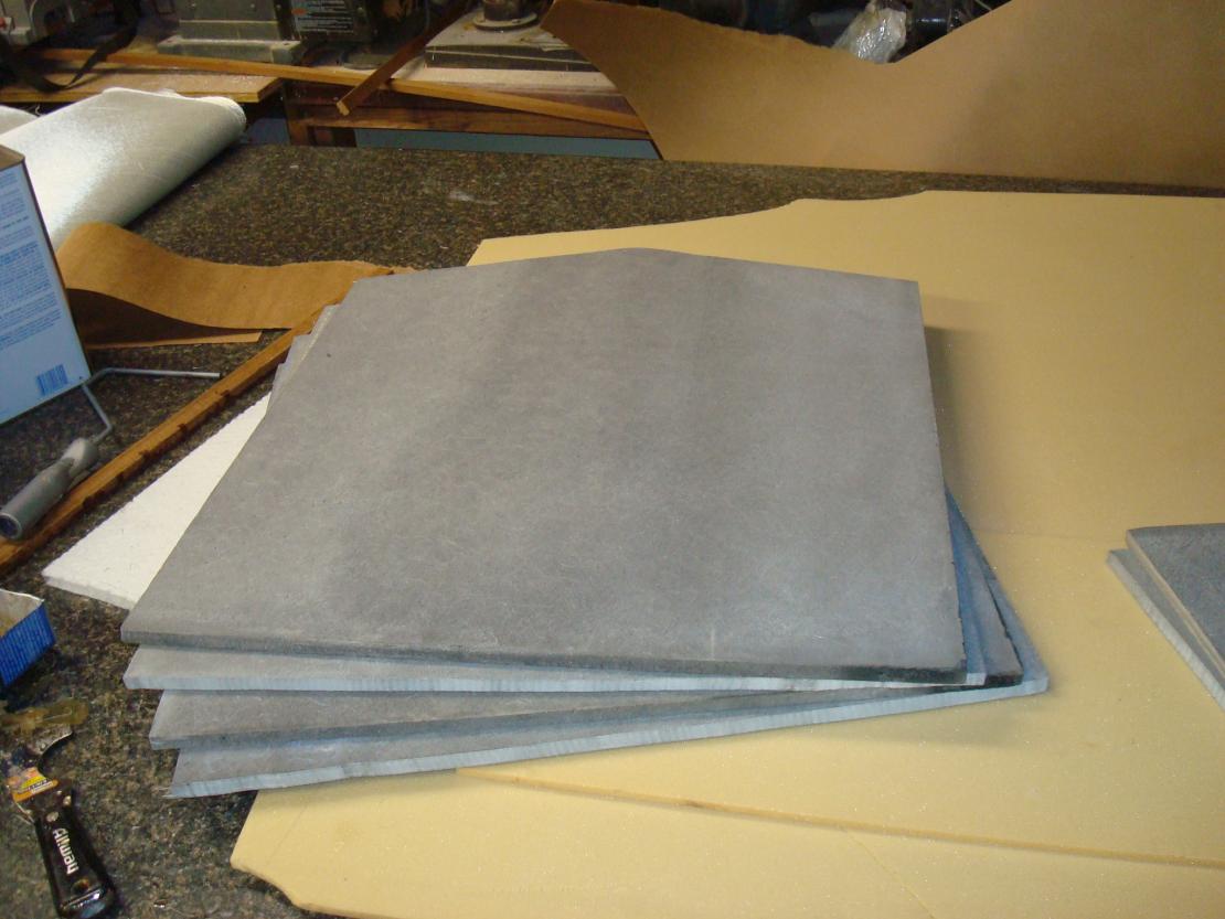

Laying up bracket mount for engine. 4 layers of 1/2 20lb density foam. layer of 17/08 and 2 oz mat on each sandwiched layer . drilled bleader holes for the resin to soak through and pull vacuum to ful vac of -30 then backed of to -20

Default stringers for bracket
Layed this up after I pulled vac on engine mount.... then pulled vac on both parts
