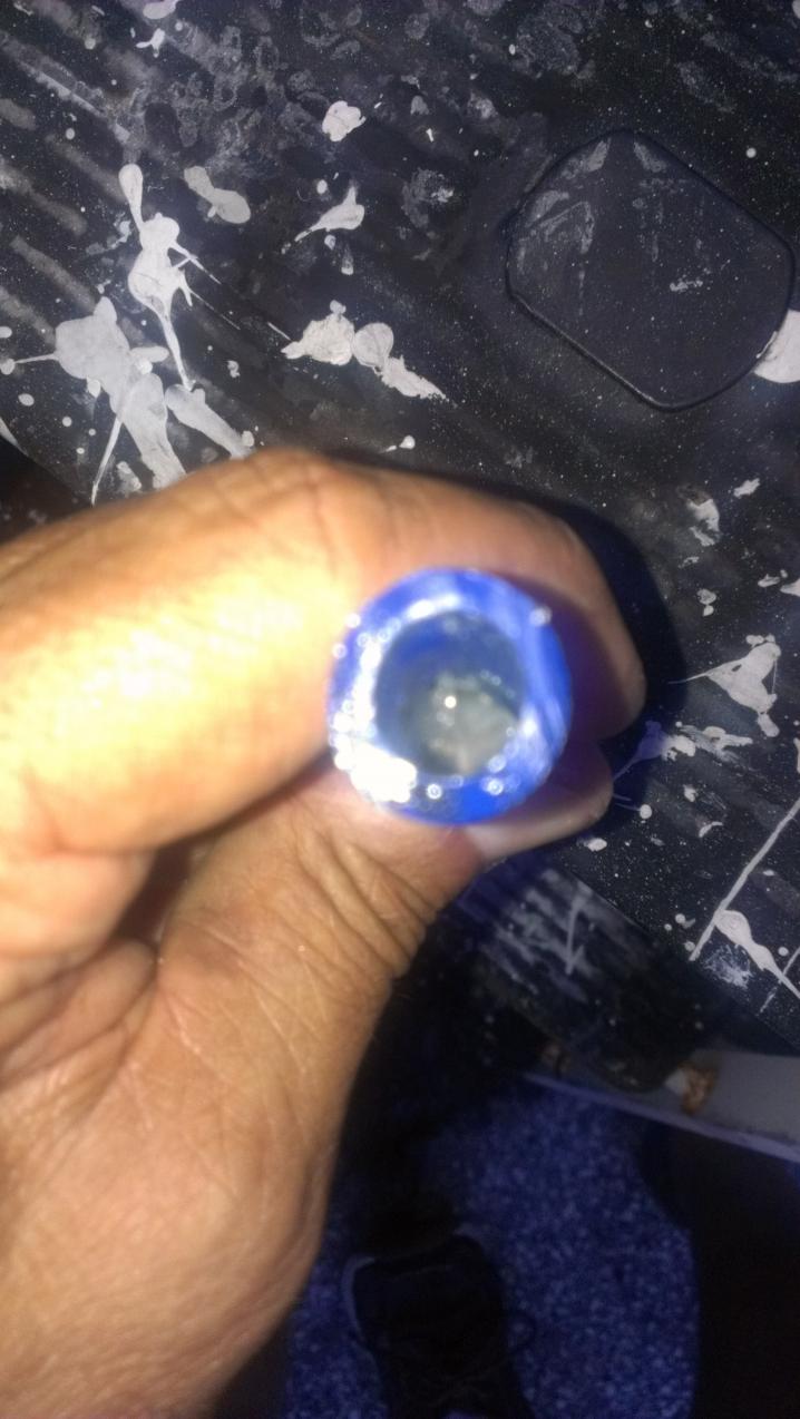

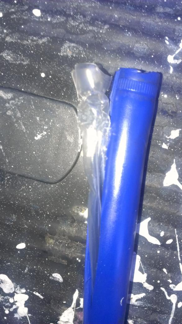

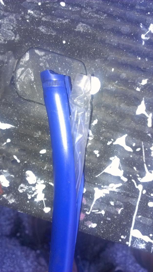

Well carbs were opened up and they were clean so I lifted the coffin lid to get at the tank. took off the fittings and checked the pickup tube and all ok
I was stumped
Took off the clamps to the gas line and here's what I found.
Apparently the hose has a plastic liner that when it placed it in the gas fitting it caused the blockage I also think that the primer bulb is bad too.. So new gas lines and primer bulb tomorrow.
What junk probably made in China

Triton A1 line here folks. Alcohol is a very strong solvent. Is that an alcohol resistant liner? Yikes.

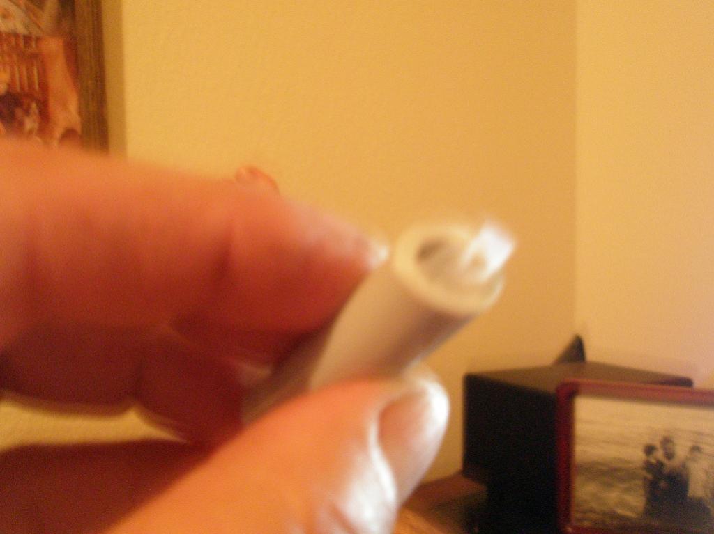

Same thing happened to me. Fuel line was not even 2 weeks old. De-lamination due to alcohol. I went black and I'm never going back

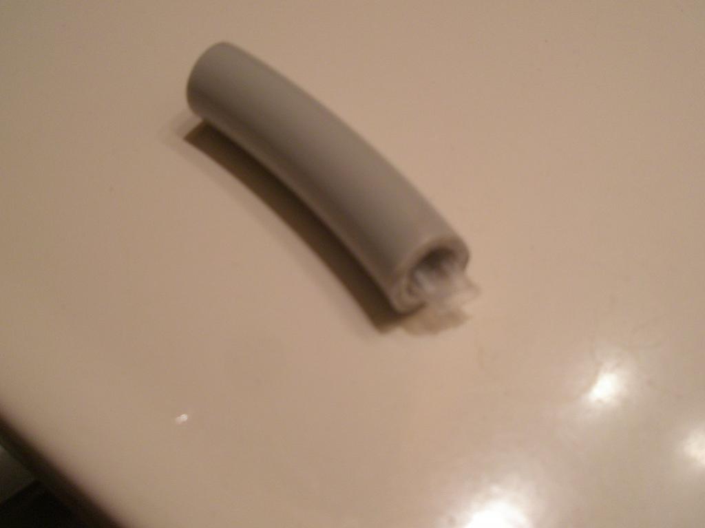

I had that happen in my little skiff, I had used the grey type, said it was alcohol resistant - it was not.
