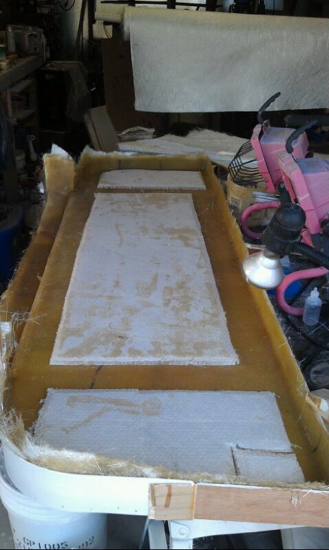

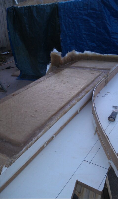

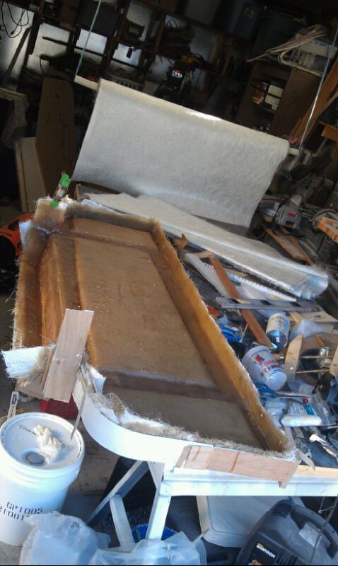

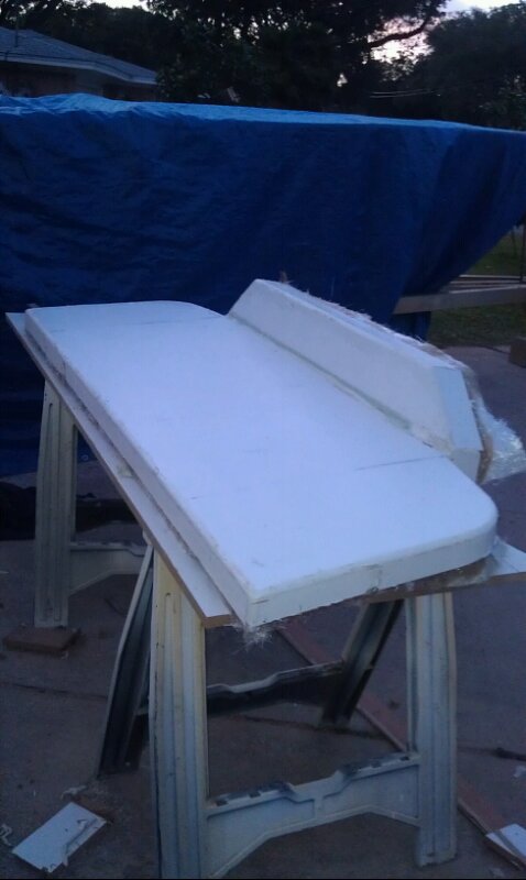

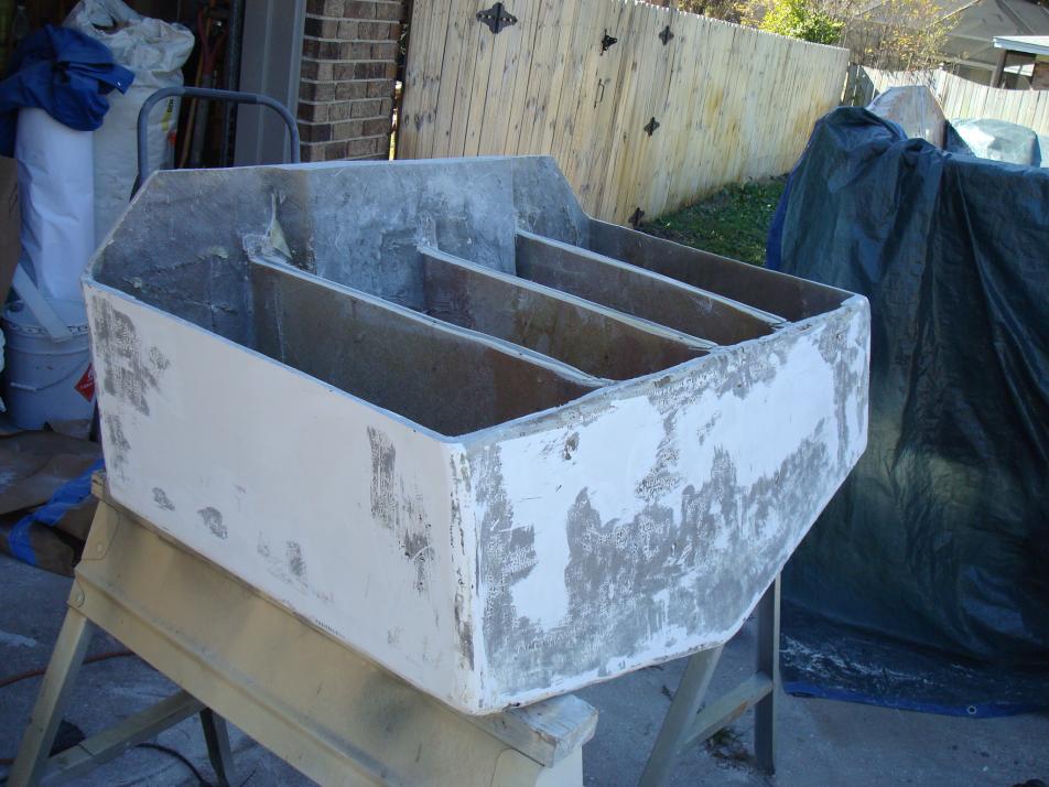

Default Finished grinding and shaping tub Platform layout
Just pulled the platform out of the mold. Came out pretty nice comparde to the tub. Just need to fit it in the am... Will put one access hatch in the middle and so I can glass the center stringer to the platform...

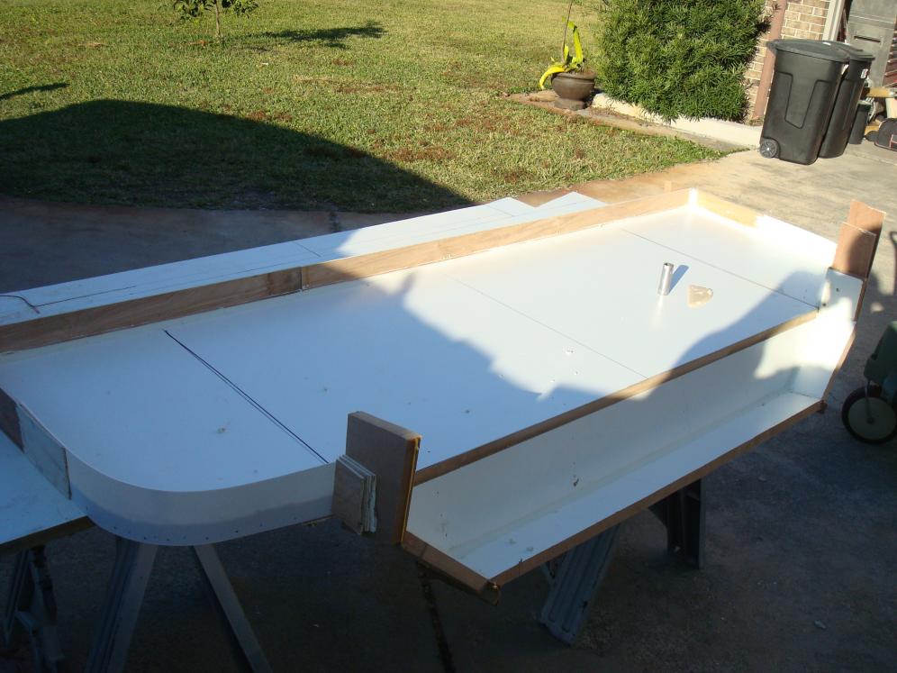

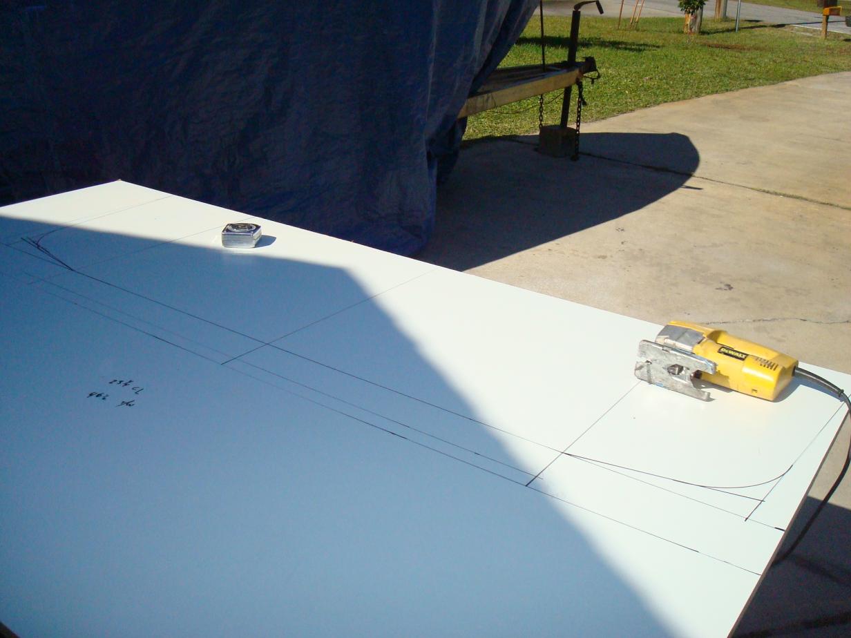

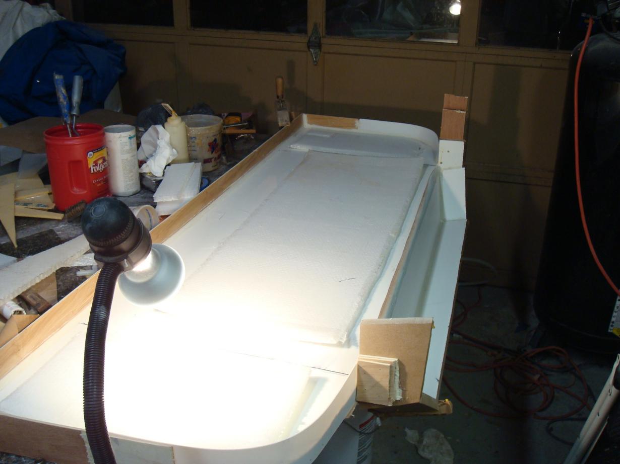

Posts: 1,061
On my radius I had a hell of a time bending the 1/8" luan believe it or not... So after cursing up a storm i decided to pull a sterlite Tote from the attic and cut the top off. I made sure it was stamped PP before I proceeded..After all I didn't want to get yelled at for nothing.. anyway this actually worked out really well and the Gelcoat came out beautiful... will fit the top Monday.. and start back on the transom.. until then hope you all had an itchy Weekend. two layers of 2 oz and two layers of 1708 sandwiched with nidacore and two layers of 1708 to finish off.. part weighs about15-20 lbs..72 inches wide x 24 deep Will weigh total when I get done...

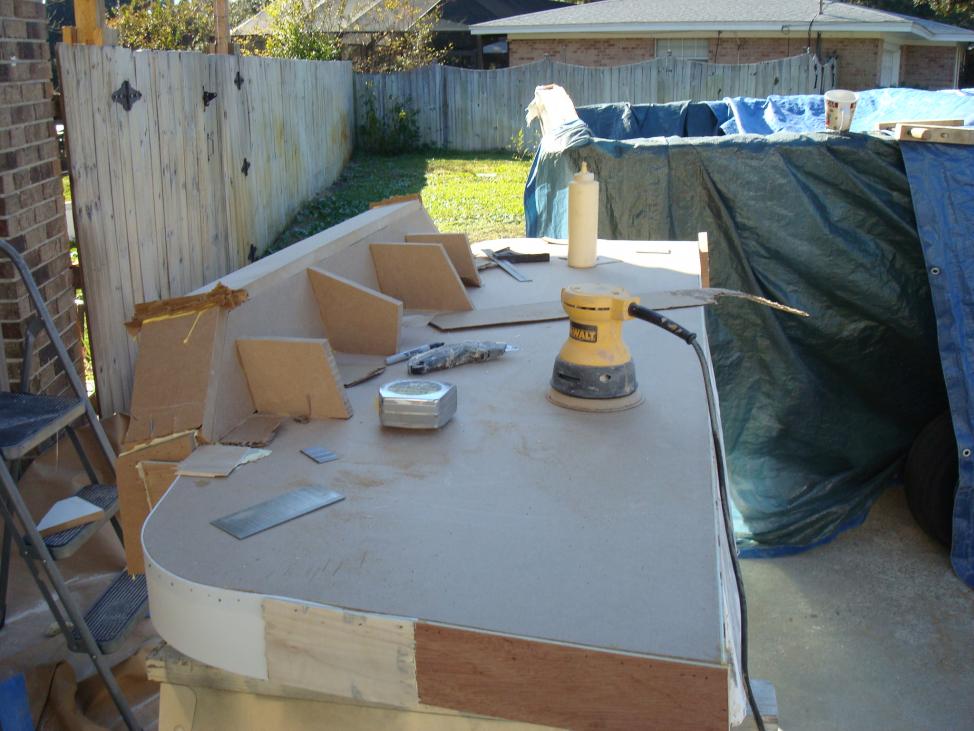

Posts: 1,061
Not much goin on here. Sanded the hull out and glued the top deck down.. Waitng on some deck parts so i can finish the bracket and decks
