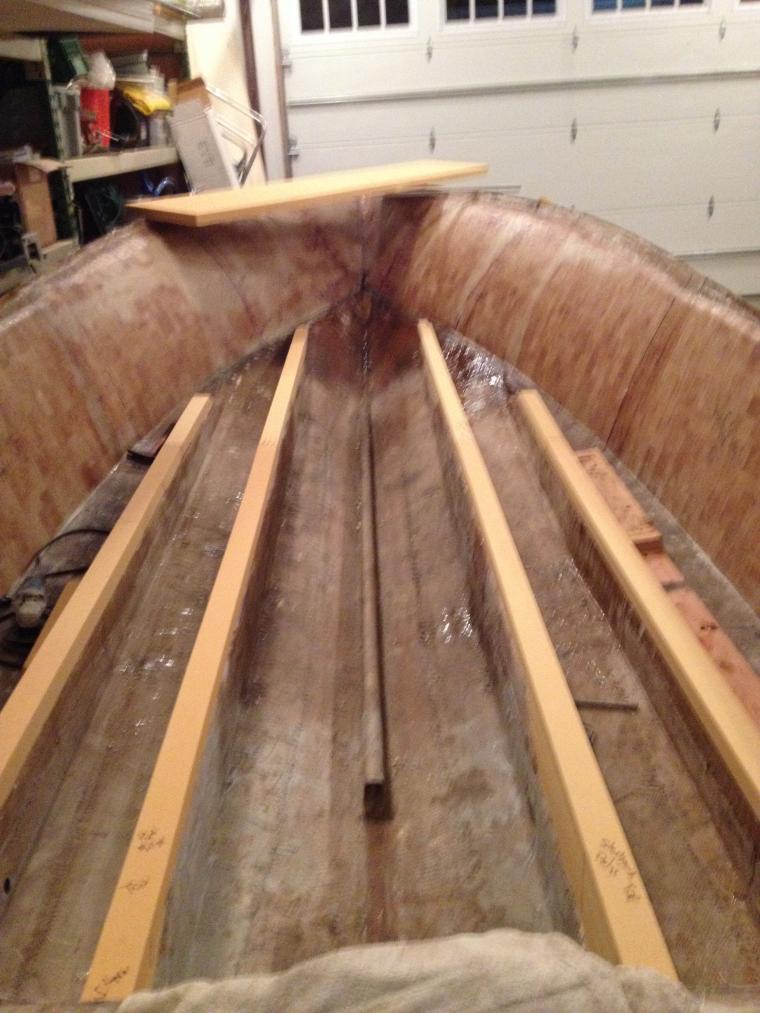

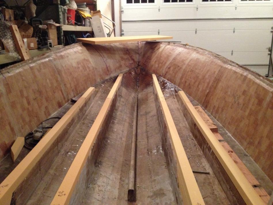

I finished building the stringers and had to push the boat to the side as we had an incoming snow storm and had to get a bunch of the trucks ready Alright it is almost liked a planned this. I have enough 2" foam leftover to build my bilge bulkheads out of. I want to say I have 18"x 8ft left so I ripped 12 strips at 2.5" off the panel. It took exactly 12 strips to lift the stringers from front to back and a little extra by the transom to build the stringers to the transom.
I am going to use 1" foam around the outside for the deck to sit on. I am hoping to get the stringers glassed in this weekend.
