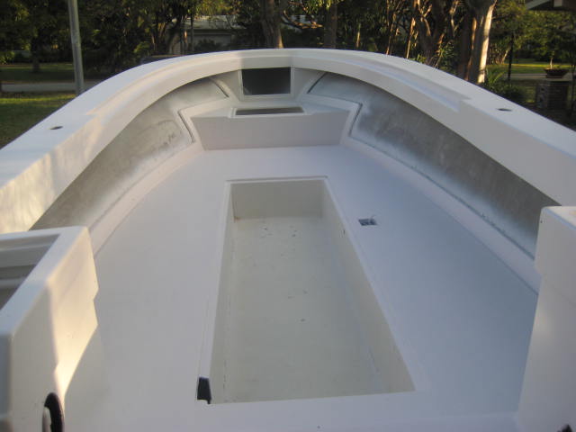

Got around to spaying the 2nd coat of primer yesterday and a thought came up.
I'm at the point where I have the boat taken apart and I started thinking of a t top install in the future.
Now I know that they go screwed into the deck and some in the console.
As to the deck...would it be aggod idear or not to cut into the sides of the coffin where the gas tank goes and place some type of backing to the underside of the floor where the t top would go screwed into to? then reglass the area that was cut out
Has anyone tried this? is it a good/bad idea
This may help reinforce the area that holds down the top

the backing plates is a great idea - not sure what tank you have but mine has a compartment under the front of the console where my batteries are that would work I think - mine is 48 gal - that area may be taken up with the larger tank

I have the larger tank that takes up the whole coffin
Does anyone have some approximate measurements on where/how big to make the backing plates and where to place them
Plan would be at least 1/2 marine ply encapsulated with glass/mat prior to placement

Backing plates would be a great idea. I have to re do my t-top and CC bc nidaboard,which is hollow, was used and the screws backed out while running. I think that the measurements might vary depending on the t-top. I can measure if you let me know which ones you want.

I'm just going to go bigger and cover a larger area since I don;t know what top I will be installing or when. I guessing some where just outside the edge of the console and make the it 4-5 inches wide and maybe 12 inched long I thing that would cover most of the possible areas in questions.. From what I have seen most front legs go just about where the front of the console ends and the rears the same but towards the rear of the console. Either way I can have the manufacture make it close to those areas

I'm almost finished spraying the inside with the primer.
I still have to do the coffin and 4 spots that came up with pin holes and the bottom of the outside hull
I want to say not bad for a rookie with a small compressor doing it in the driveway

Jorge...glad to see some more pictures....looking good..I know how it is to do all in the driveway!
Keep the pics coming!
