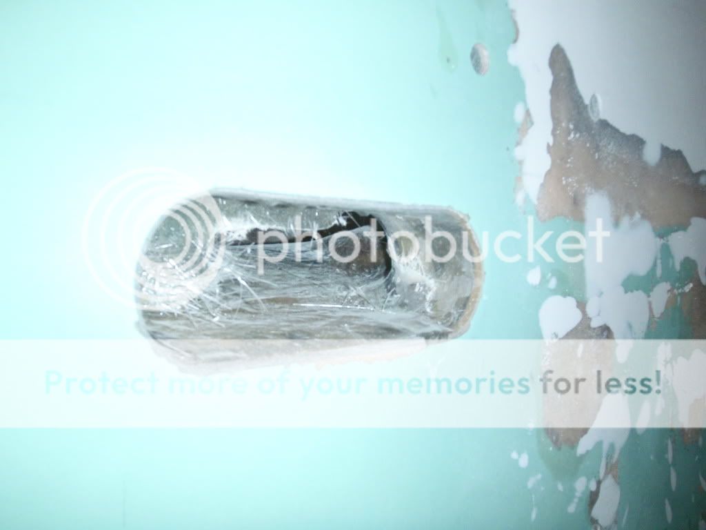

I have managed to get my tanks in, PVC chases cut to size, transom cap into shape and ready for glass, a coat of filler on the transom and all the old thru hulls and scuppers filled in on the bottom of the boat. I picked up my new Hermco bracket today too. The bilge hose for my fish boxes will be here tomorrow, the first roll was the wrong size. Once the hose goes in, I can glass up the last bulkhead and screw down the tanks. I am also waiting on fuel filler hose, I have send line and vent line.

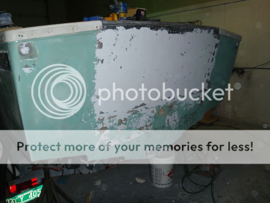

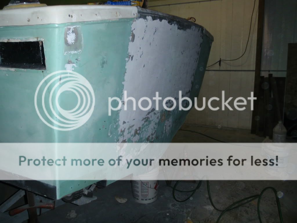

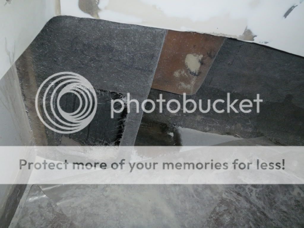

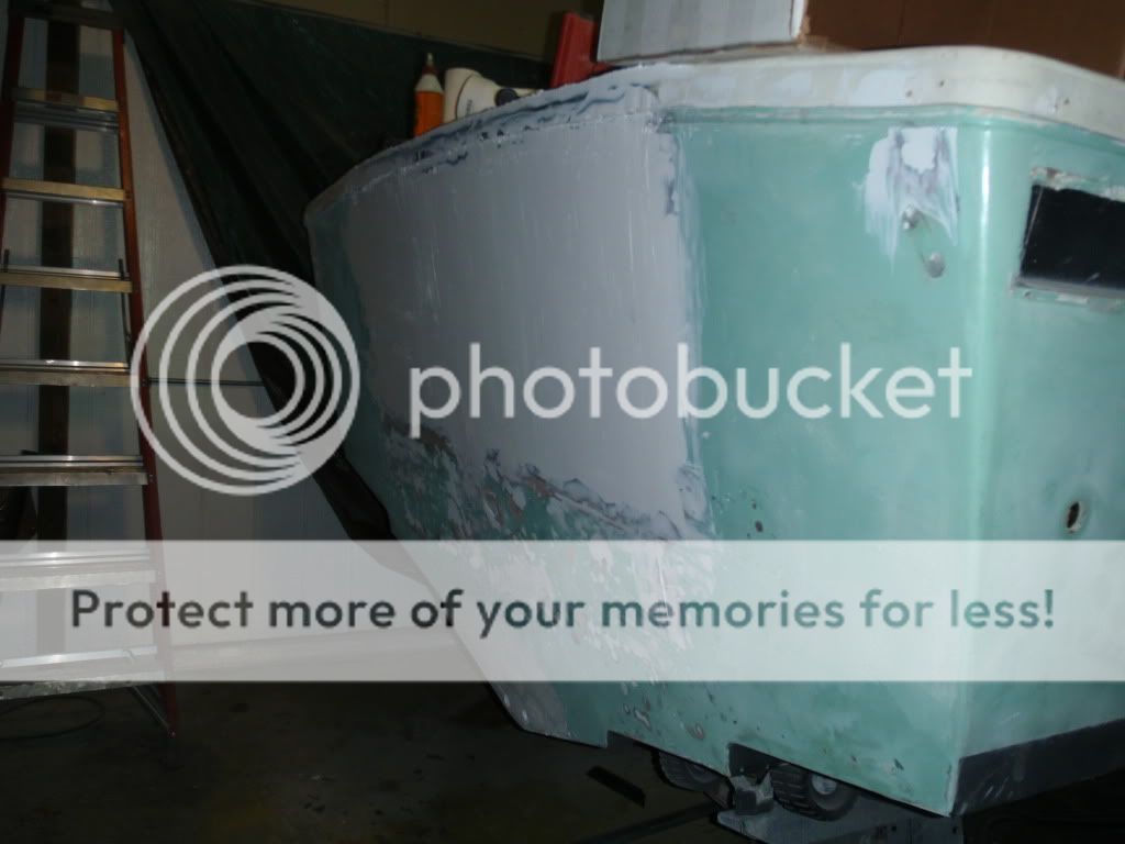

Put the bracket on last week, mainly to drill the holes and mark out for scuppers. Put another pass of filler to get the last of the body work on the transom cap *looks a little bumpy in the pics*

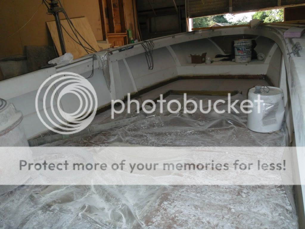

I also glassed the inside and mocked up the corner boxes/floor setup. It looks like ill have to build some sort of 'catch well' for the scuppers, below the level of the deck. If you look close inside the boat there are sharpie marks for the angle between the swim platform and the floatation tub of the bracket. Kinda sucks as I wanted to have a clear flat deck back to them, but oh well.

Scupper issue solved, going to make slanted ramps in the floor, down to 2.5in lower than the bracket flange for scupper door clearance. Going to have to 'notch' into the stringer top a little bit but after its all said and done drainage shouldn't be an issue.

The body work is 99% done, got one more little bobble to deal with and it will be getting shot with gellcoat in the next couple days. Should be able to roll it out middle of next week and start bolting on the shiney stuff!
Grabbed a couple pictures today too
Transom top

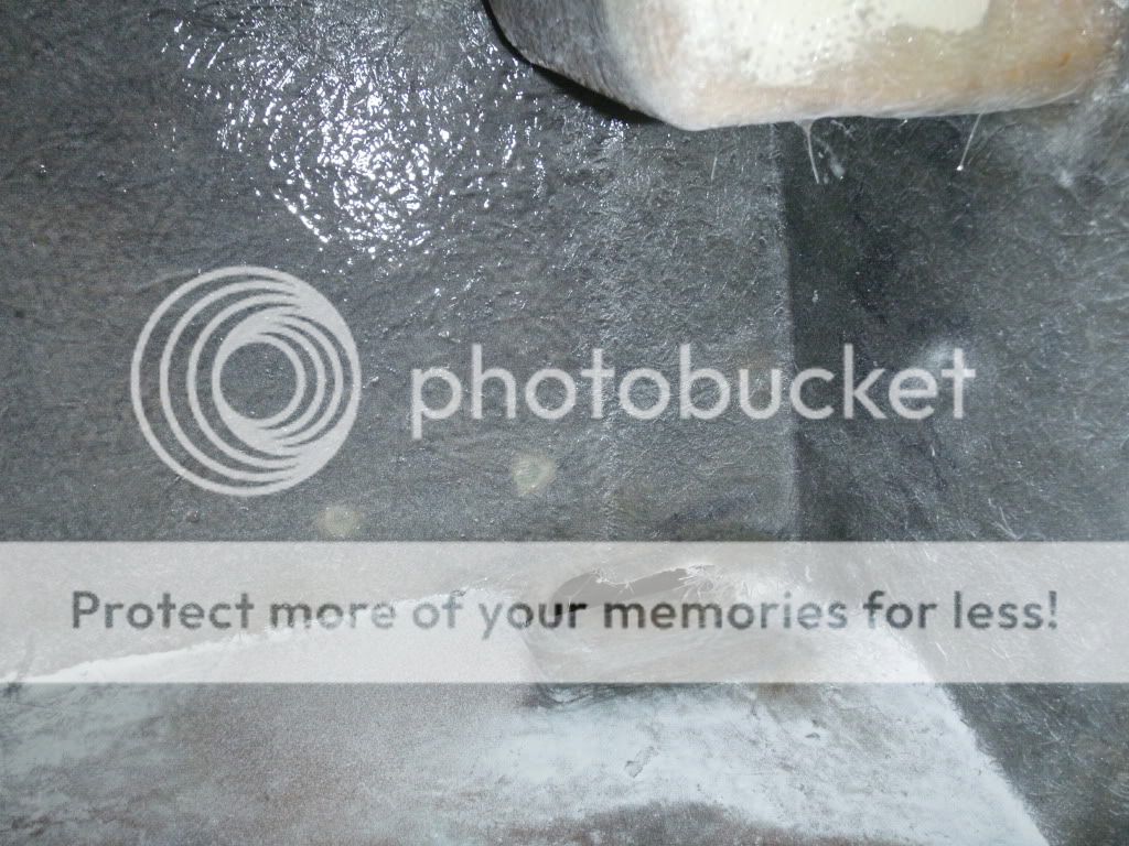

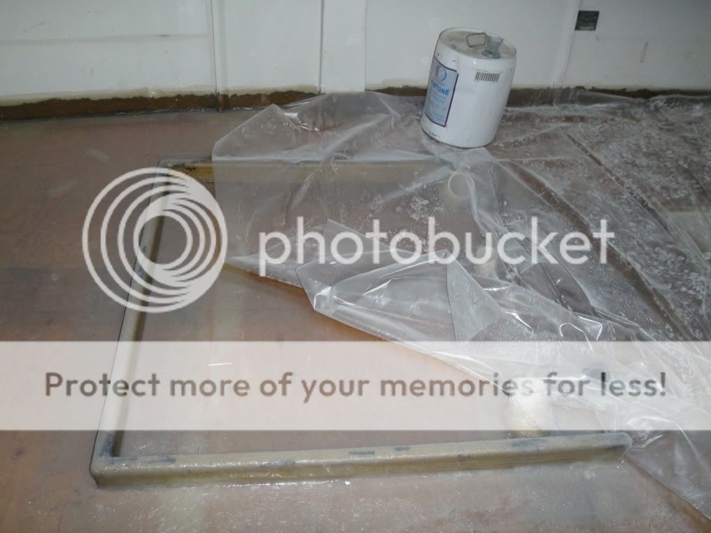

Instead of screwing down through the deck (and making more holes for water) I will be thru-bolting the console into this 3in raised piece that is completely glassed separately from the deck.
In these pictures you can see the height issue I had with the scuppers, the row of 1/2in holes is for the platform on the bracket and in the following couple pics you see the 'slides' for the scuppers 2in lower than the floor height. For this reason alone I am ITCHING to get it in the water and weight it to check the water line!!
