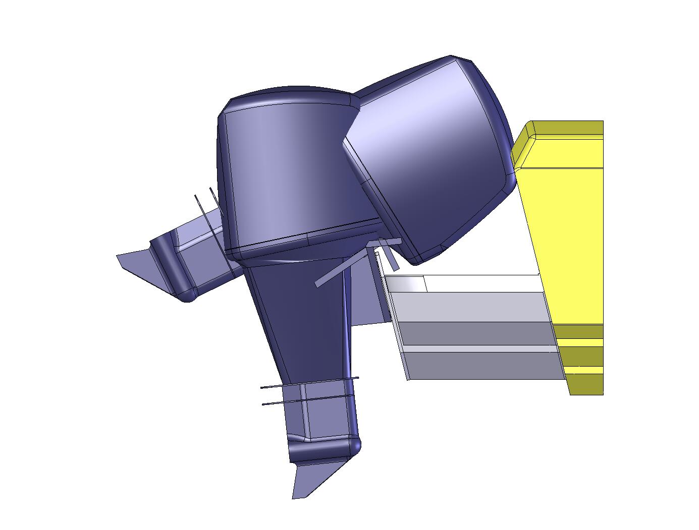

For a 20 foot seacraft-
Without having made one, but having modeled one in CAD, a 20" shaft inline 4 cylinder 4 stroke gets tight on a 24" transom if you want to tilt it the last few degrees, at least when I modeled a 4 cylinder yamaha tilted up at 70 degrees. At 60-65 degrees tilt, it looks ok.
I think the e-tec powerheads are shorter and you might be able to go to a 22" setback on a 20" shaft motor, maybe.
And I think a 25" shaft motor probably gets the powerhead above the rub rail on the transom on non-master anglers (which have that tall cap).
The pic below is of a 20 foot master angler with a 20" shaft yamaha 4 cylinder 4 stroke (F100)- probably the worst case for clearance, and it still will work at just 24" setback at just a bit less than full tilt up.
Everything centers around two measurements:
1. Engine shaft length
2. motor clearance when tilted up.
Figure these two things out and the rest comes into place. It is better if you do this in your head and draw it out on paper. 30 inch set back is a bit too much for a 20' foot boat in my mind. The 30 inch set back is for big V 8 motors that go on a 23 foot boat. Another thing....make your flotation chamber as big as possible. Good luck!

Thanks for the measurements!
I am assuming my pivot point is correct for the Yamaha. It is sitting under 2 tarps waiting for snow...
I plan on on recreating the cap contour atop the transom, so that's what is shown in the model I have. Now I have to find the Yamaha manual and make sure I didn't goof the pivot point. I was lazy and pivoted it about the top of the bracket edge, but it is probably 1 to 1.5" above and forward of that point. With the 20" shaft, I will need the motor low on the bracket, I think. If I could only find a 25" Yamaha F100, it you be easier.
I do have a CAD model of the 130 from the internet. It seems to be the real deal. Maybe I can drop it in and compare. But no E-Tec for me. My F100 was $1000, and that's my kind of budget. Unless I find a 115 Etec for $1000
