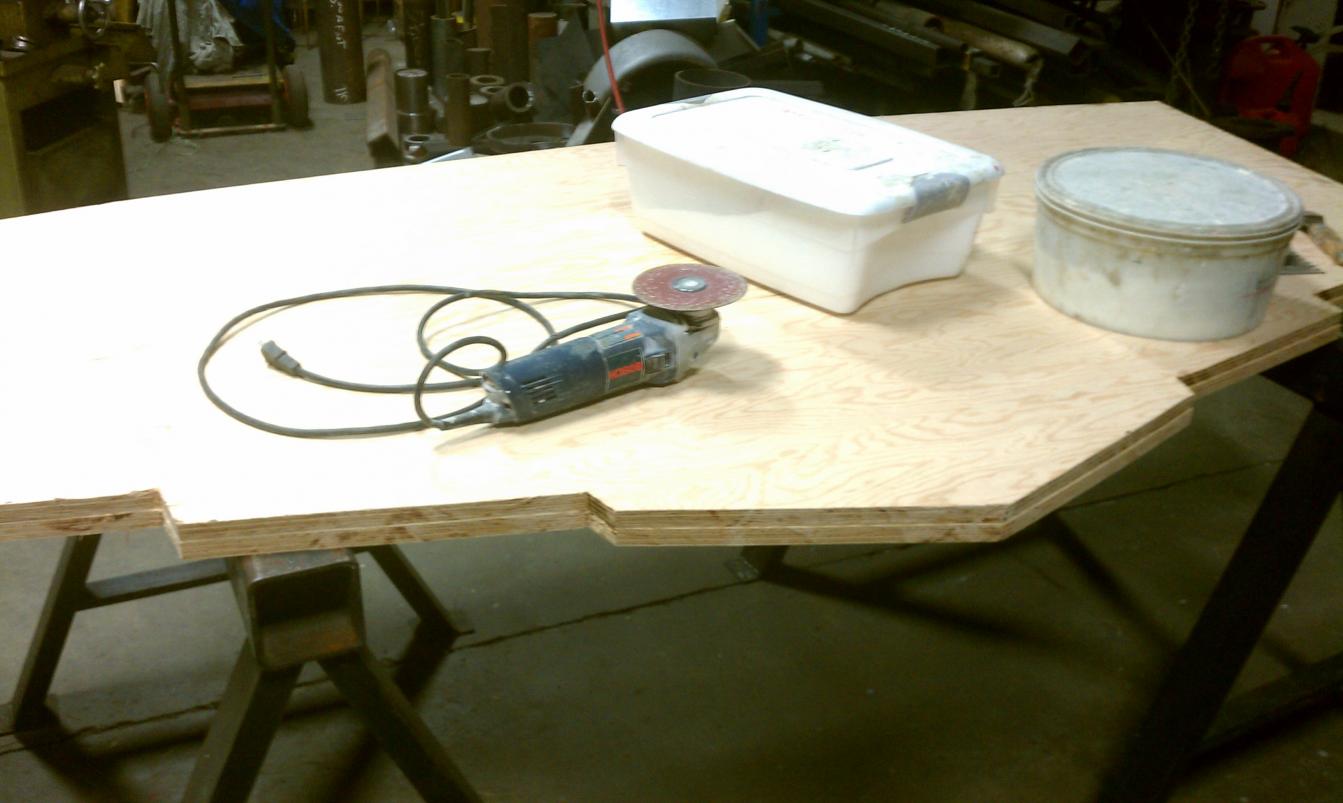

Well i had already ordered the epoxy from Merton's in Massachusetts so i might as well use it, the guy there talked me into it. I will post some more pics as i make headway, just have to get through this nasty storm coming our way tonight.

Cutout will epoxy today

I used vinyl ester resin, it's not porous like poly.

A new boat today typically has only an 8 lb. density sheet foam core. I see no problem with using the old tried and true wood and poly. Most boats back in the day were made that way and are still serviceable today unless water has compromised the core material.

it's allways best when jobs like this are done in a building,out of the weather - you really want to avoid performing jobs like this,when things are exposed to the elements - rain water and wood isn't a good combination...
there's nothing wrong with using a wood core,provided that wood core is completley sealed...

The room temperature epoxies that we buy are generally DGEBA chemistry with an amine hardener. The "BA" in DGEBA stands for bisphenol-a. The same BPA that everyone freaks out over in their water bottles. People do get sensitized to the stuff, to the point where they can't get near it. So protective gear is important. Otherwise you could wake up one day and not be able to work on your boat again with epoxy. Some might say that is not a bad thing...
Also, I seem to recall that the vinylester resins have a chemical structure of an epoxy on one end and a polyester on the other. But that composites class was a long time ago. It didn't seem to bother the guy who had DGEBA epoxy sensitivity. And it doesn't stink of styrene monomer like polyester resin.
