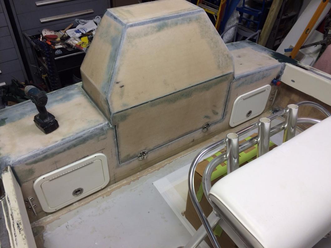

I got most of the hardware mounting done before i left got the console mounted and made some rigging runners from the floor the coring also got the electronics panel cut and mounted the electronics. 12" screen is gonna be awsome

Rear end with cowling mounted

Another of the console and door with switches
You can see the vhf , amfm remote , fuel guage , suzuki tach and voltmeter will be next to it
