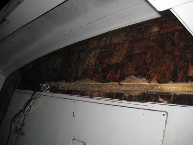

Did some work on the floor today
Took off the skins and 1/2 of the rotted wood and had loads of fun with the grinder
Should be done with the whole floor by the end of the week end.
