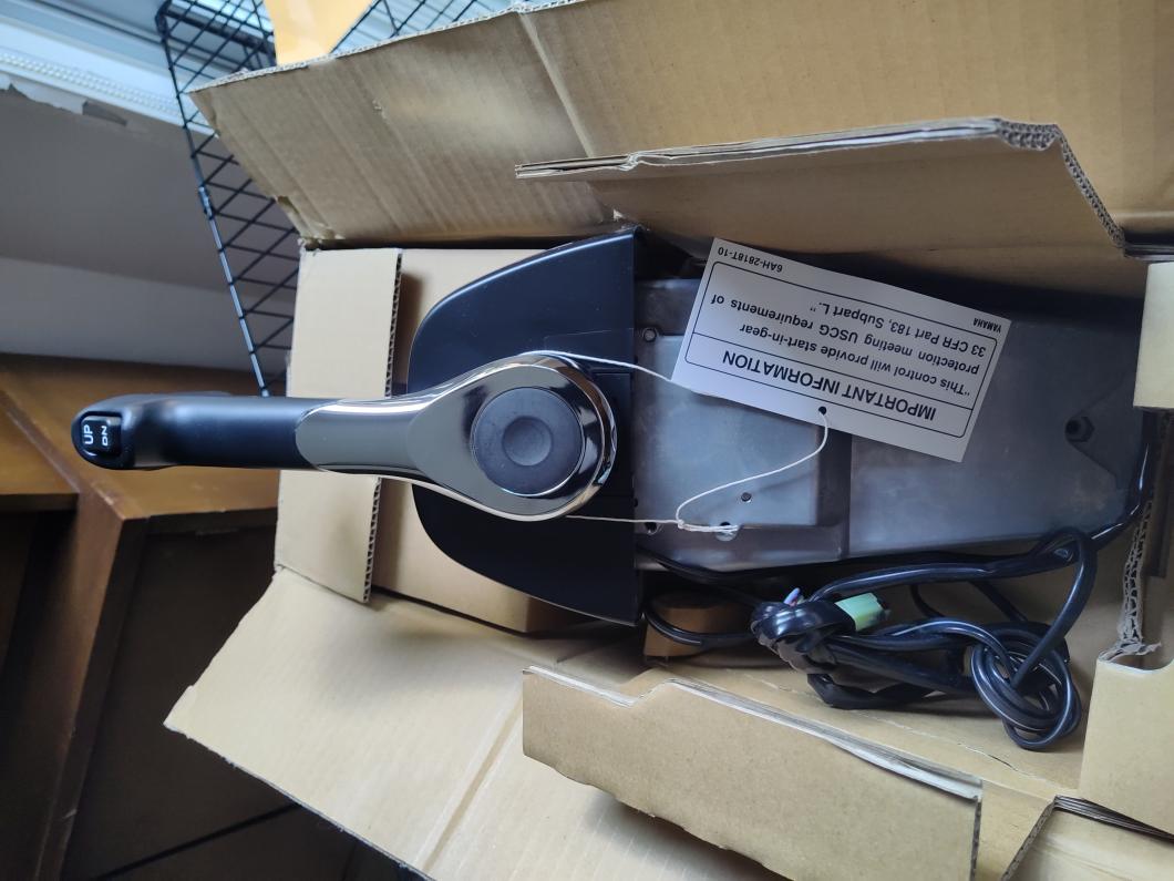

Received a nice package today

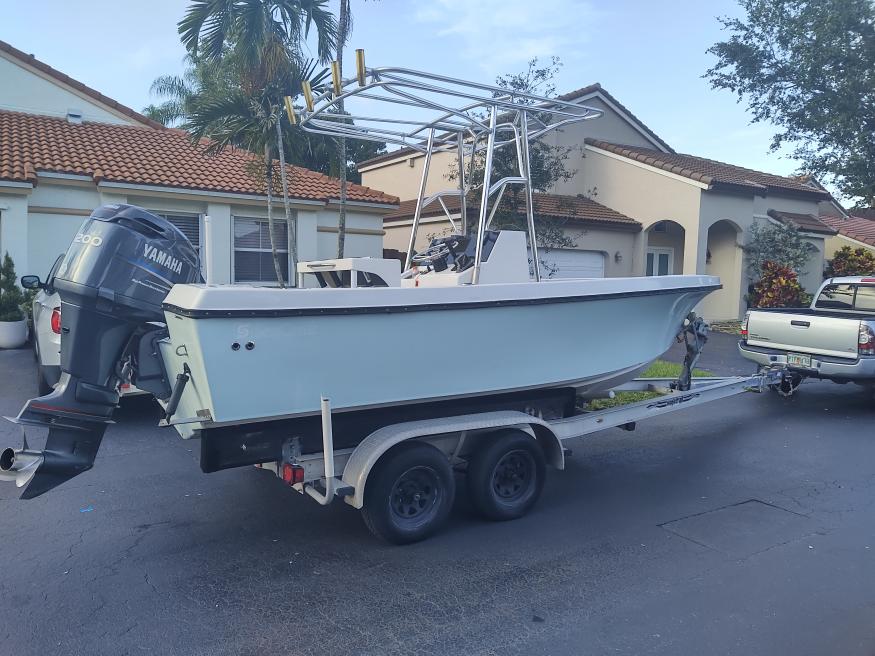

Getting real close to splash

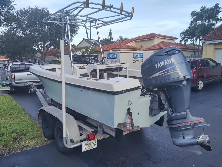

So today I used 5200 to glue down the 2 bilge pumps and ran the wires for the 2 pumps, the live well and lights. Also when I ran the wires and cables from the console to the engine I forgot about the wires connection for the command link , it was a royal pain to do and in the 90+++ heat today it was a bitch.
On a good note when I was finished I decided to hit the key to start the engine and much to my delight it starts right up and surprised me.
Well tomorrow's another day to get a few more things done....it's getting closer

Received some goodies today to work on the electrical and some Yamaha connectors for the command link.
