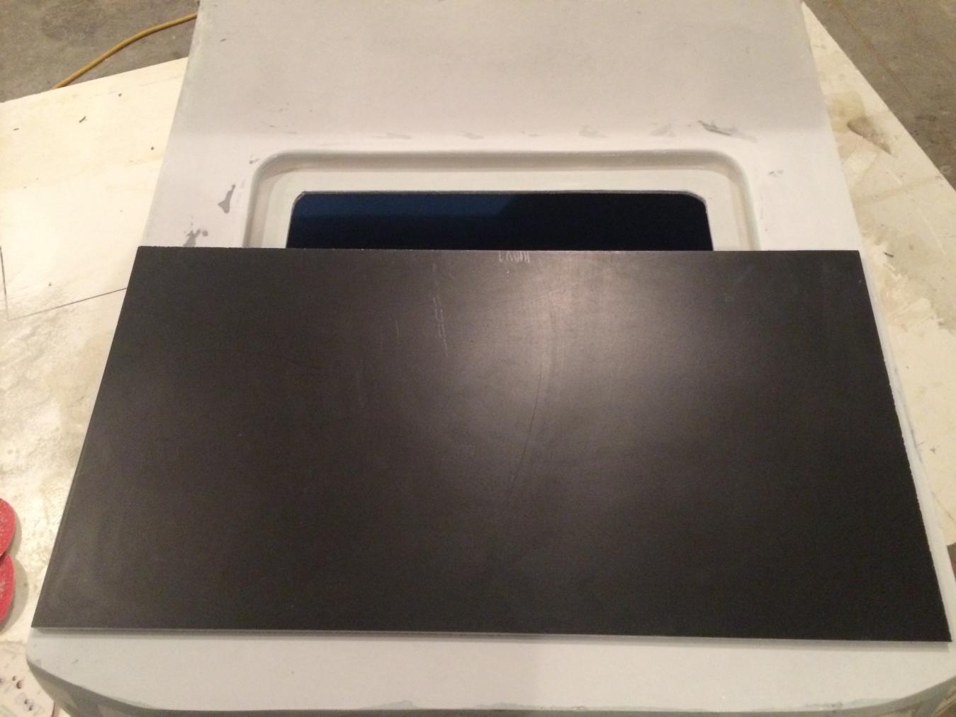

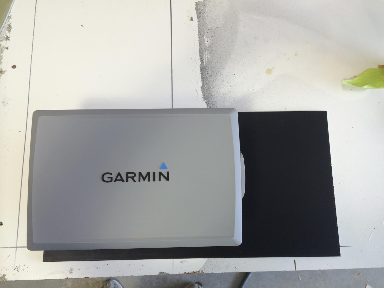

I decided to mount the electronics on a black gelcoated panel. I marked off an area on the melamine and I sanded it down to 320 and waxed it , I sprayed the gelcoat down and let it kick, then 2 layers of matt dry, 1 layer of mat and 2 layer of 1708, I then added another layer of mat and a layer of stitch mat to stiffen it up.
I popped it off and gonna cut it , wet sand and buff. should look good

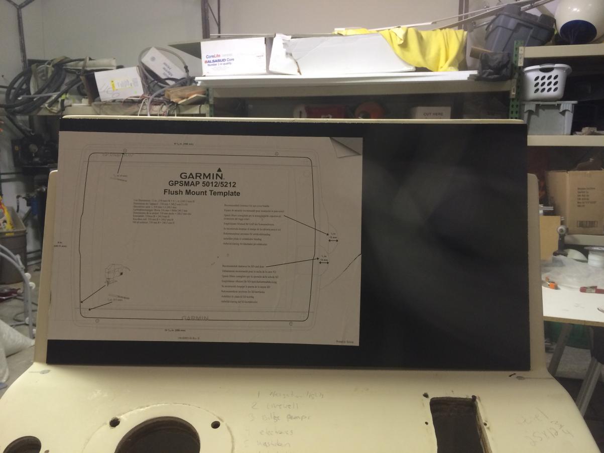

I got the electronics panel cut and fitted, do you think a 12" screen is too big?? haha
going with it, it will be awesome. also a icom 304 and a Jensen remote stereo head unit will fit nicely.
go big or go home.......
