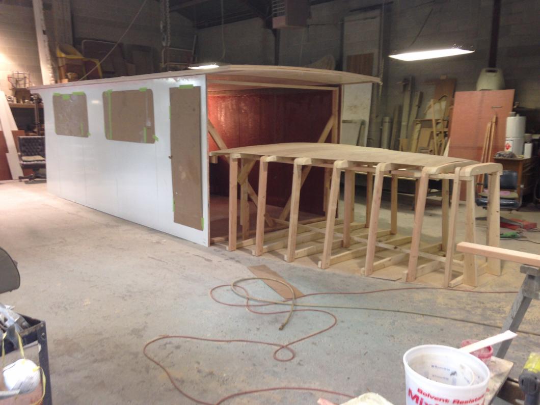

I volunteered to assist with a large project, which I cannot expand on until completion, but it is proving more of a build than originally bid on. The shop was empty Feb 15th, with little to show until two weeks ago.
