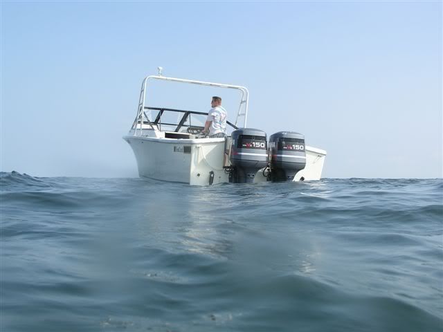

Put to boat in the water for the first time since I've owned it.
With 1 other person and 120 gallons (holds 1800, boat ran 50.5 mph WOT with 21's.
Gonna go to 19's due to load.
I have to finish quite a bit to complete her...but the power is complete.
Jason

Egg, Thanks for your comments. Took her out for a few hours this AM to dial in a few things. Anclote Area.
