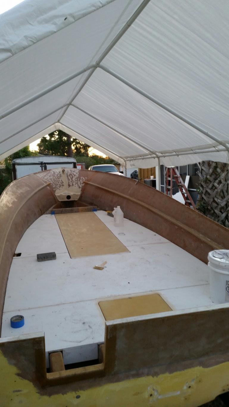

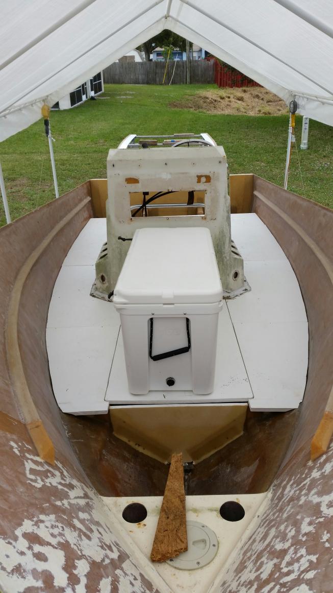

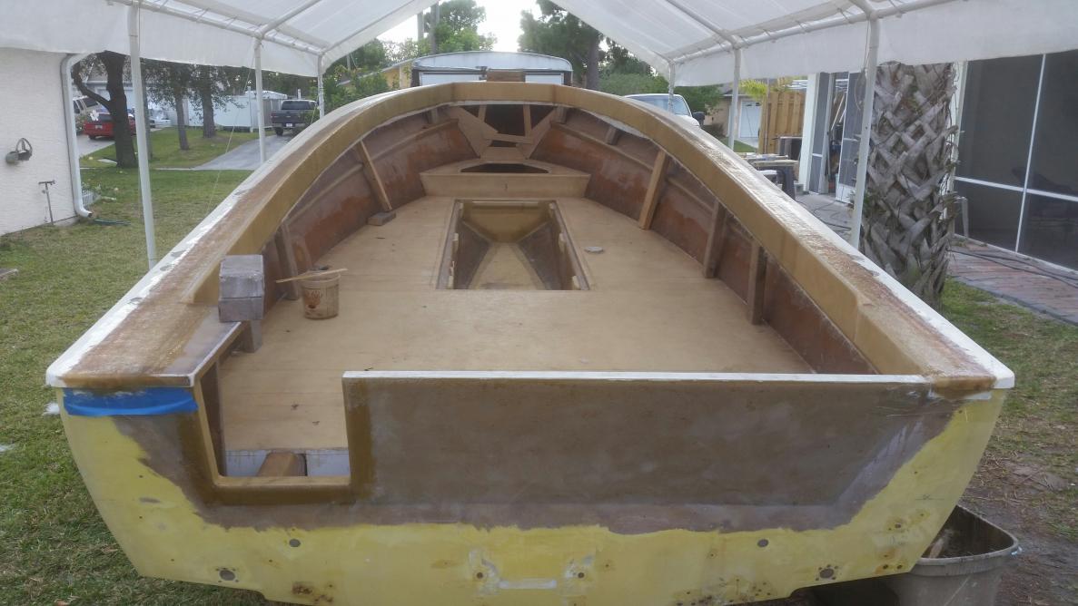

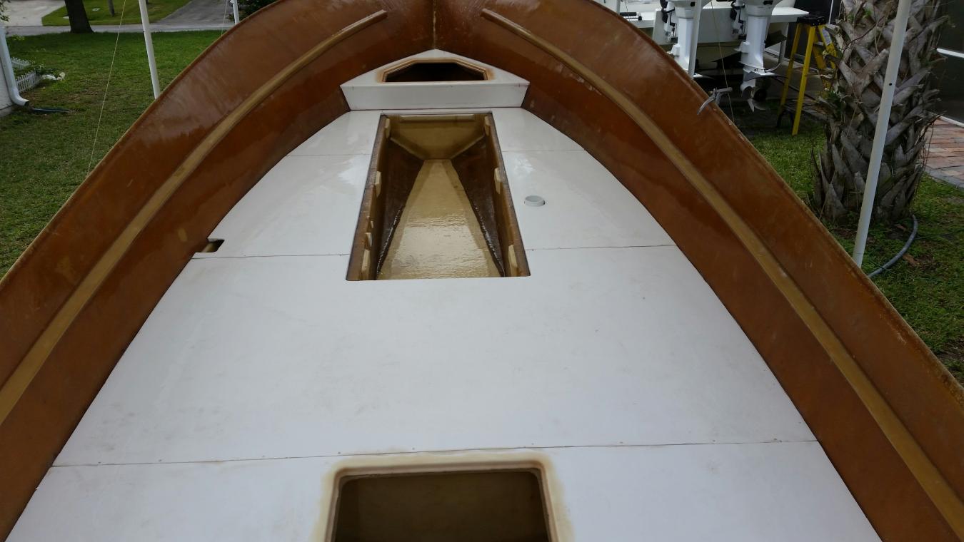

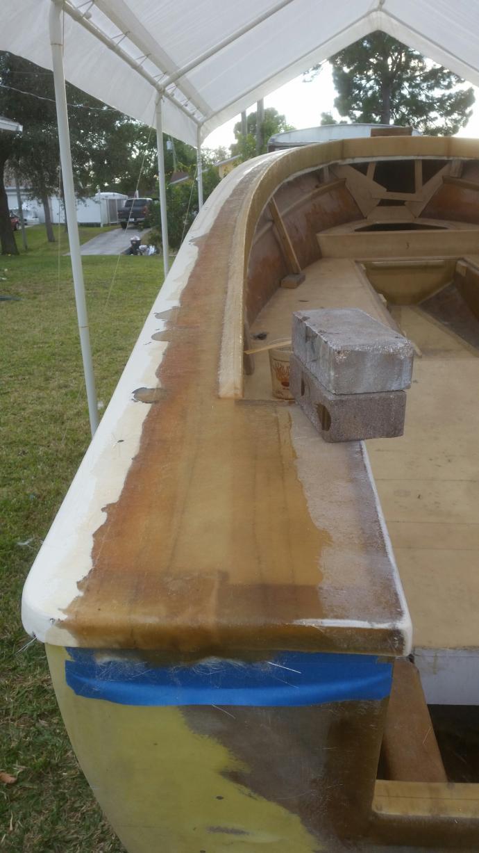

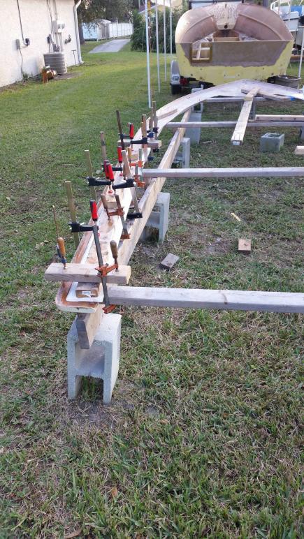

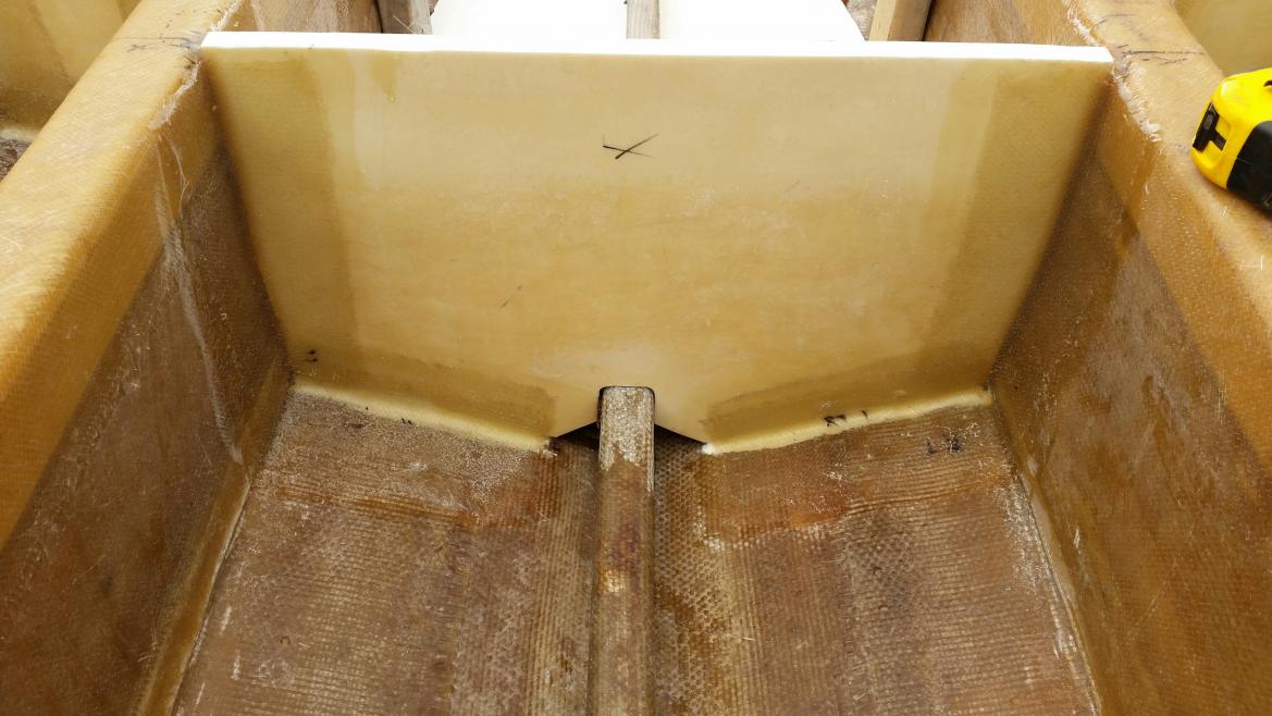

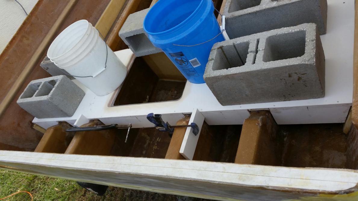

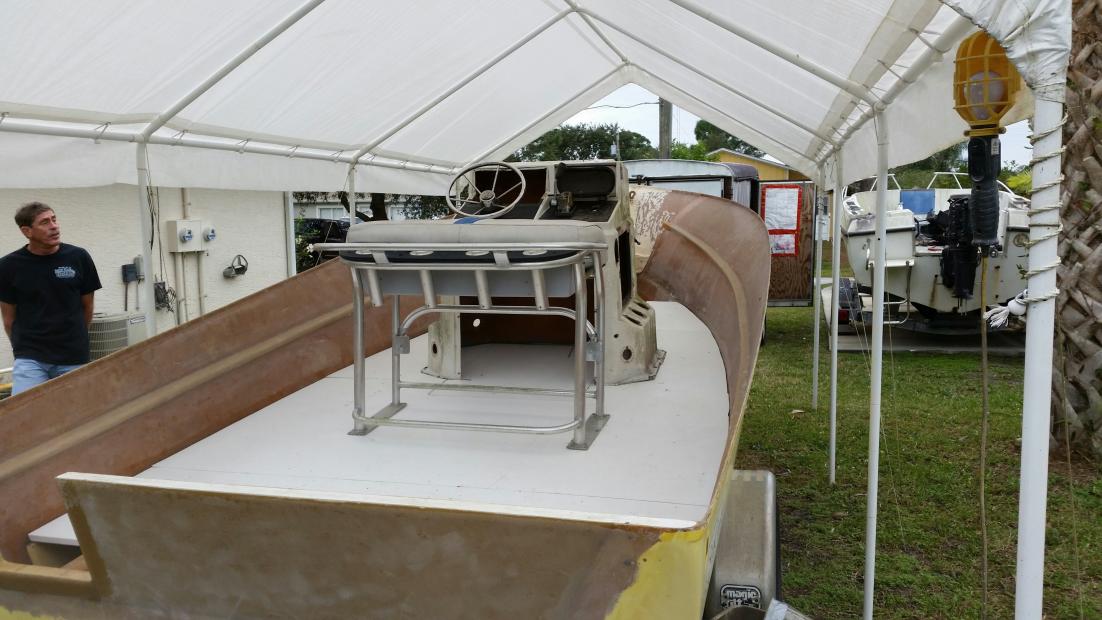

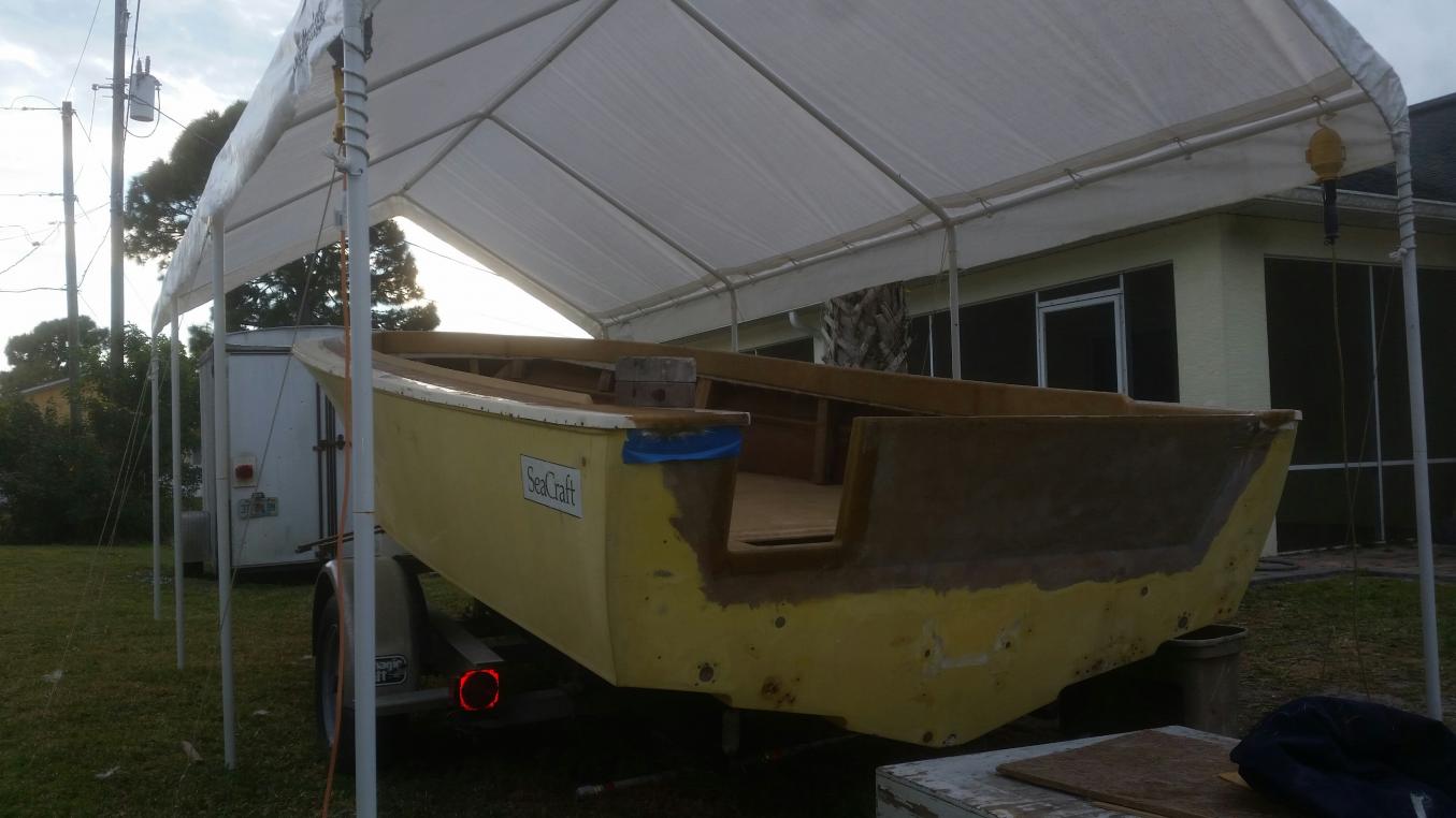

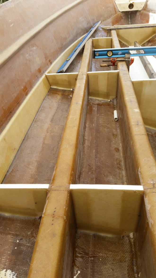

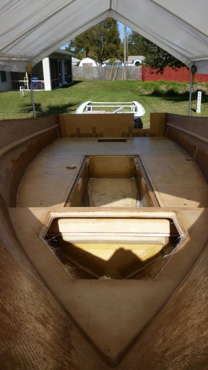

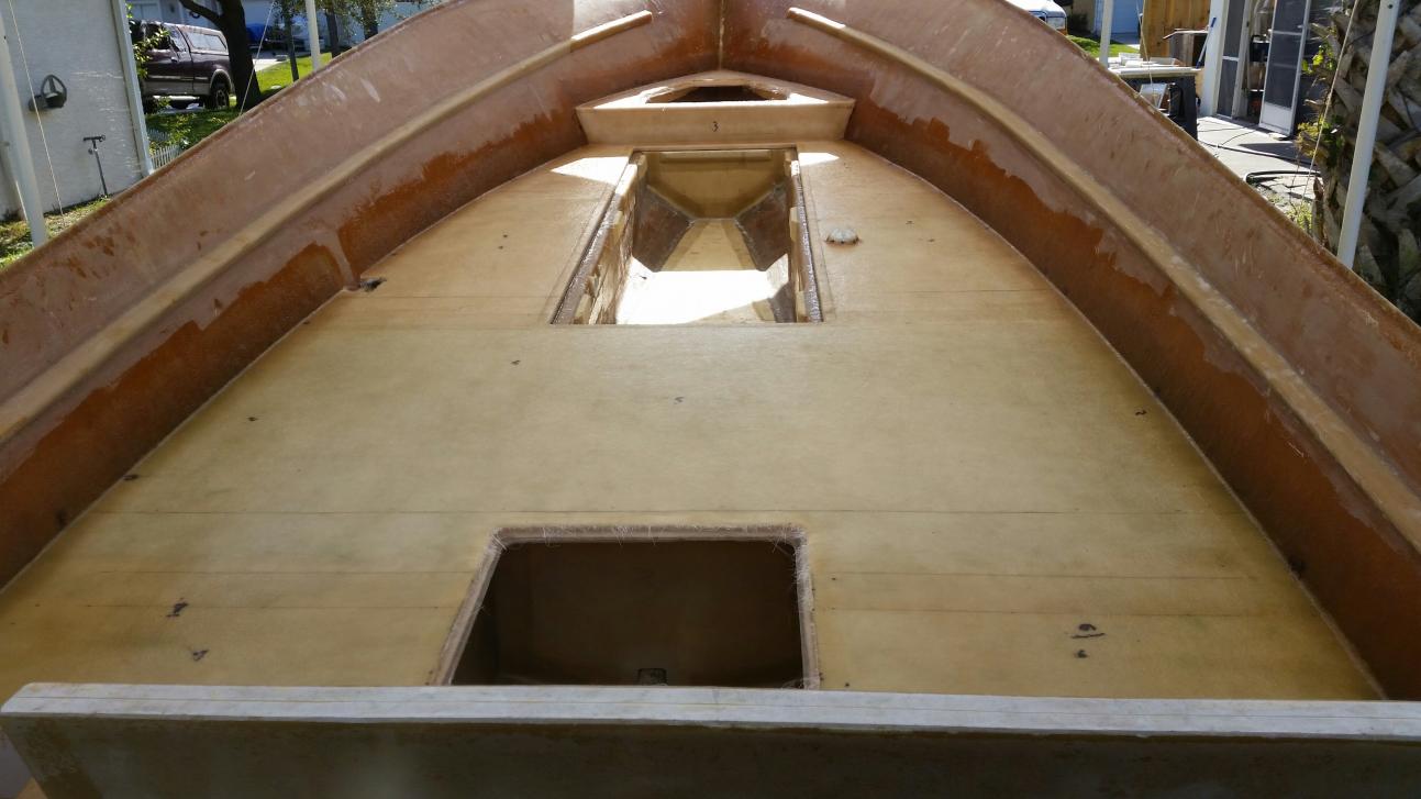

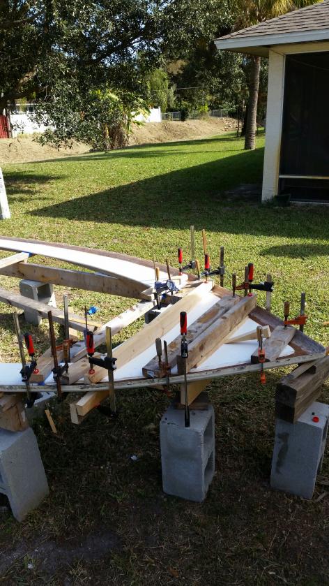

I haven't posted in awhile and have been busy. tightened up a bunch of loose ends before installing the floor. Put the floor down with arjay 7121, glassed in in, and started building the cap. Its flipped upsidedown right now and will get a couple layers of biaxial on the bottom.
