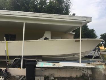

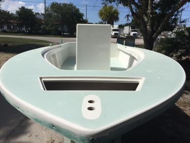

I got a lot done with the cooler weather. I sanded off all the epoxy primer from the floor in preparation for gelcoat. I should have used gelcoat when I laid up the floor in the first place. I tabbed the floor in with a nice radius. The inner transom wall was also tabbed in.
I prepped the center console for final install. It was made with a thin wall and had to be cored. I also gelcoated the inside. The bottom flange was trimmed and prepped to get glassed in.

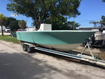

The current gelcoat was from the 80’s so it’s an almond color. I hate the almond and want white. Ideally everything white with the sides seafoam or teal. It will match the white Suzuki. The hull bottom will be abused because it will live on a trailer. I’ve been told paint or bottom paint will look like crap after the first year, gelcoat is the only way to go.
Option #1, The bottom of the hull is in good shaped and will only need minor gelcoat repair if I keep it almond. I would have to suck it up and paint the rest of the boat to match.
Option #2, I could re-gelcoat the bottom white but that will be more expensive
Option #3, I could paint the bottom with Awlgrip white
Option #4, bottom paint it white.
Option #5, I could leave the bottom almond gelcoat and paint the rest white with seafoam gunnels, would the shade difference be noticeable due to the different angles?
Am I missing something? Does Awlgrip hold up to trailering?
  #96
Old 04-01-2019, 09:39 AM

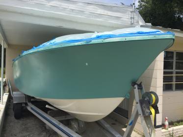

Here is what option 5 looks like....
