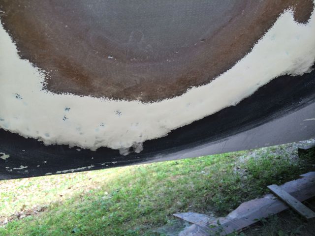

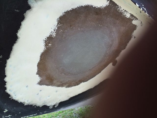

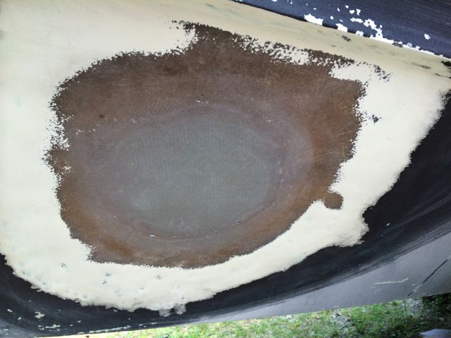

After some guide coat and sanding, the patch is okay enough to gelcoat for something that is below waterline and under antifouling paint. If I long board the gel coat, I don't think you would be able to tell it is there. There are a few voids at the layer overlaps, but I guess that will happen with upside down glassing. The gel coat filled them nicely- they were quite shallow.
That looks like a very high quality repair. Better than some "professional" repairs we have come across. Nice work
