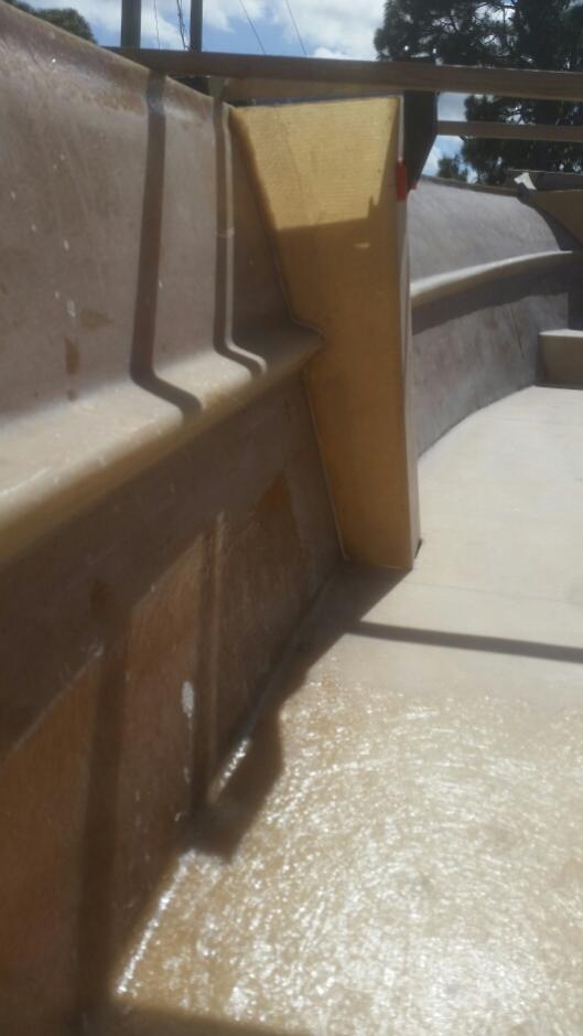

afish there are some thing that cant be taught and you got them. great work on the boat and don't worry about seafari guys, remember this forum is repairs and mods!
clean lay up and the work on the gunnel cap is clean

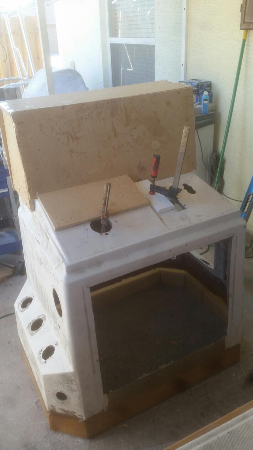

Posts: 108

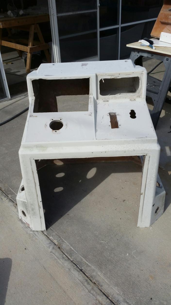

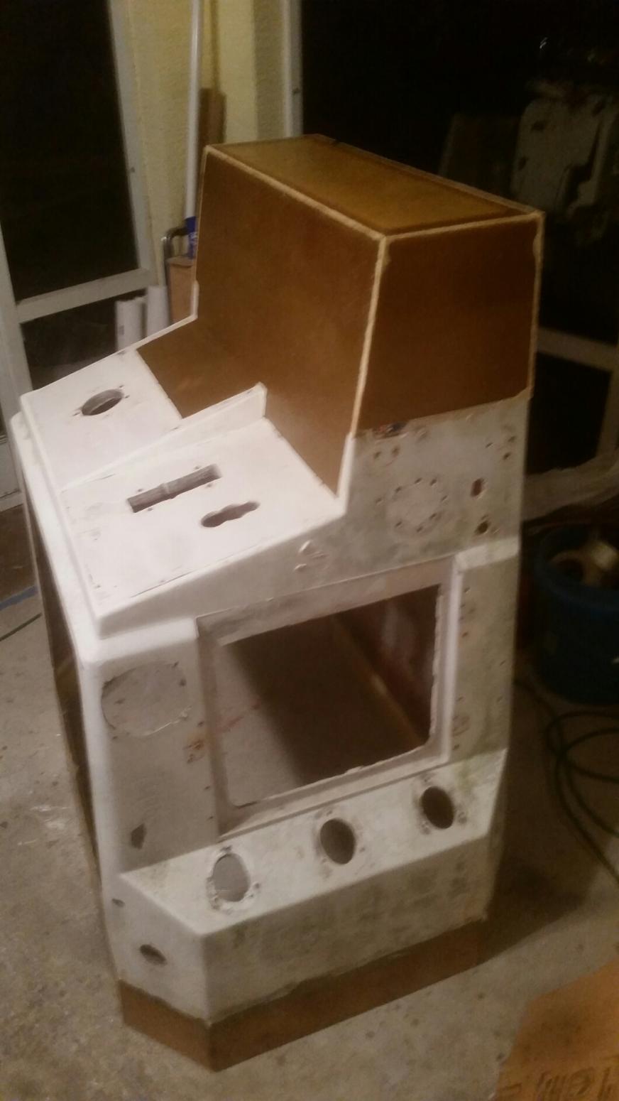

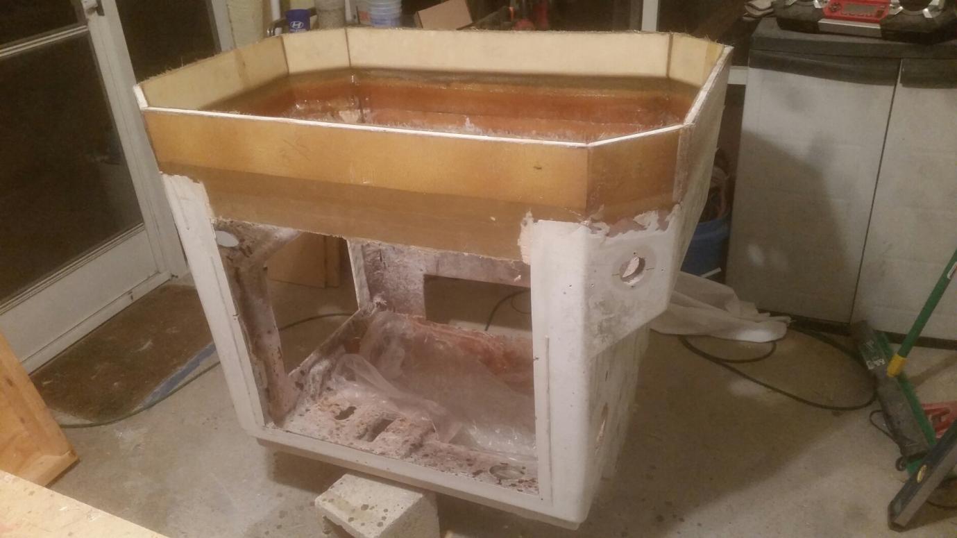

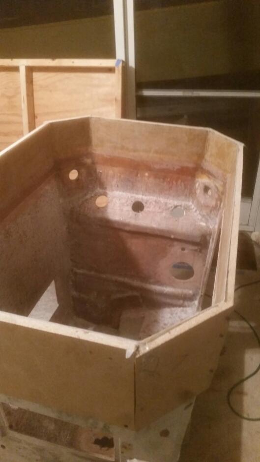

Alright finally back to work on this sucker! Got quite a bit done on the console while working midnights. Raised and cored the bottom. Changed the top to accommodate my electronics and other stuff.

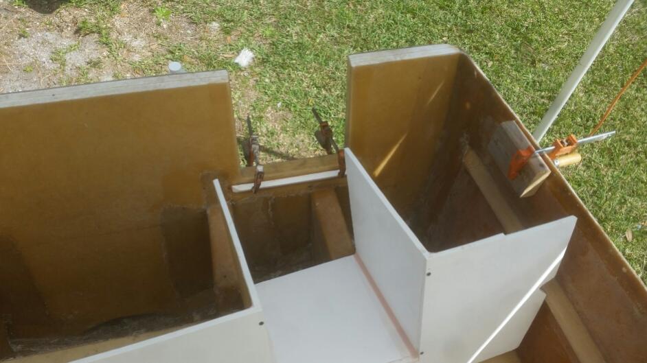

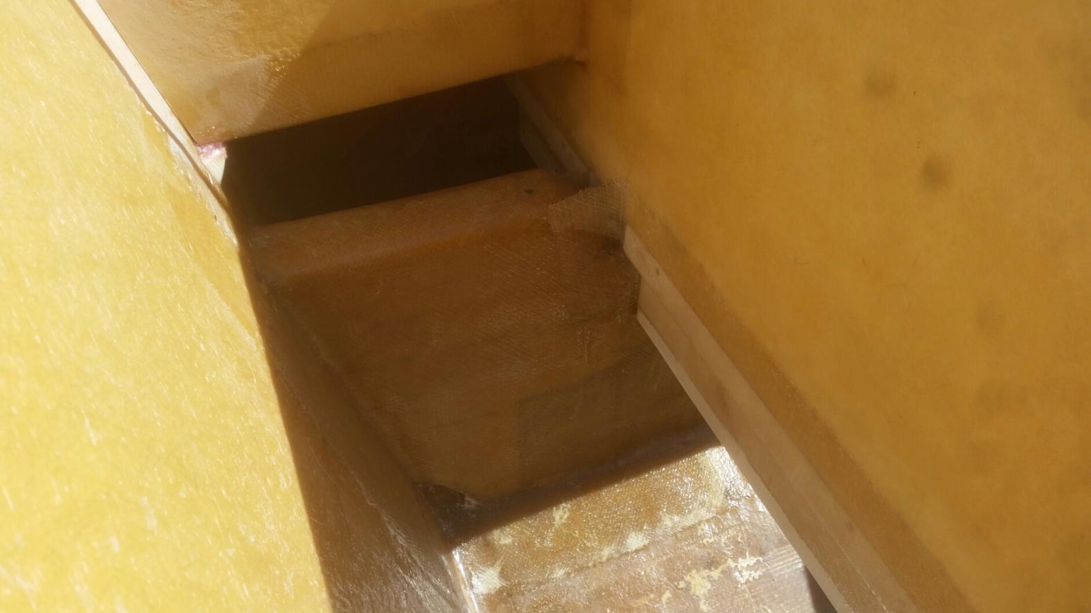

Posts: 108

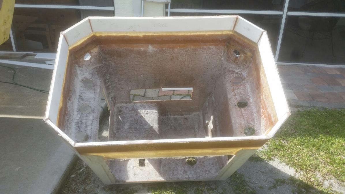

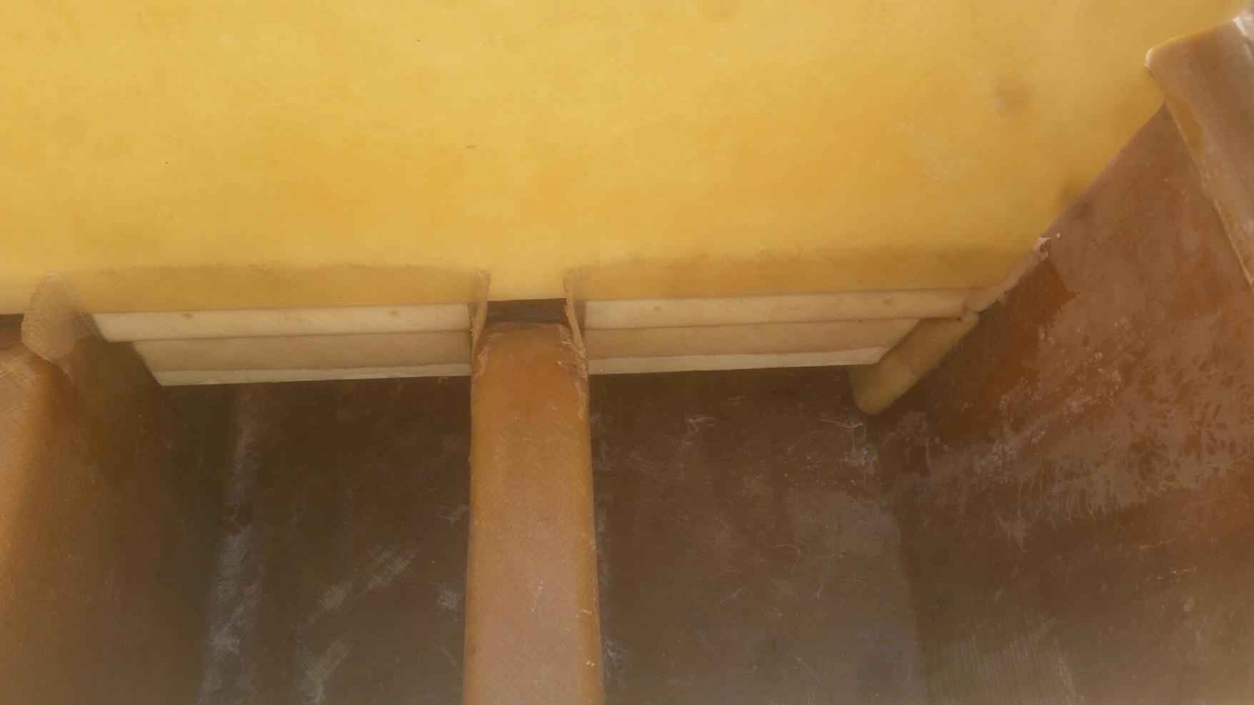

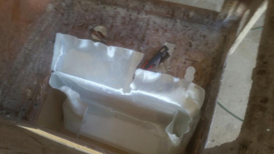

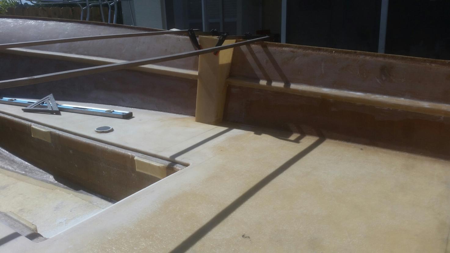

Finished installing the bulkheads and boxes for fuel fill lines. Also put a backing block for the d-ring.

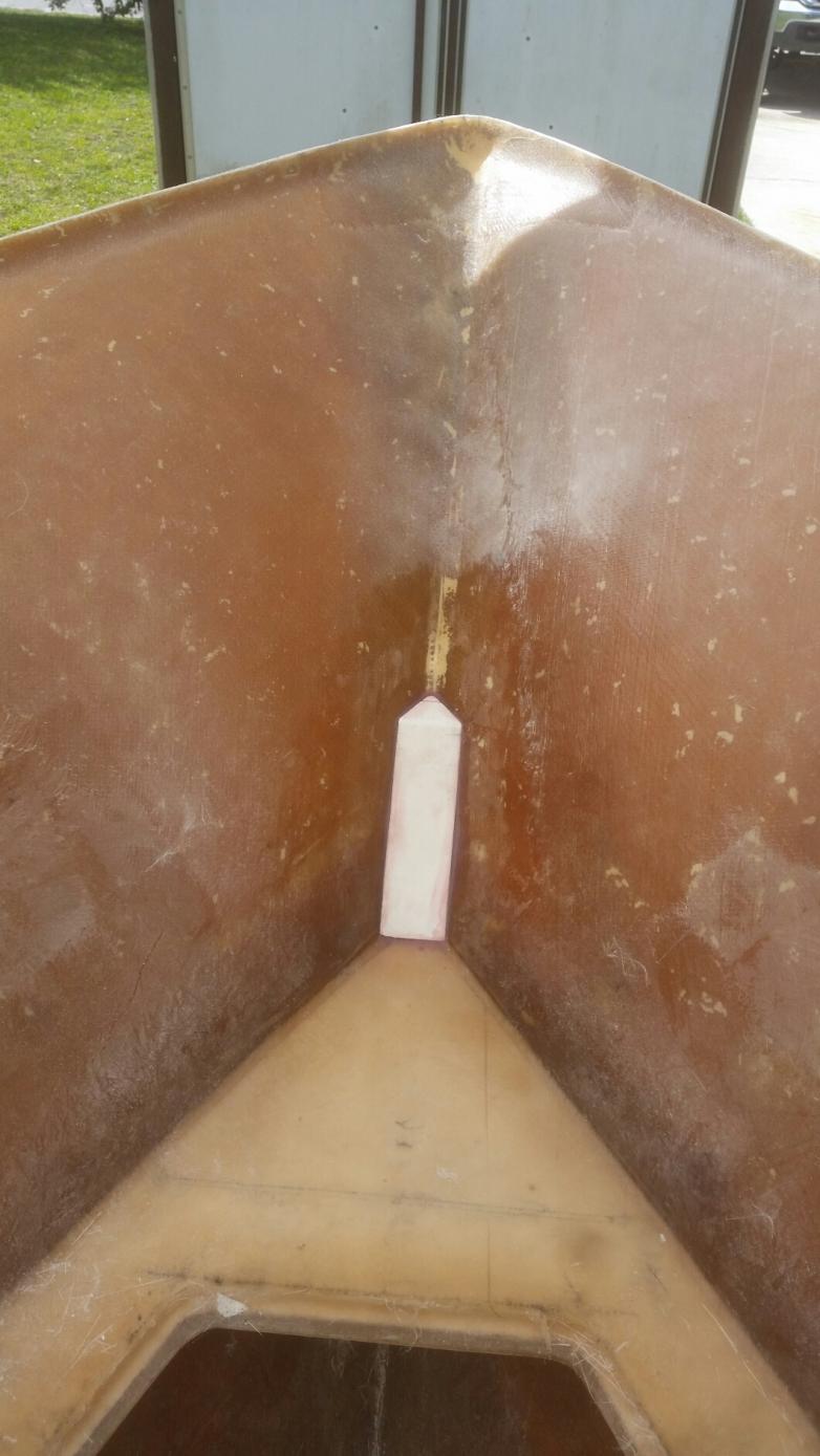

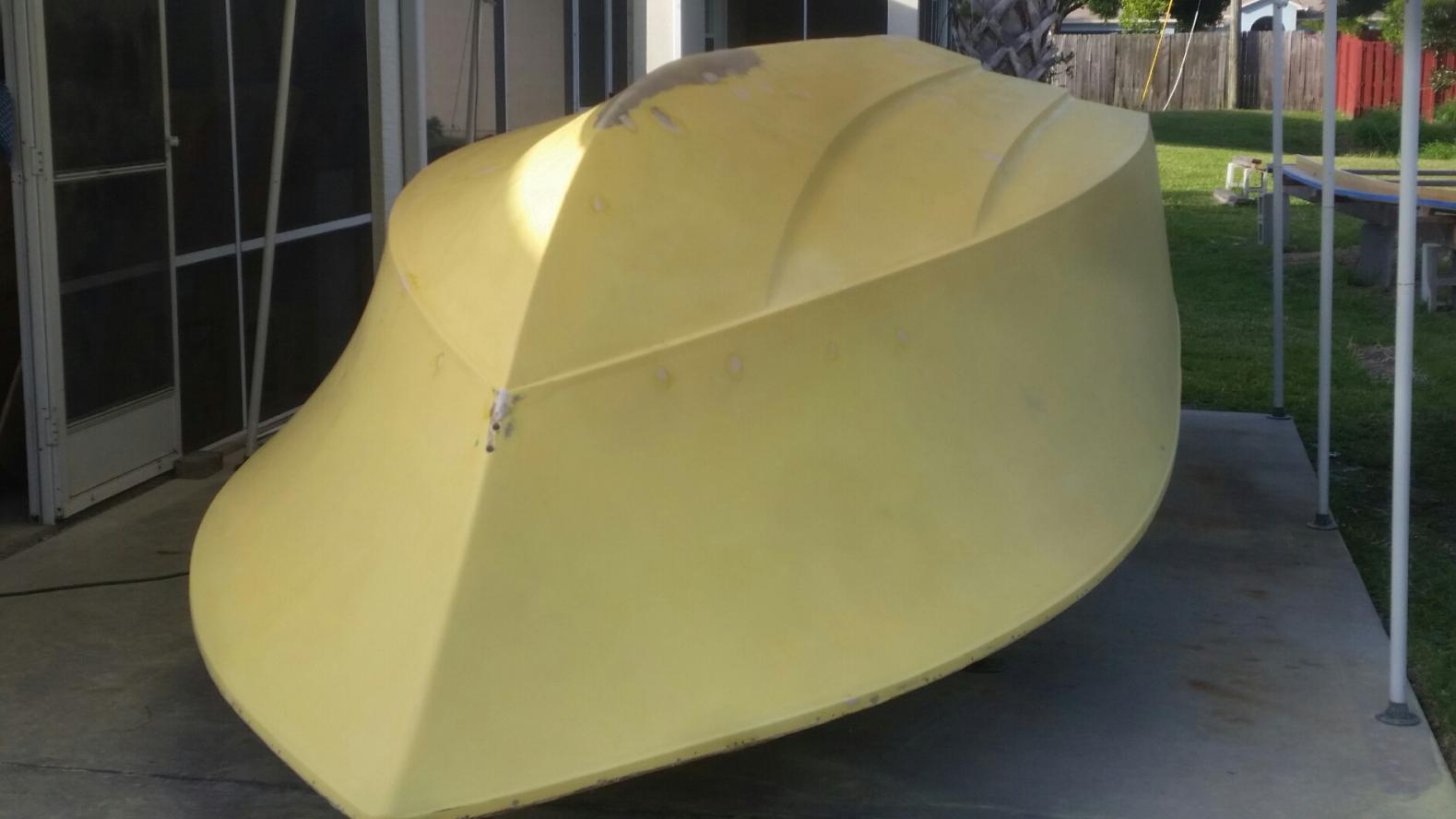

Posts: 108

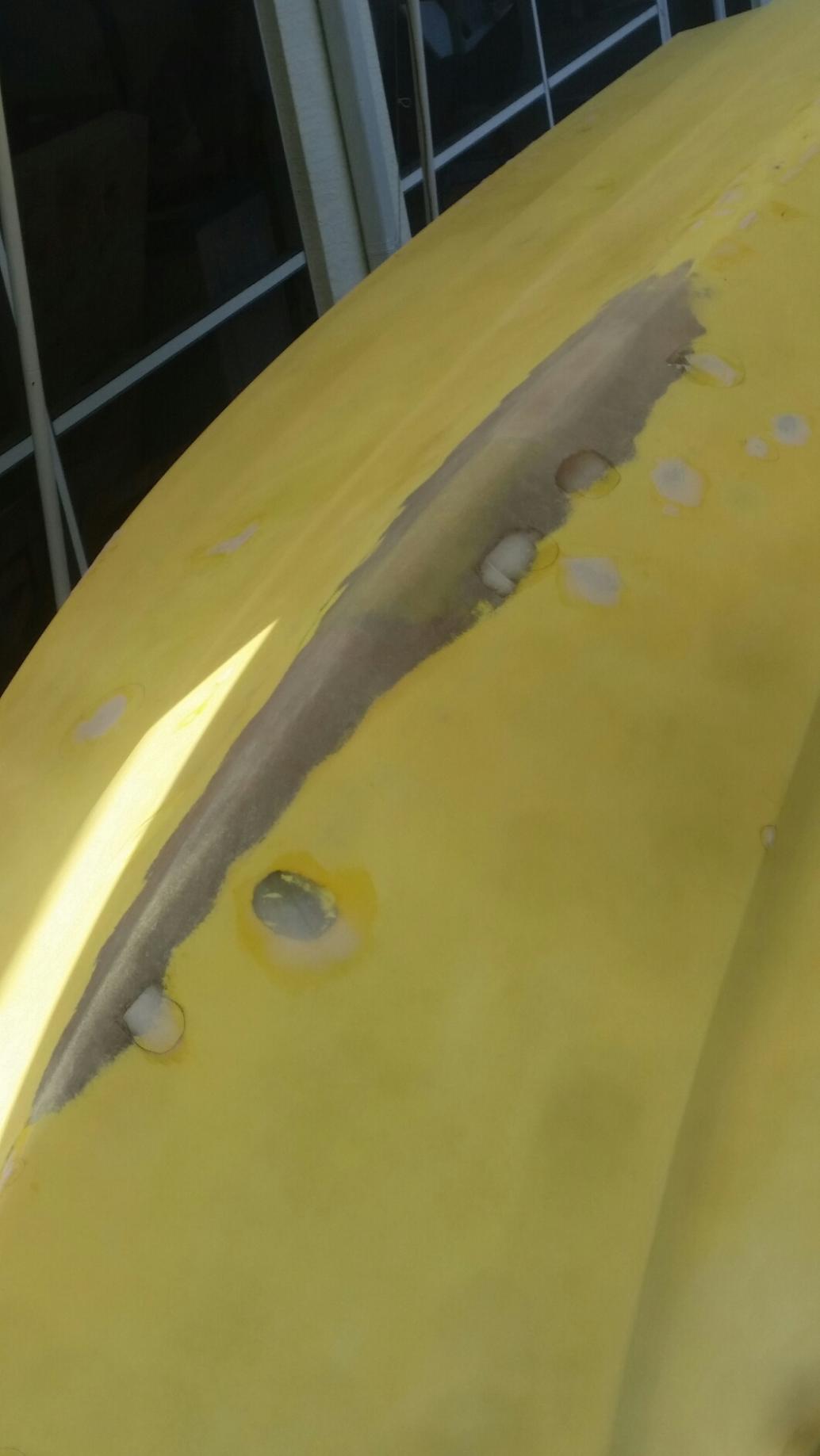

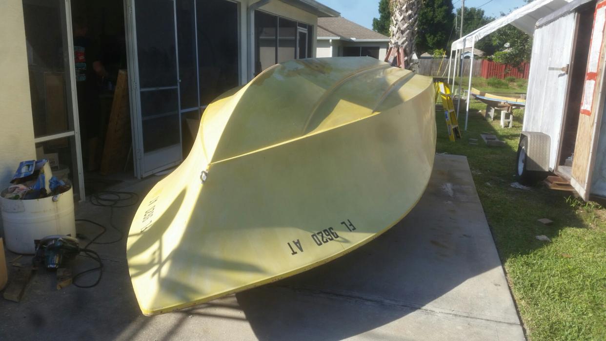

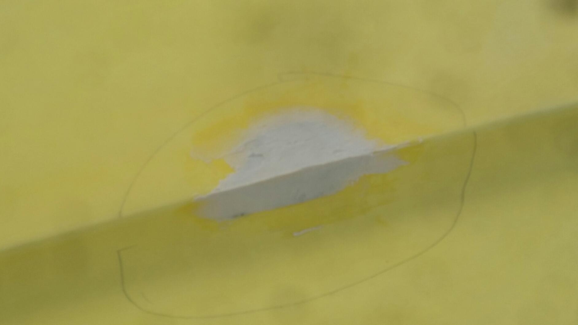

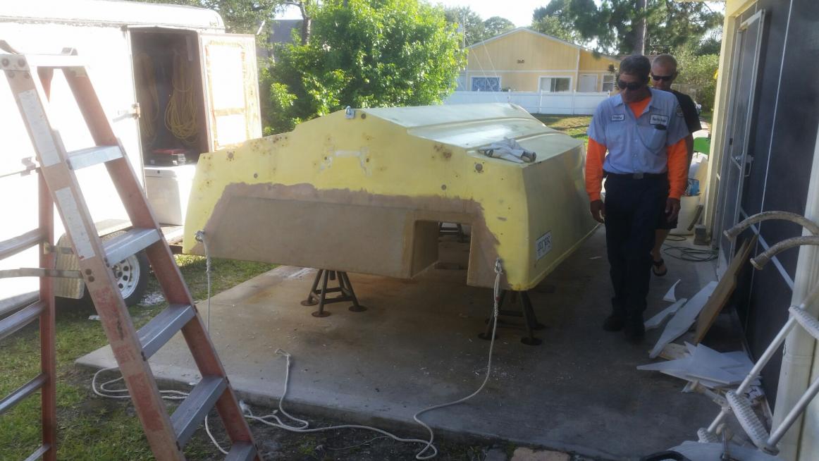

Used a crane to flip it over hokked to the front d-ring and an eye bolt in the drain plug hole. Worked pretty well. Couldn't manage to get any pics of the process. The keel damage was a bit worse than I originally thought and the repair that was done was even worse.

Posts: 108

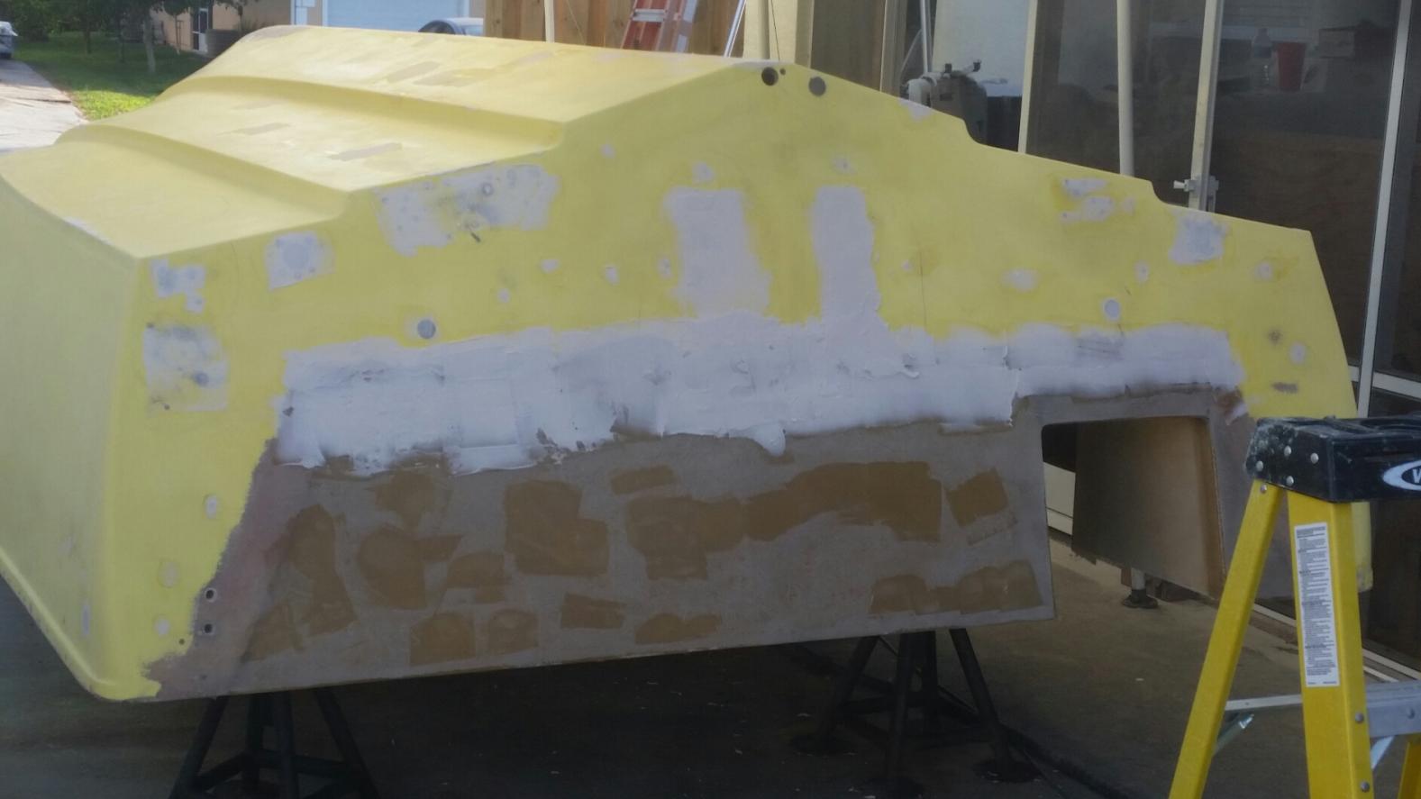

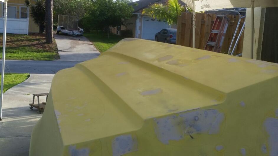

Got the old repair ginded out and put some fresh glass in and shaped pretty nicely. Also had a little repair to fix on one of the strakes. Sanded the entire hull once and filled all the imperfections with polysilk. Probably one more round of sanding and filling till I will feel comfortable to start rolling on the new gelcoat.

Posts: 161
The boat is coming out great. Have you thought about spraying the gel coat? You will save tens of hours of sanding if you spray over rolling. Plus it's a lot easier to get even coverage spraying then rolling. You can get a cheap gun from Harbor Freight that will work good. I spray it all the time with some duratec or patch aid mixed in. You don't need a huge compressor either. I have a craftsman that I think is a 30 gallon and it keeps up fine. It will really save you tons of time. Keep up the good work.
