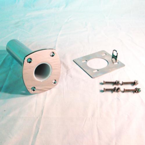

Gearing up the seacraft for attempts at swordfishing. Only changes I need to make are hooking up the second fuel tank (have used boat for a year without ever burning more than 30 gallons at a time), and to add a larger swivel base rod holder for the big rod. Gunnels will also be reinforced to better take the loads of the big rod.
Here is the large swivel base rod holder, sitting in a piece of AL that will become the backing plate.
We I put the rod in a 15 degree holder, set drag to 30 lbs. and pull on the line, the gunnels flex a little. Nothing is going to break, but I dont like the see the flexing, so Im going to add a little piece to the sides of the hull and the inside of the coaming, basically box it. Will be hidden from view, but it will stiffen up the area around the new rod holder

You could try a different rod holder to help with the flexing issues. The Lees are great but they only have 3 bolt pattern and less surface area on the top flange. Your flexing issue is coming from the 3 bolt pattern. You shouldn't have to box in your gunwales and coaming pads. In my opinion the bolt holes are to far forward on the lees. When you mounted it I bet you saw the back of the rod holder lifting up? Same thing happened to me and I switched to LD Marine rod holders. They have 4 bolt pattern and a larger top flange which distributes the pressure put on the rod holder buy the rod. This is the same rod holder used by all the giant bluefin tuna fisherman. I've fought bluefin tuna up to 80" so far with mine and there hasn't been any flexing issues.

The coaming actually flexes out, no flexing between rod holder and the cap. No trying to argue, but should not matter how many holes, leverage is same. BTW, the flexing was with a smaller/shorter holder, the new one is several inches deeper, so you might be on to something there. The new deeper seat may reduce the leverage enough so there is no flexing of gunnels. Think I will mount it first with the backing plate to see, before making the gusset
