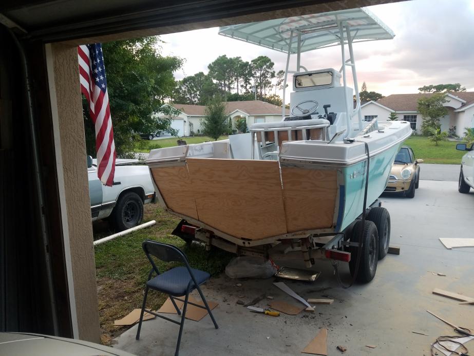

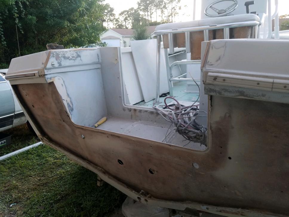

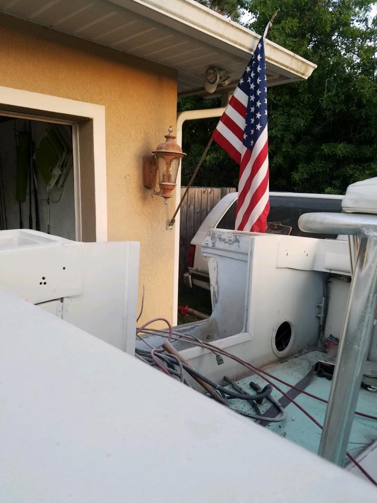

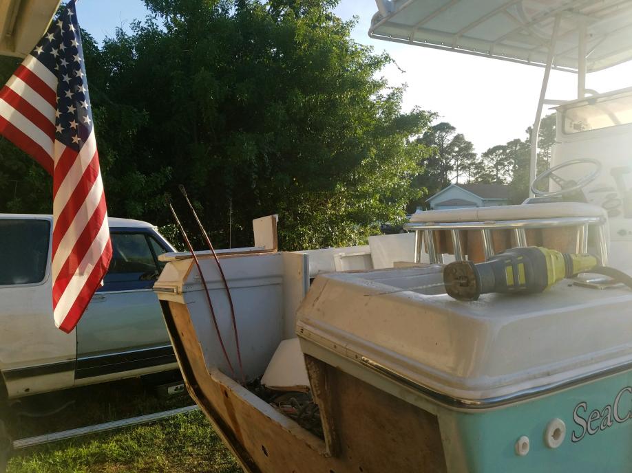

Removed upper portion of splashwell/cutting board. Will start making inserts for transom later this week. I might swing by Marine Connection Liquidators and see if they have a pre-made insert that I can use for the new live well

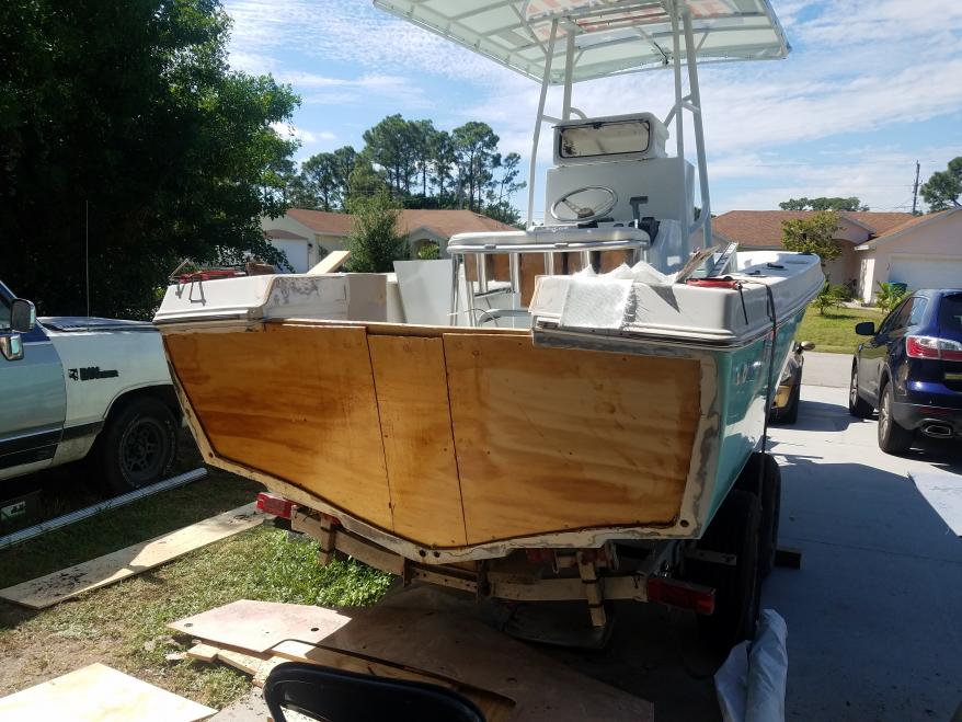

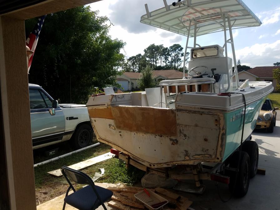

Cutting first layer of plywood and ran out of daylight
  #145
Old 10-27-2018, 04:50 PM
Join Date: Mar 2018
Posts: 318
Laminated both layers of plywood and started glassing it all in. Ran out of fiberglass and ran out of energy about the same time

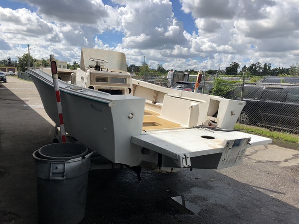

hopefully not jinxing myself but I think I just scored a stainless marine bracket with swim platform for $500! Guy was selling a project boat with it on there and I asked if he wanted to part with it. He said sure, for $500!
Going to swing by his place later this afternoon to close the deal
  #147
Old 11-06-2018, 05:30 PM
Join Date: Mar 2018
Posts: 318
Deal closed on the bracket. He is going to pull it off in the am for me and I will pck it up tomorrow

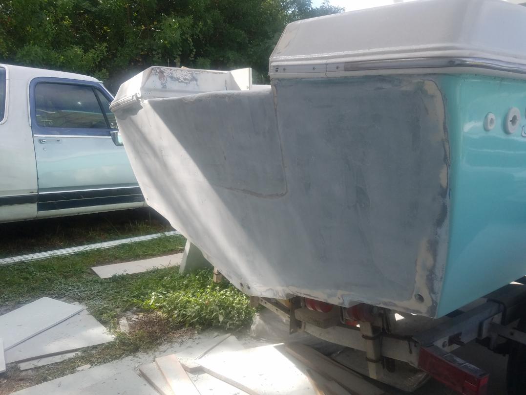

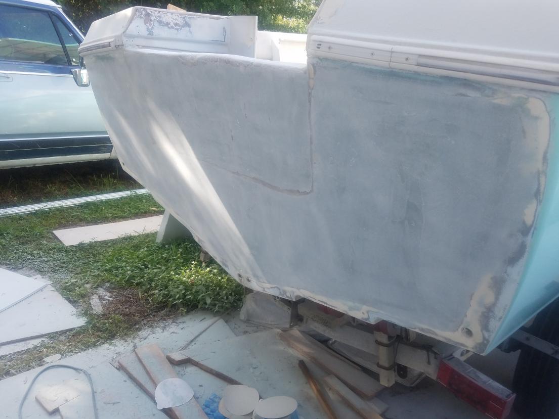

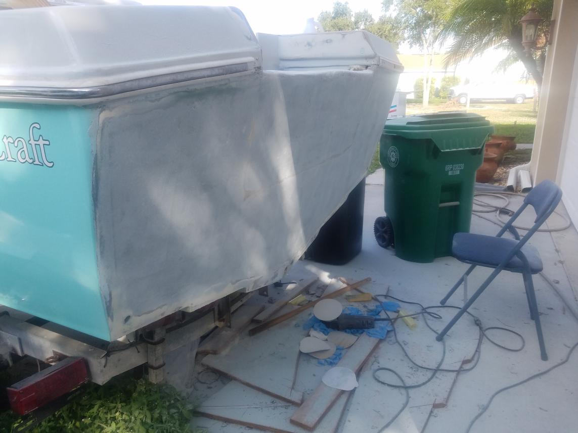

Finally got s chance to do some more glass work this weekend. Finished up with couple of more layers where the open transom used to be and then today started smoothing things out
