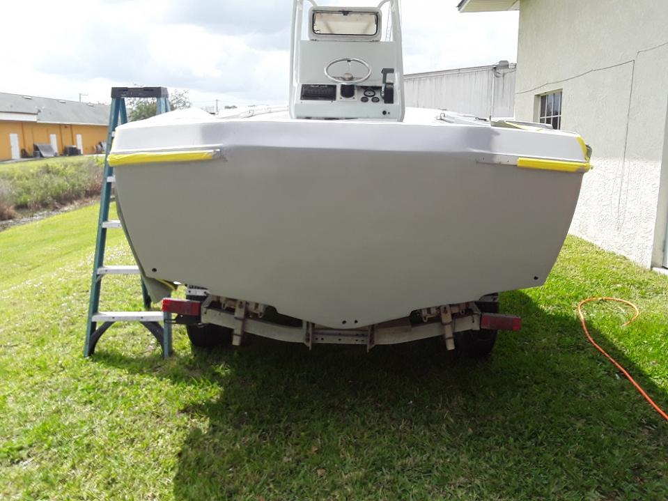

Did not want to let the motor situation get me down so I did a little work on her today.
Did some more sanding and the put a couple of nice full coats of primer on her to help reveal any spots that need some attention still. Based on what I am seeing, I should have it ready for paint in a day or two now. I would say it might be ready later today but the weather does not look conducive to keeping at it today.
Happy with today's progress.

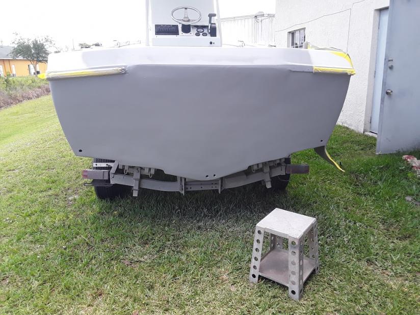

I think she is finally just about ready for paint!

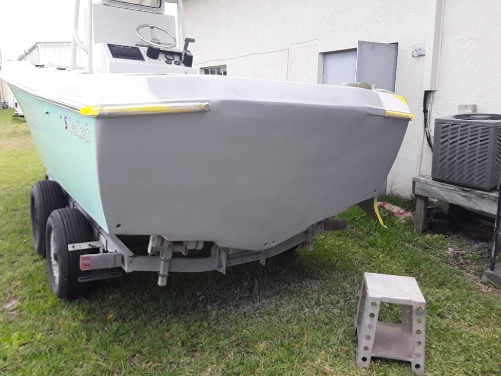

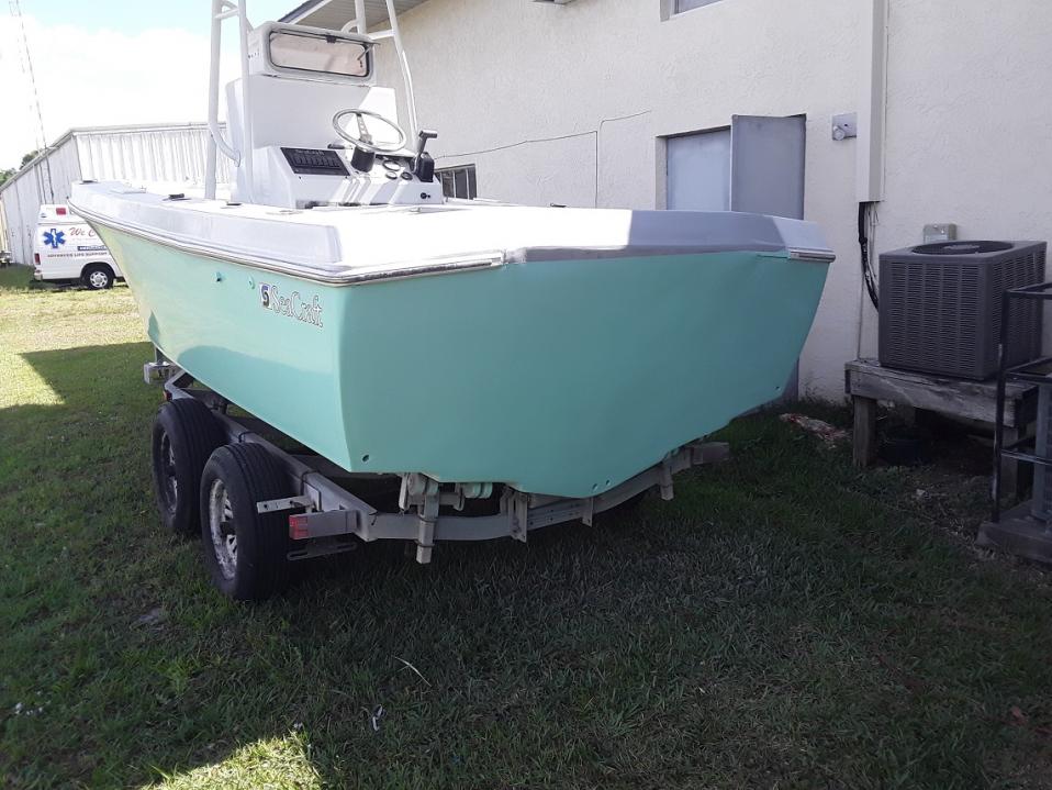

Well, just finished shooting the transom with some color. Overall pretty happy with it although it was a little bit windy and that made it difficult to get a good gloss on her.
After I shoot the cap later this week, I think I will concentrate on cutting the hole for the live well and the plumbing it in. After that, time to hang the bracket!

capt terry - the paint is Nason industrial enamel., same as I used on the sides. The gun is a harbor fright HVLP cheapy gun I got for $9.95
FWIW - I have painted dozens of classic muscle cars & trucks, and several boats and have found that I can pretty much shoot any gun as long as it has been properly cleaned etc. especially with solid colors. Metallics are a little more tricky

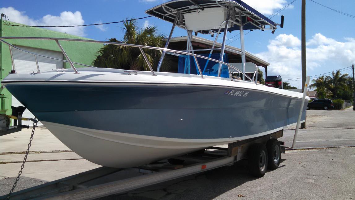

This Angler was one of my last boat projects before this one
