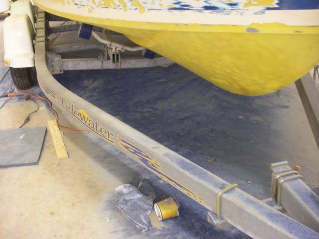

Nice pics, I am interested in the blast work for the bottom. How is it priced? How long does it take? Can they control the amount of paint they remove?
Old 01-07-2008, 01:15 AM
Location: NJ shore
Posts: 485
Default Re: Started 20' upgrade and restore
et 23 I paid $30 a foot which was fair. I had estimates as high as 50 a foot They take all the bottom paint off to the original gelcoat. The only paint he said he has a problem with is the barrier coat epoxy.

That sounds reasonable, I use particle blasting for rotors and they are way more expensive. Some of the media they use remove metal. I will look into this as an alternative. I have used "Polar Blast" as few times but they did not work on what I was trying to clean.
Old 01-07-2008, 08:44 AM
I decided to have the bottom soda blasted and they came on saturday. I took the boat off the trailer and blocked so they could blast it. I have sanded and grinded alot of bottoms and I figured I would give this a try and I am glad I did it was the best money ever spent.
WOW...it looks great. They actually came out to your place? I am getting my 21 done this week. I have to take the boat to a yard, pay the yard to put on stands, and then pay $35 per foot. I guess when you live in an area that is densely populated the services are better.
