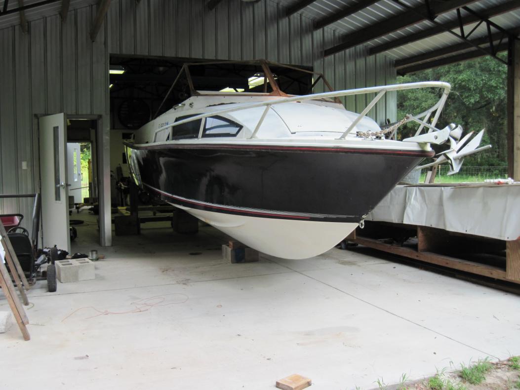

Next was to put block supports under the forward keel, stick braces under the sides so it wouldn't roll over, move the gantry back to the transom, lift it up, slide the dolly under, and set her down. I cleated some supports to the dolly, and here she is.

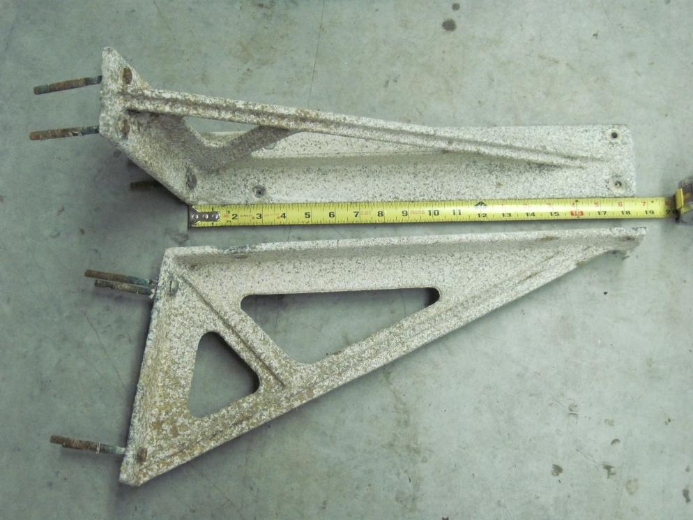

I have a question. What did your swim platform brackets look like? mine are quite small and I'm wondering if they provide enough support? My boat came with two ss turn buckle cables that attached to the swim platform and then to the rear towing eye on the transom and I don't really want to put that back on the boat.
They're cast aluminum. I'll shoot a picture and post it tonight with dimensions. They don't quite match the transom angle so they were shimmed to make the platform level.

Here are the swim platform brackets:
As you can see, they weren't painted and are pretty heavily corroded. If I decide to re-use them, I'll need to sandblast and powder coat them. The length of the top flange is about 18 1/2". The transom flange is about 8" long. The flange width is 3 1/4". There were four brackets supporting the platform and it was very solid.

Thanks Dave
Mine are ss and they are 14"x7" I'm waiting on my trim tabs so I can mount the swim platform

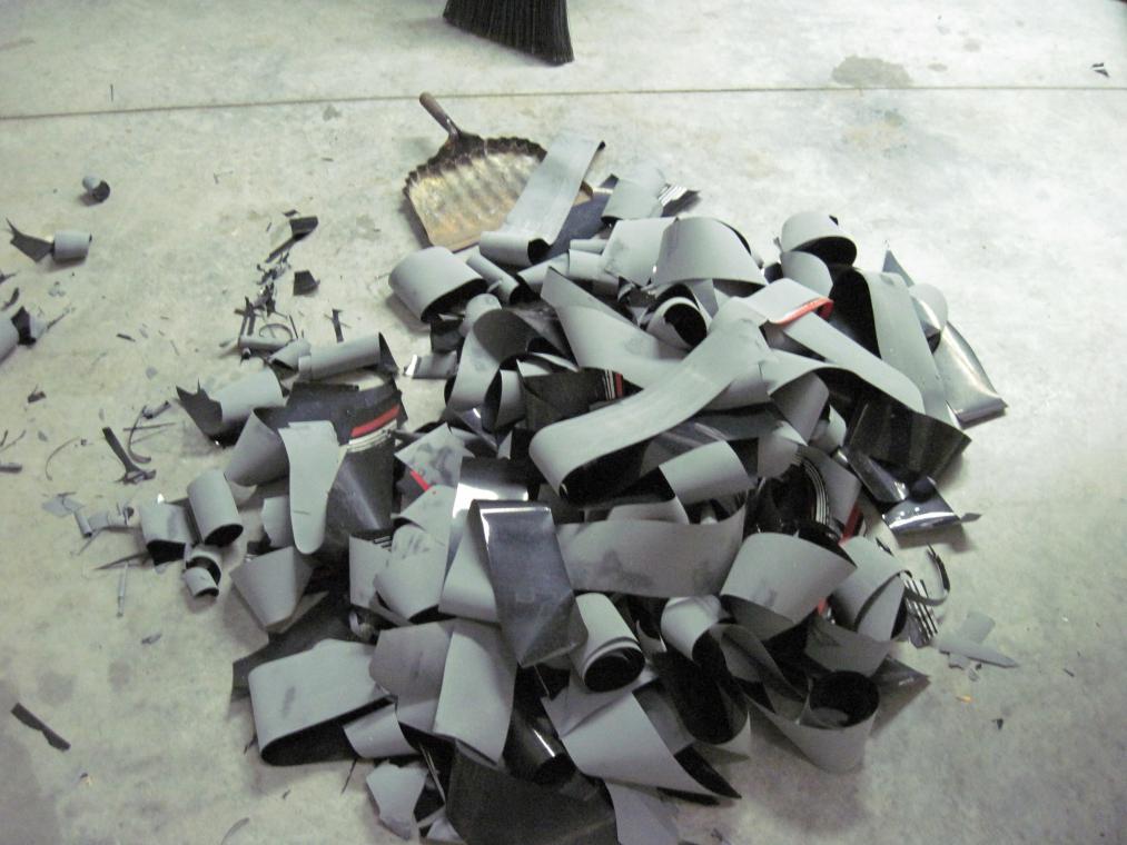

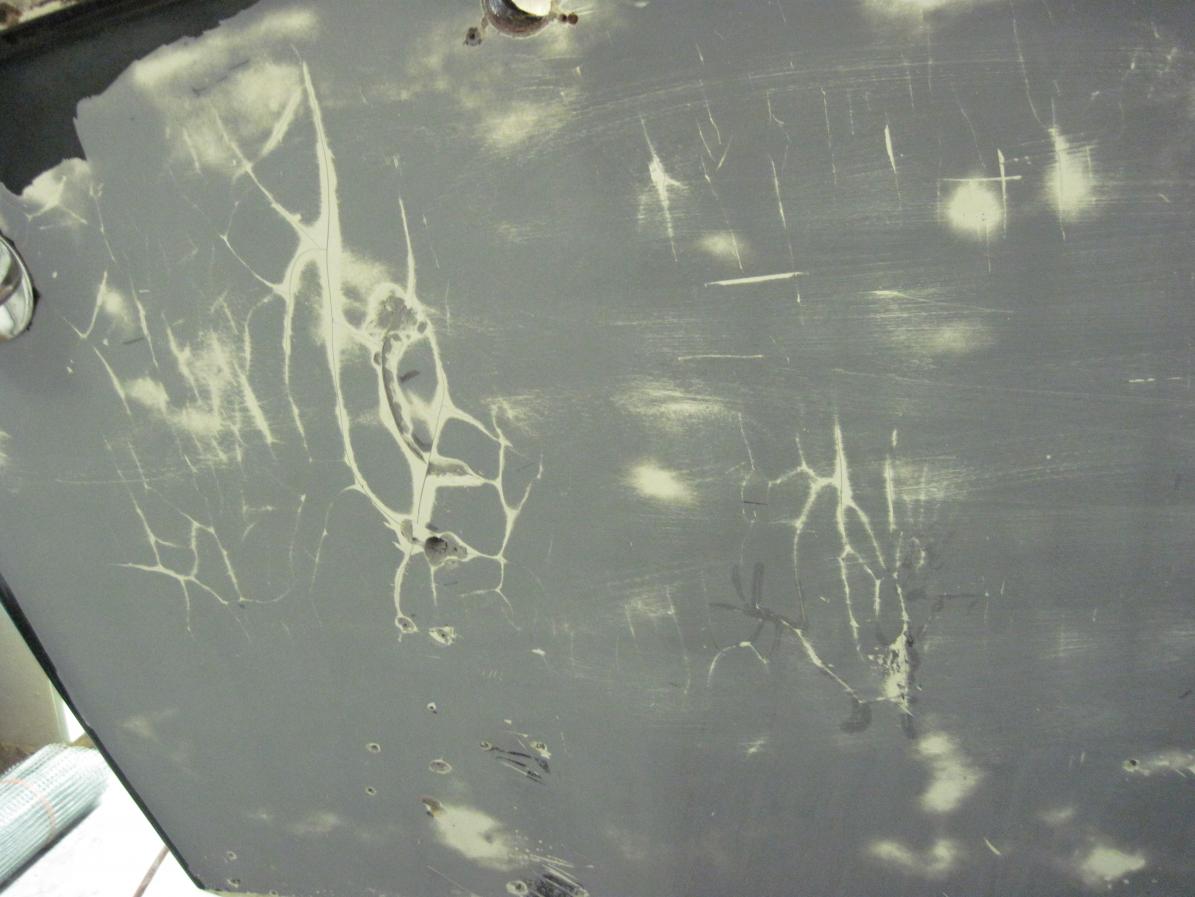

Now, back to work. The transom on my boat was redone in '95. There were areas with serious spider cracks that I needed to investigate. After chipping at it a little, it looks like they used gelcoat to do the fairing on the outside. It's more than 1/8" thick where the spider cracks occur. I'll grind it out and fair it back, hopefully this weekend. Anyway, I knew I would have to strip the paint off the transom to repair the spider cracks. I bought some high dollar eco-friendly paint stripper to get the paint off. I put some on a 6" x 6" test patch and let it sit for about thirty six hours. It barely touched the paint. I got out the scraper and managed to peel it off. So Tuesday after work, I went out to the shop to slather the whole transom with paint remover. To prep for the paint remover, I took the scraper to the aluminum oxide and 5200 left behind when I pulled the swim platform brackets. Well, some paint came off with it. So I kept going. It looks like when they did the paint job, they may have used gray automotive sanding primer. The finish paint film was tough, but once I got the scraper under it, the primer separated easily. Too easily. I had the whole transom stripped in about 15 minutes. Here's the area with the worst spider cracks:
So I thought to myself, I don't really like this black paint job. All the nicks and scrapes show the original gelcoat. It was peeling and chipping at the chine, and I guess I figured out why. The primer wasn't what it should be. So last night I stripped the starboard side. In less than an hour. It was like peeling a cucumber. Tonight I did the port side. Here's the "before" pic:
Here's the after:
And the pile of paint strips:
Now, I know I've opened a can of worms, and most of the prep work is still ahead of me, but this is the way I wanted to go with it anyway. I'm glad the paint removal turned out to be way easier than I had hoped.
