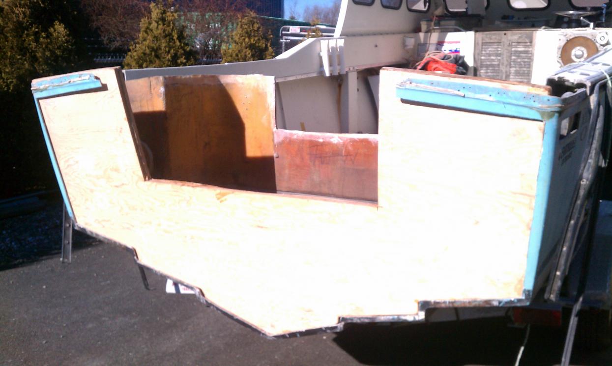

Baitwell prep
Old 01-15-2012, 02:21 PM
Location: Fairhaven Mass
Posts: 583
that looks like a big prodject. where are you in ma. i'd like to stop by and see this. been thinking of doing my 20 fter.
Fairhaven Mass let me know if you want to check it out. I am laying it all up this weekend coming up.

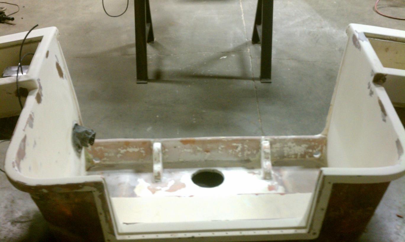

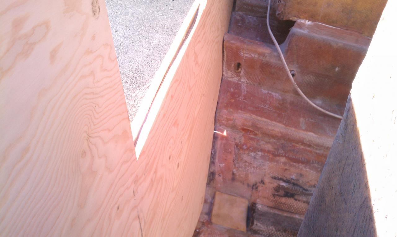

Transom cutout ready for glass this weekend
Old 01-19-2012, 08:42 AM
Location: Greater Boston
Posts: 1,117
Did you remove the inner and outer skins of the transom? It is hard for me to tell from the pictures.
Old 01-19-2012, 10:04 AM
Posts: 583
Yes I did but that wasn't the plan.

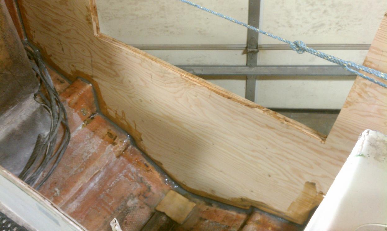

Started chopped fibers
