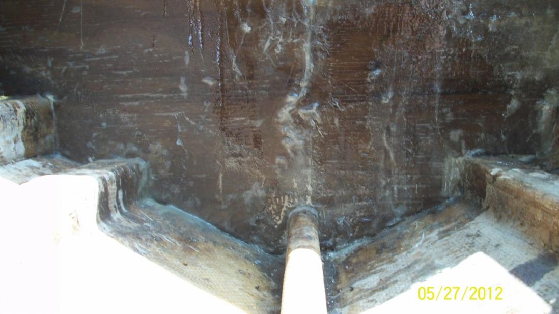

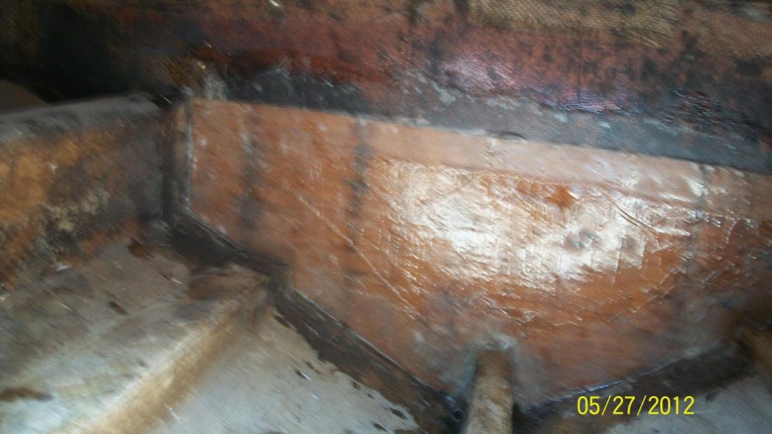

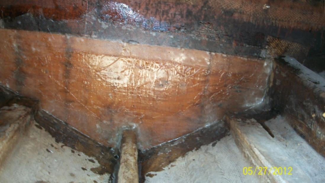

well it took all weekend and alot of sweat but I got the bulkhead walls and gas tank compartment floor in and glassed with exoxy, and I didbt get any epoxy in My hair{i wore a shower cap!!} I added the 3rd wall under the cabin floor just foward of where the cabin door is, I cut a 8" hole in the floor to access the froward side of the wall and Im going to install a round deck plate to cover the hole, there is already one in the step down area so I think it will look just fine. Now on to the gas tanks, I found a local guy who had some .125 5025 4x10 alum sheets that I picked up for a hundred dollars each . My metal fabrication freind is going to build me some new tanks the exact size that came out .
