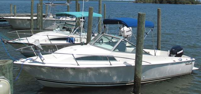

Having a hawse pipe over the anchor locker and then having the anchor either in chocks on deck or on a roller bracket makes anchoring a piece of cake! If you install a roller bracket and center cleat, you should probably put some reinforcement under the deck because the bracket can put some serious loads on the deck if you anchor offshore in rough conditions, which I have done when diving. Here's a post of the installation I did: http://www.classicseacraft.com/commu...anchor+bracket
Second pic shows another creative style of anchor bracket!
Gezzz Denny, What the heck kind of Kelly Johnson Skunkworks, Pratt and Whitney Design engineer are ya'? That there is an 81 millimeter mortar tube Dougie has disguised as a Bruce Anchor holder. A couple of air burst frag rounds and those Pesky Inboard Guys leave you alone when yur sittin on a good dive spot.
Plus when Dougie goes to the Anna Maria Yacht Club fer brunch, he can't harpoon the Admiral's Garwood with his anchor pok'in out in the front and make it look like he drug a Chain Saw across the transom mahogany. Sometimes I think he operates the boat by Braille!

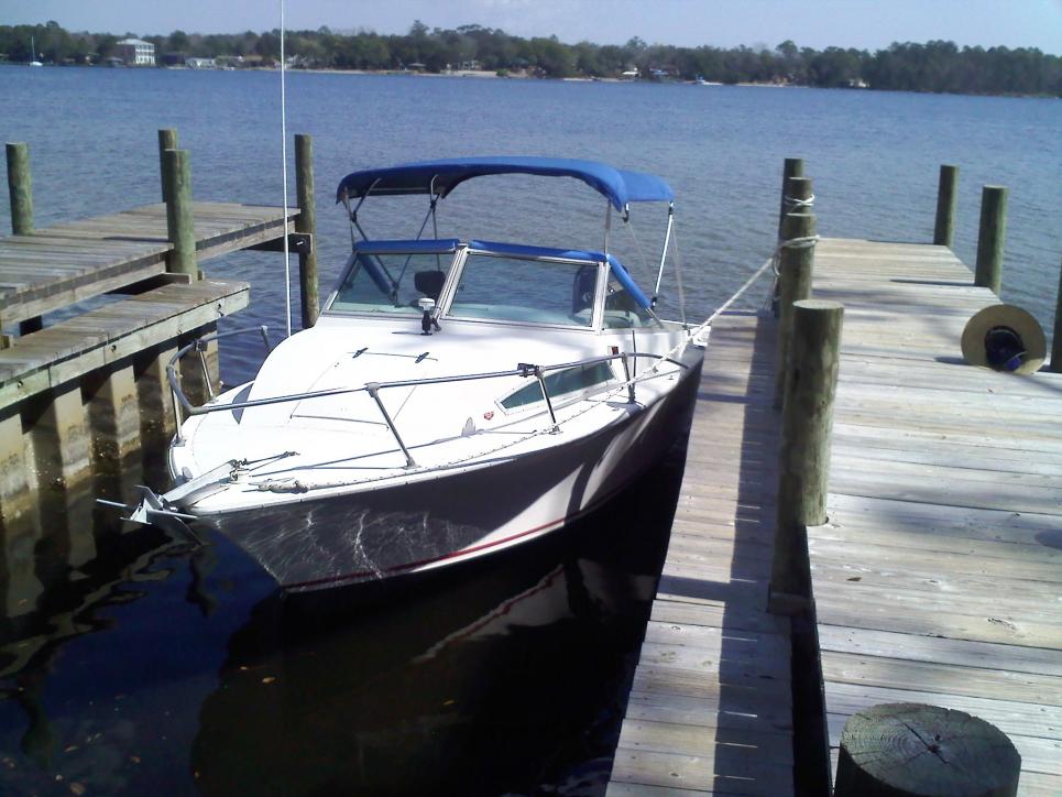

This worked ok for a lot of years but I would still rather have an uncluttered foredeck with an easy to access anchor... I came up with some alternate designs for it but nothing that is worth building yet.
Yeah - I know its pretty dirty but I'm not worrying about that til the transom and decks are finished.
