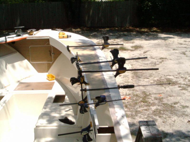

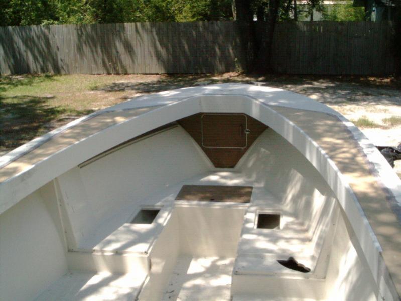

try and make your cap follow the lines of the front deck where your toes meet the inliner,you want to be able to stand straight up against the bolster. you need to mark a line 3 or 4'' behind the front bulkhead across the top of the cap. maybe 8''on both sides of your center line

Thanks for the pointer Kneedeep. I get what you are saying, I definitely want to be able to lean against the rail, makes for a much safer feeling boat. Did you router the edge of the PVC board? What kind of release agent did you use? The stuff they sell up here isn't completely smooth.

yes,i think i used a 1/2''roundover bit on the inside edge. used a mold release wax/paste. you could use plywood or mdf with formica for a one off mold. the pvc board i had was smooth on one side wood grain on the other. as far as the i/o goes i can't help you that was the first thing i got reed of. outboards for me. in my boat the motor mount for the i/o was about 4-5 2x6 stack on each other then glassed in. seems to me your giving up a lot of space with a i/o cover,leaning post and a cc. or are you going with a pilot house?
