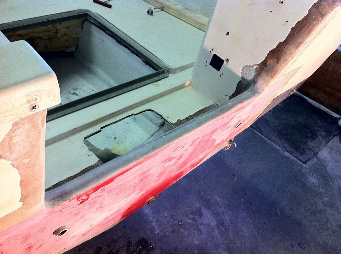

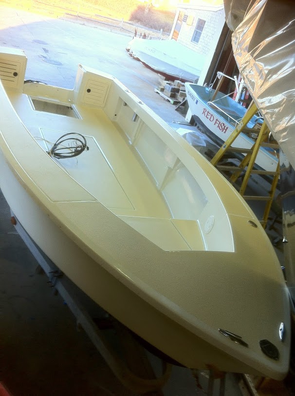

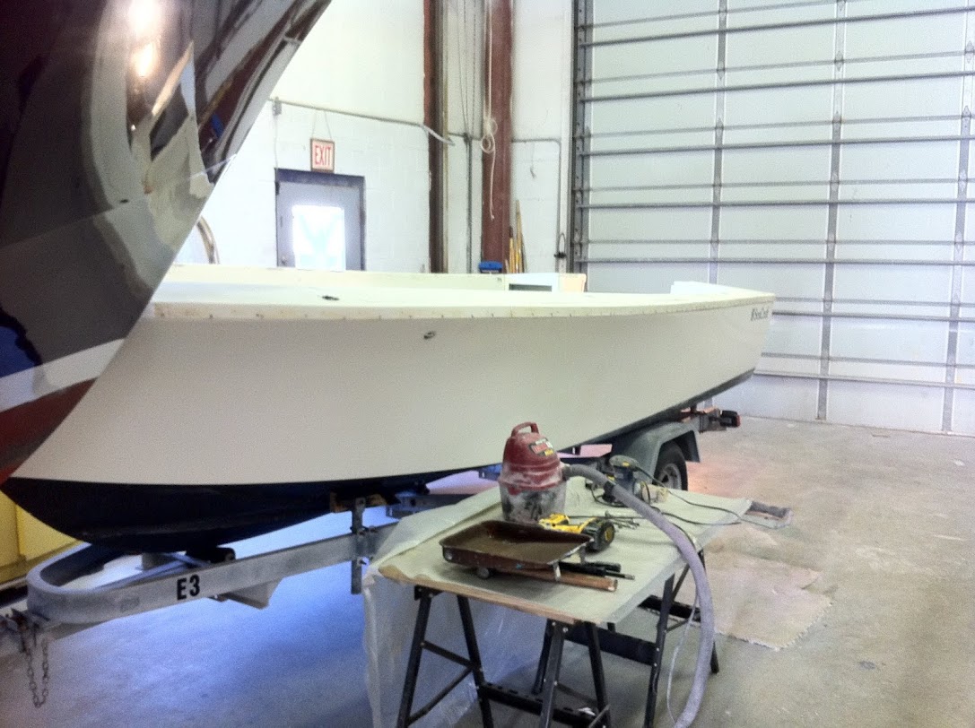

Just a quickie update. Haven't been very good about keeping up with taking pictures etc. The last of the bunch below are with my dusty, dirty iphone, so no, you're not going blind.
Here's my 18SF after a winter at the boatyard.
Partially new transom (long story), new paint on the cap and the inner liner and deck, new kiwigrip non-skid, re-cored the hatches.
New starboard and plastic hatches on the anchor locker etc.
New Moeller 40 Gallon plastic fuel tank, lines and fill. New fuel tank hatch lid. New (to me) 1998 Merc 115, lights, cleats, etc. etc.
So far so good!
Too bad the console and the t-top are left to languish in the dust.
At least they get to hang out under a million dollar Morris, and next to a million dollar Hinckley. Good company!
They're up next on the block anyway...
Here are some pics for you guys to chew on.
Zachary

looks good what did you do for the nonskid?
82 seacraft 20SF
Bayview Canvas
Old 03-28-2013, 07:30 AM
erebus erebus is offline
Join Date: May 2012
Location: Cape Cod
Posts: 428
The non-skid is Kiwi-Grip in a custom color that my wife picked out.
Kind of a dusky gray beige. Looks yellow under the fluorescents in the iphone pic. Not as yellow in person.
Kiwi-Grip is on top of 3 coats of signature paint in Awlgrip "eggshell" color which is a 99.99% match for the 1975 Seacraft gelcoat color.
Next year if my right rotator cuff has healed up from all the sanding this winter, I might tackle the hull.
For now all she gets is compound and wax (left handed).
Zachary
