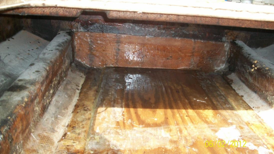

Just an idea. There is a whole bunch of space forward of the forrward tank bulkhead. You could put 30-40 gallons there, probably more and the boat likes weight forward.

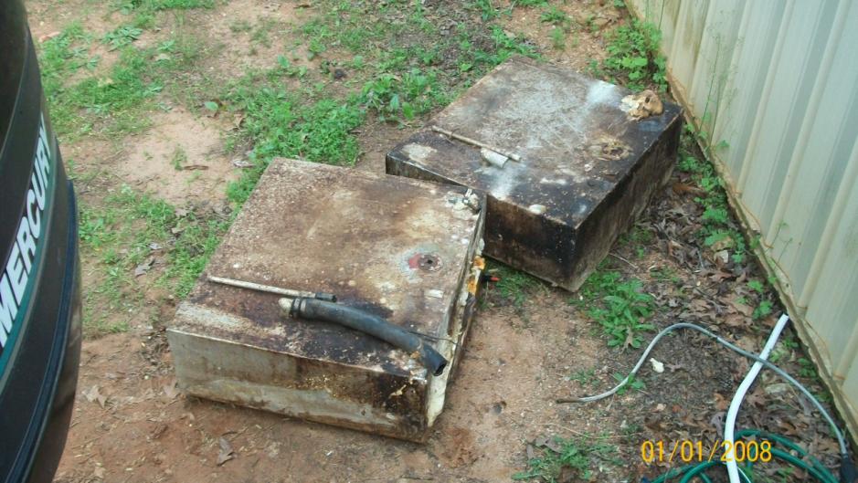

too tall I believe, I have one of My old tanks out I can measure, Ill go by and post the dimensions later today. Its shaped similar to this tank with the beveled corners on the bottom , both tanks had corroded completly through half way up the sides where the wet foam was , heres a photo of how bad mine looked,

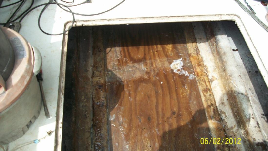

I had a friend measure mine at the shop, he said they are 34x29x 12.5 tall not counting the filler neck on the top, so 15.5 with the fittings .Mine were foamed in with about an inch if foam between them and on eiher end. The floor under them was flat with the top of the stringers, and thats how I rebuilt it. those look like they are very close to fitting!! Im gonna go by the boat today and do some measureing to see.

If you want to pursue the forward tank idea, look at the pics posted by Blue Heron, Strick and me to get an idea of the space available. I think you would need to do it as a two tank side by side install because of the width of the access.
