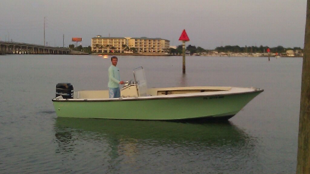

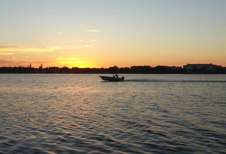

Lol, florida sleeper, that's awesome. I dont think it is, the serial numbers say its a 115. I have no trim tabs on my boat, and it's about even with the keel. I might even be able to mount it one notch higher. I can tell you that offers a hell of alot of both bow, and stern lift. It shoots a nice tail when hooked up. I have some pictures of me doing so too. It hauls the mail for sure.
The first picture is before I swapped out the motor. the blue band was an '83, and I was getting identical #'s as McGillicudy
Second picture is me testing the 21' Laser ii with the '86 115.

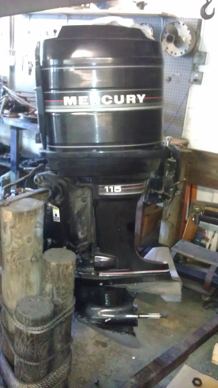

Last picture is the motor I currently have. I am NOT running the Doelfin

Looking super light. And fast! Better get yourself together, er, I mean, better get yourself a tether... Still got me wonderin' where you're getting the extra 10 mph...

Can you post a couple of pictures of the carburetor setup you have on that 115?
I'd be interested in seeing if the carbs are WMK 14's off a 140/150 I6 Merc. It may well be that you've got the 140 powerhead "Florida Sleeper". I've done that trick twice.
I used to run an '83 140 powerhead on an '81 115 mid-section. I used all the externals from the 115, as it was on the back of a 15' Cacci Craft copy of the V-Mate, and the boat was labeled "Max HP: 115".
I could just touch 85 mph with a 2-blade 32" pitch over-hub solid brass prop at about 6300 rpms. I'll never forget the day it threw the #2 rod out the front of the motor and right through the center of the dash. I think it was several minutes before I really comprehended what had almost happened.
