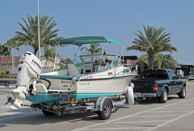

I figure my Seafari weighs about 3200 lbs with a full load of gas, but I carry about another 600 lbs of gear when I go cruising, and the big EZ-Loader trailer weighs 900 lbs, so I figure I'm towing about 4700 lbs when I head out to the Keys or some other trip around the state. Will e-mail you a spreadsheet from when I once weighed all the gear on the boat . . . it really adds up!
What sort of tow vehicle you can get by with depends on where and how far you want to tow it. I originally towed my Seafari for about 5 years with my old '66 'Cuda with a 340 cube V-8 & HD Torqueflite, mostly just to the North Palm, LP, and Jupiter ramps, never over about 45 mph. At 3100 lbs with a Sure-Grip rear, air shocks, wide tires, and roller trailer that I didn't have to dunk, it did ok, although the east Jupiter ramp was a little tricky at low tide, and I ALWAYS (and still do) chocked all 4 wheels when cranking boat up on trailer! I had to go real easy on the throttle pulling out or it'd smoke the tires! I even towed my previous 18' boat down to Islamorada one time with that rig and no trailer brakes, but I was young and dumb then!
Towed my Seafari for another 19 years (I buy a new vehicle about every 20 years, whether I need it or not!) with a 79 Chrysler wagon that weighed about 3800 lbs. With Sure-Grip rear, air shocks and a 360 V-8 it handled the boat fine at all the local ramps, but I never towed it any distance. In 1998 I ordered a 2WD Dodge Dakota Club Cab with Sure Grip, 5.2L V-8, HD towing/cooling/electrical packages. It's been a great rig and I've towed the boat all over the state with it. Even towed Skip & Carla's old 21' race boat down to the Keys with half their garage piled in it when they moved! With a long 131" wheelbase, front and rear sway bars, and 10" wide 60 series tires, it's very stable towing the boat, even in cross winds at 65 mph. I've yet to have a problem pulling up a ramp, even on the steep Jupiter ramp at low tide.
That FWD SUV still probably weighs more than my 'Cuda, so it might work for local towing, but you might want to look at putting a hitch on the front, where the trailer tongue weight would provide a little more traction on steep ramps. However, if you want to tow it in heavy traffic down the Turnpike to Keys, I'd use the F250 and make sure the trailer brakes are working!
